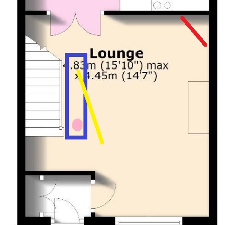

LG48C2 (2022 model) - I cannot seem to get my head around this, I have my TV on a stand in the corner of the living room. I sit on the couch opposite the TV, but when listening to music or films/TV programs, there seems to be a certain distance between the TV and the couch that the bass just stops. If I lean my head forwards, towards the TV about 18", I can hear the bass nice and responsive, but if I lean back, it kind of disappears. I have made a diagram, with the TV in red, the couch in blue, my head in pink and the kind of bass wall in yellow. Can anyone advise any settings to help make the bass travel further?
Ideally I don't want to piss the neighbours off by just cranking it up (I actually don't know if that is available). I have it set on stand, not wall mounted in the settings already.

Ahhhhh, so I'm w**k at physics, but does that suggest the stairwell behind my head is reflecting back the waves, causing it to cancel out the ones coming towards me?
Different frequencies have different wavelengths (but you know that already).
What's probably happening is that certain low freqs (which have longer waves) are a perfect match for the length of the room, causing the standing wave. Either a full / half / quarter etc of lets say 100Hz fills that space and thats why you can put your head in the peak and hear the frequency, and move it away into the dip of the wave and not hear it.
Suggest you move the TV 18" forward or, maybe even 6" and see how you get on. Is the sound bar designed to be used in a corner !?

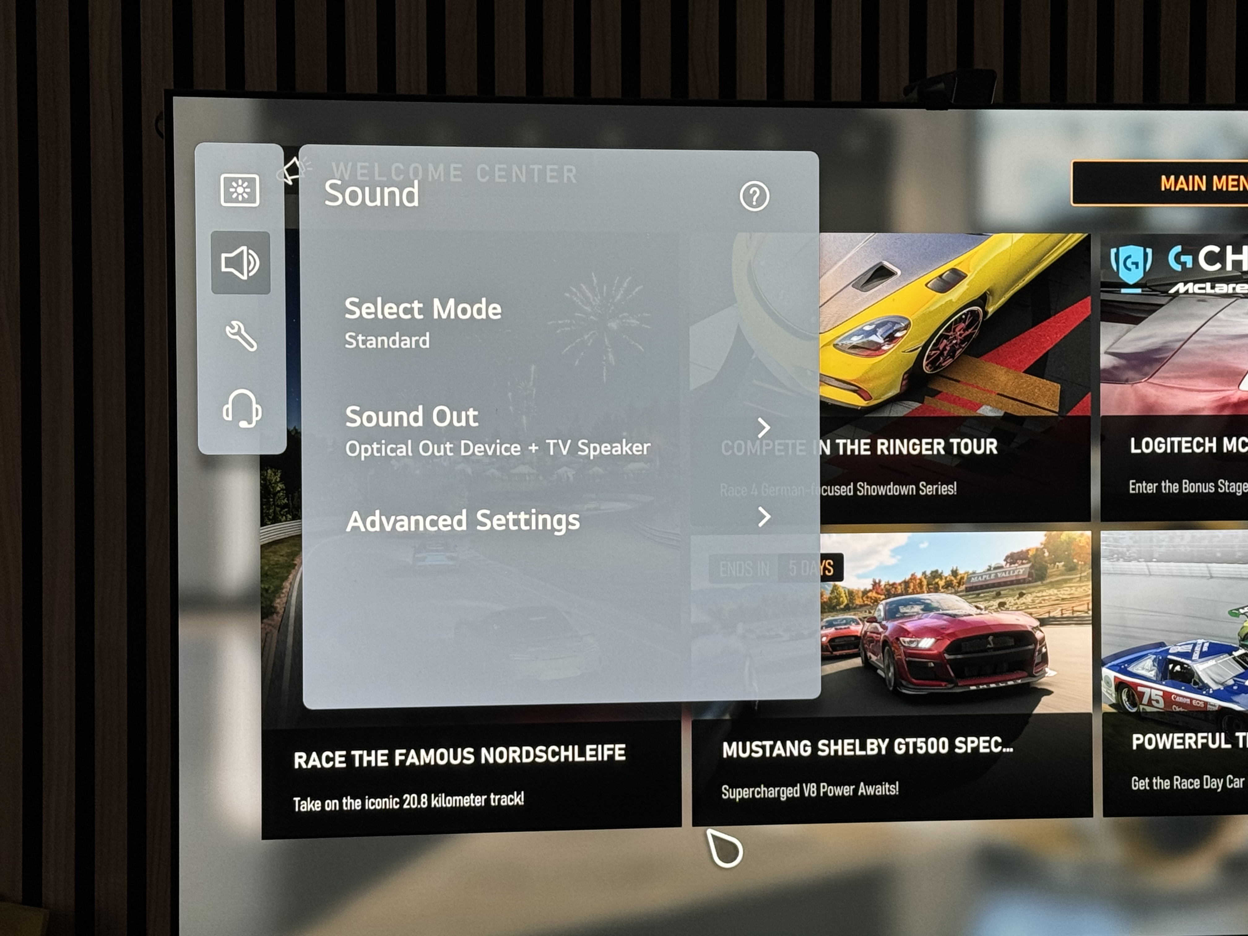

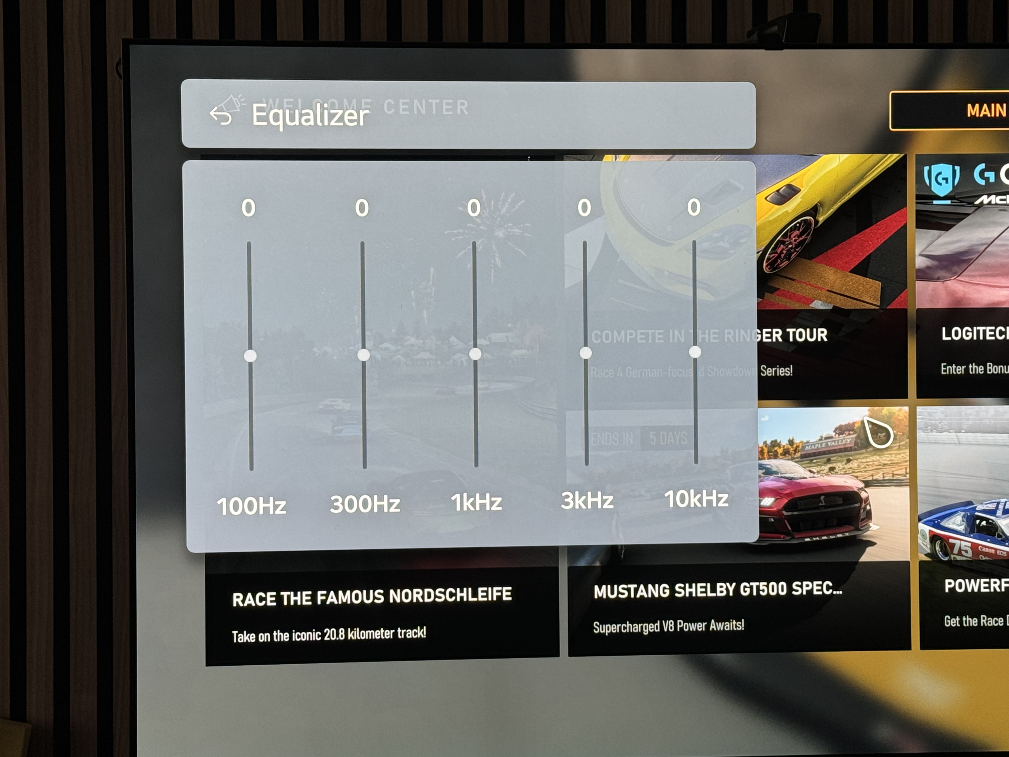

I wonder if there's some way of accessing the EQ settings to maybe add a few dB on like you say 100hz, see if it moved the wave forwards to my liking.

Yeah you really suck at physics.

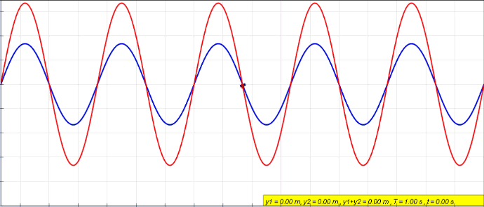

100hz will always be the same wave length (~3.43m) in the same location.. moving the source or the reflection pane are your only options.

I'd prefer the TV speakers, which are really quite good for an OLED panel, to hit the perfect sound where I sit, rather than having to lean forward for the best experience, hence asking if there's a setting I can adjust to move the, what I now know, to be a standing wave.
