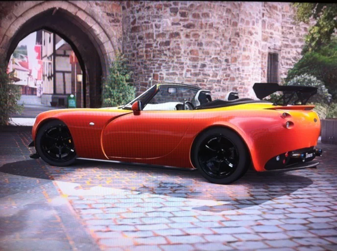

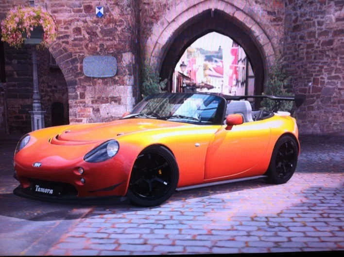

Forgot to say those pics were via Gran Turismo, little update, insurance is now sorted, cheaper than I expected £650 fully comp for a 22yr old. car is going in for it's mot today, it's not going to pass cause it has no cat on it, just want a list of things that need doing. Had a check myself and the passenger side track rod end seems worn but apart from that and the decat should all be good. also ordering my go pro in the next few weeks so can get some decent videos up soon.
