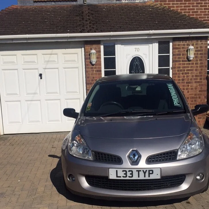

Travelled to Swansea from South London and drove it back the next day. (These pictures were taken a few weeks after owning the car hence my plates being on there, roof wrap and rear tints!)

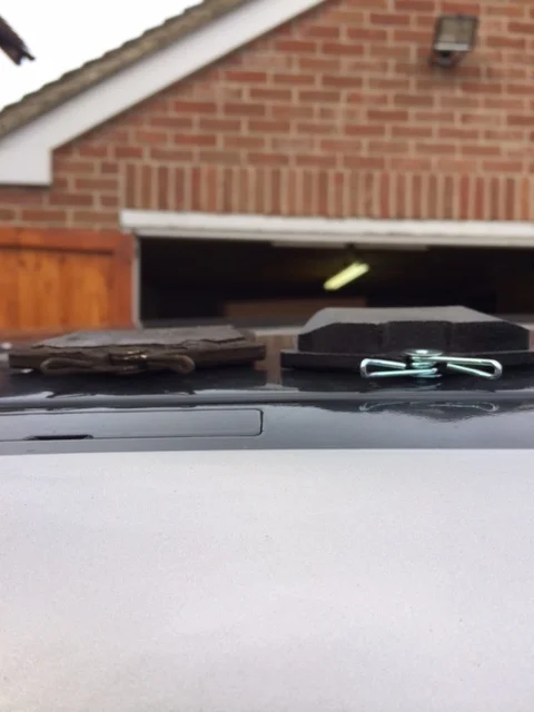

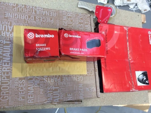

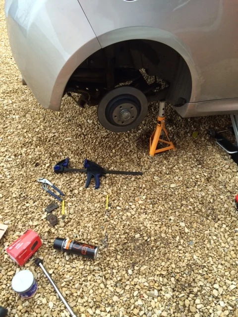

The first thing I did when I got it back to London was a full break refresh including discs, pads and ATE superblue fluid courtesy of @George@RTR_Parts ! I could tell they were knackered so once the order arrived, I popped over to @Cub. mansion and we set about doing them.

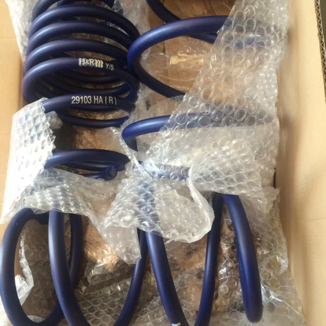

Shortly after doing the brakes, I really hated the ride height on the standard springs so replaced the springs all round for the H&R's with a 40% and 30% drop, it would benefit from spaces but this is something I've never bothered with at the minute.
Fitted them as soon as they arrived.
When I came to remove the old springs, I'd noticed the O/S front spring had collapsed completely and this is the remains..

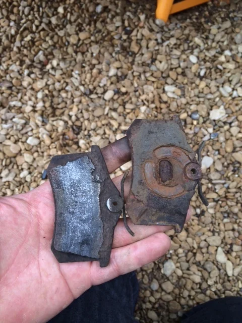

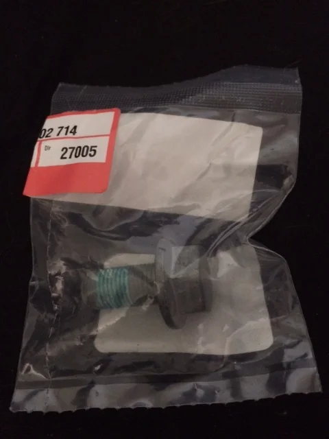

Literally a few days after this I was driving along when I felt a really horrible drag and a loud grinding sound on the way back from the gym. Upon inspection it seems that the bolt holding the O/S rear brake carrier had snapped causing the caliper to spring forward and grind across the top of the disc. All I could do was cable tie it so I could get home but unfortunately this lasted all of 5 minutes before the heat melted the cable tie off!
I spoke to a Renault main dealer who said they won't sell the bolt individually and said the only way would be to buy the complete hub (!?).. so a call to Renault Wolverhampton was made and I managed to get the bolt for £7 posted!
Job jobbed, that was that issue sorted.

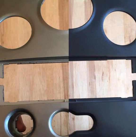

Next on my list was to sort out the trim and the centre console as I hated the factory silver it came on. Sanded down with wet & dry, primed with 2 coats and then sprayed in a satin black. Looked much nicer in my opinion.

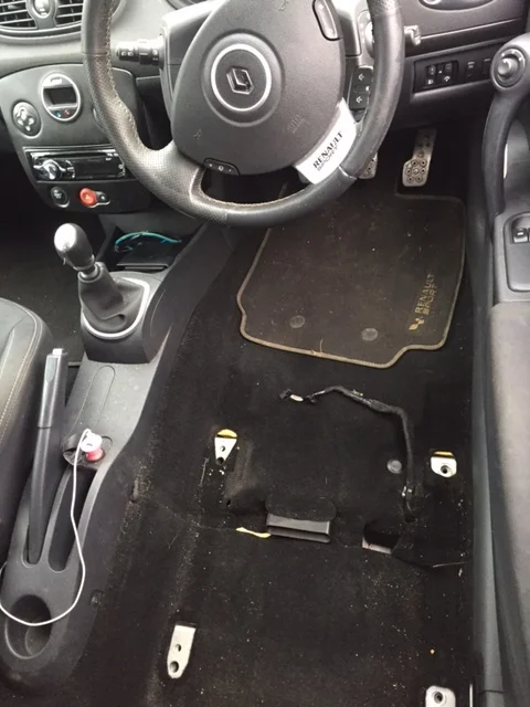

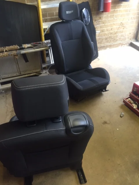

My next mission was to replace the seats due to bolster wear. I have always preferred the factory seats so managed to pick up a good condition set from @welshname / @TheEvilGiraffe !
Once I had the old seats out.. it was best to clean it!

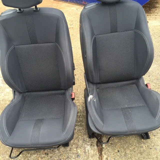

And then this is an old vs new seat comparison:

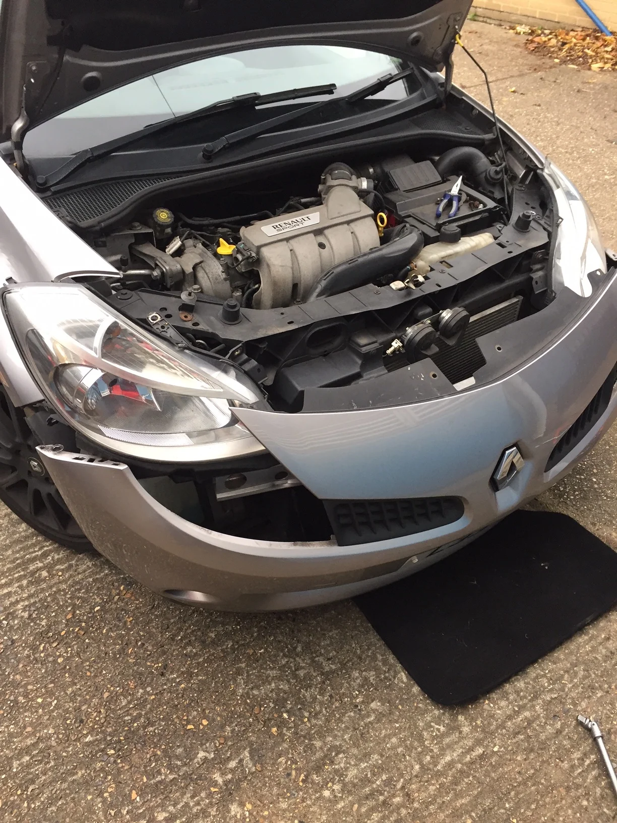

Next up was LED headlights which as we all know is a bumper off job on the MK3's unless you have hands like an 8 year old.

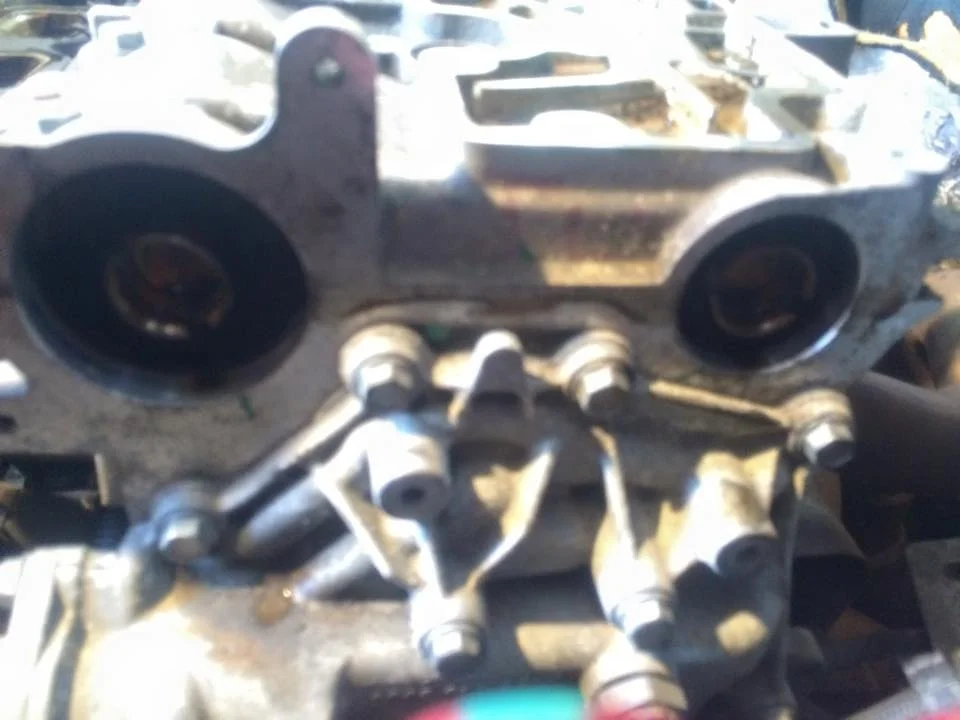

I rung Mike Woodford who is a good friend of mine outside the Renault scene and he popped down and noticed a pulley bolt was only finger tight causing the cambelt to slip and the engine destruct.
I drove it in that morning but it left like this:
We took it straight to Woodys workshop where we set about a top engine rebuild.
This included:

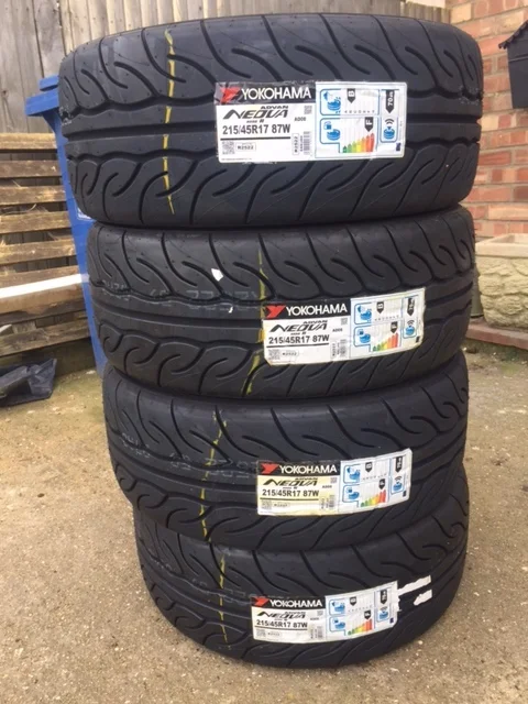

The same day I decided to get a set of 4 new tyres:

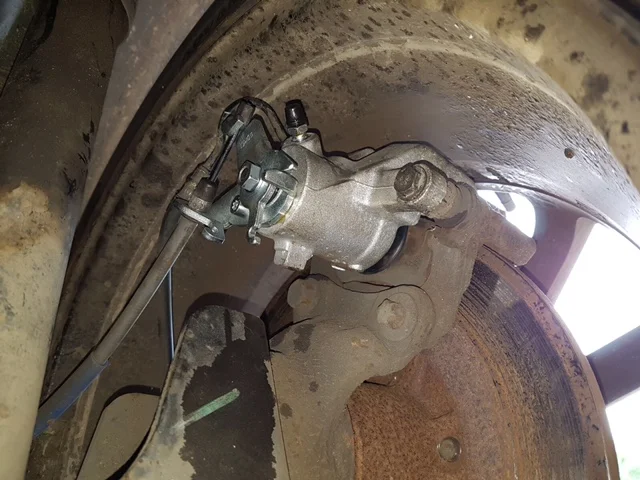

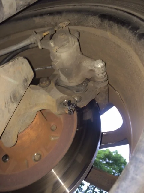

I'm still to do the lower ball joint (which is common as muck to go on these) and look in to the handbrake not being effective but upon checking the actual cables and the tension in them, I believe this is actually the rear caliper having seized up.

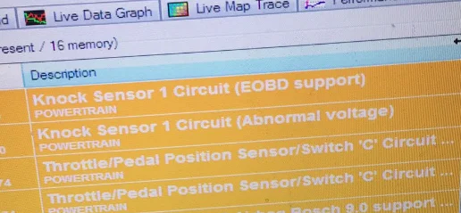

The car currently gets a spontaneous injection failure which will put the car in to limp mode so I checked some fault codes through RSTuner and it led to this:
New knock sensor has been ordered to be fitted, fingers crossed that solves that issue.

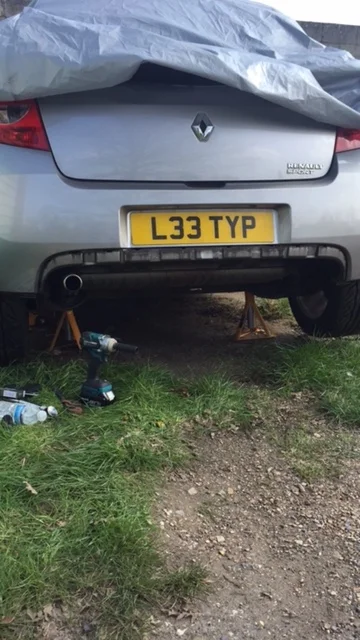

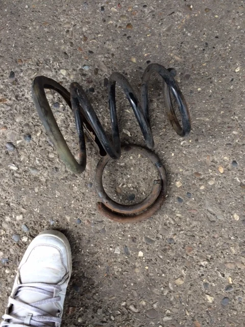

Before:
After: (Only photo I have to hand)

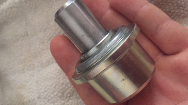

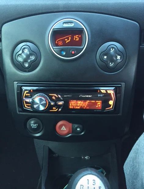

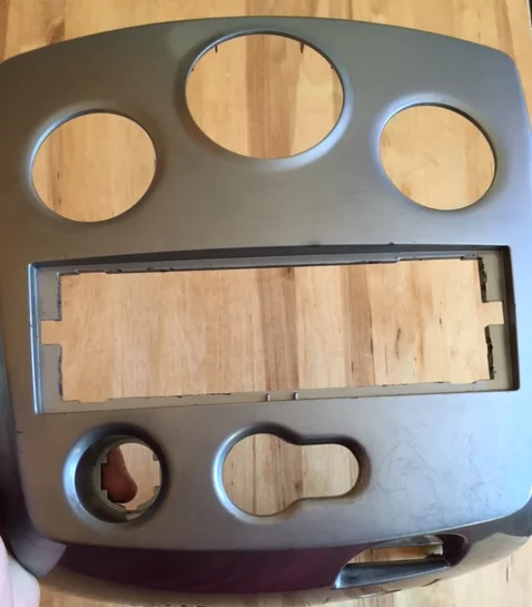

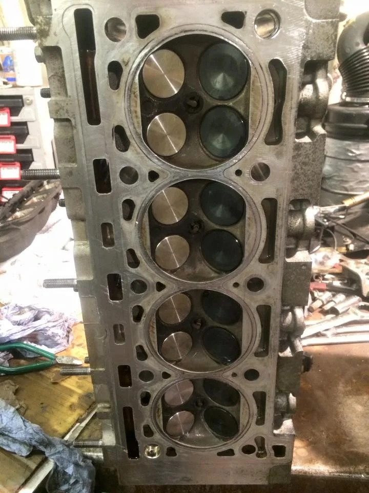

I just enjoyed it for what it was for about 3/4 weeks and then decided to go to a Renault main dealer for a service and was phoned up about 6 hours later to say the car was done and ready to collect so I got a lift.
As I arrived I saw the valet going moving it to a dry area (after a courtesy clean I asked them not to do).
Once I was in reception the service manager told me unfortunately the car is no longer starting and there seems to be no compression in the engine.
(I won't go in to the legalities, had my legal team on them, didn't work, they offered a free service next time.)
This included:
- Supertec valves
- Genuine cambelt kit
- Genuine aux kit
- Genuine headgasket set
- Genuine headbolts
- 5/40 Elf oil
- Genuine oil filter
- Type D coolant
Unfortunately, that's where the story ended for a while. It had caused me that much of a headache that I completely fell out of love with the car and it spent its next 8 months under a cover not being used (occasionally coming out to jump start my van which I was using as my daily as the starter motor had gone on it and I couldn't be bothered to replace it!)

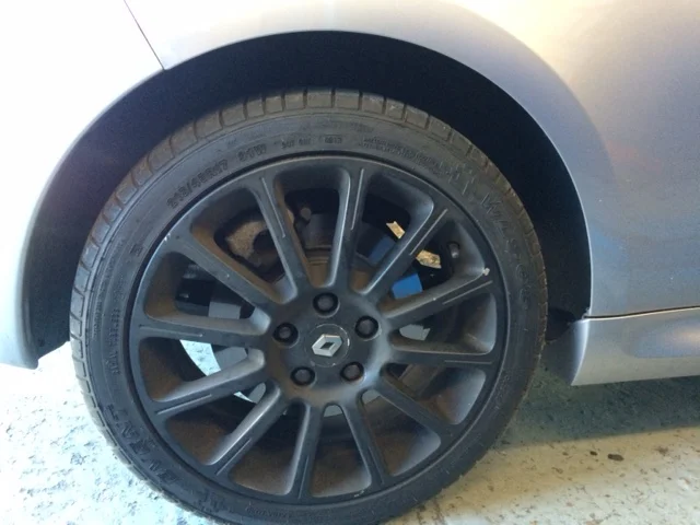

Firstly, I took it for an MOT on which it failed.
Reason for failure: 3/4 tyres were under legal requirement, seatbelt wasn't locking, one ball joint was warn and the handbrake wasn't effective enough.
I then sorted the seatbelt mechanism with a little bit of WD40 and that was all it took

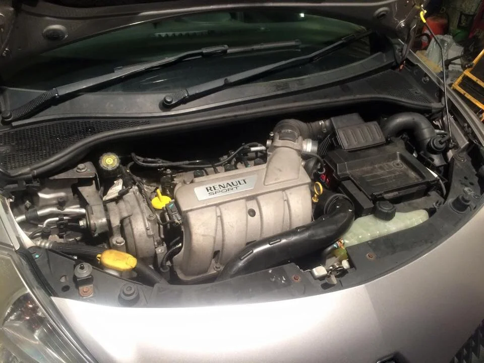

This is how the car is sitting at present:
