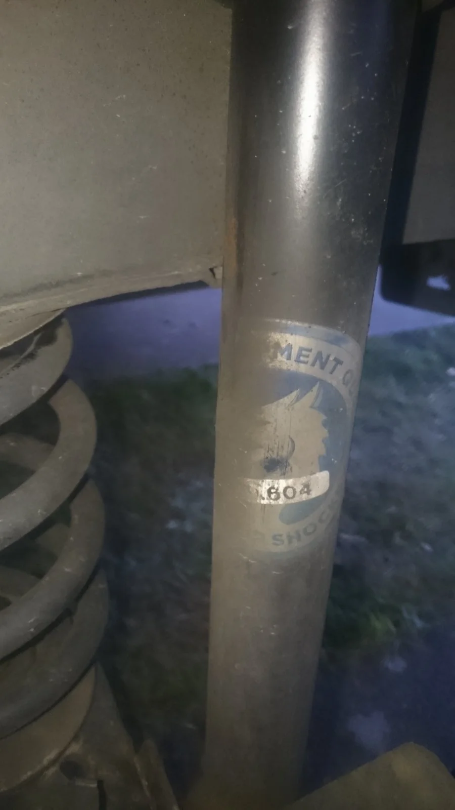

I've been looking at the rear dampers and think it might be worth replacing them with cup dampers...

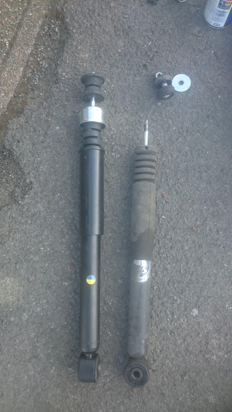

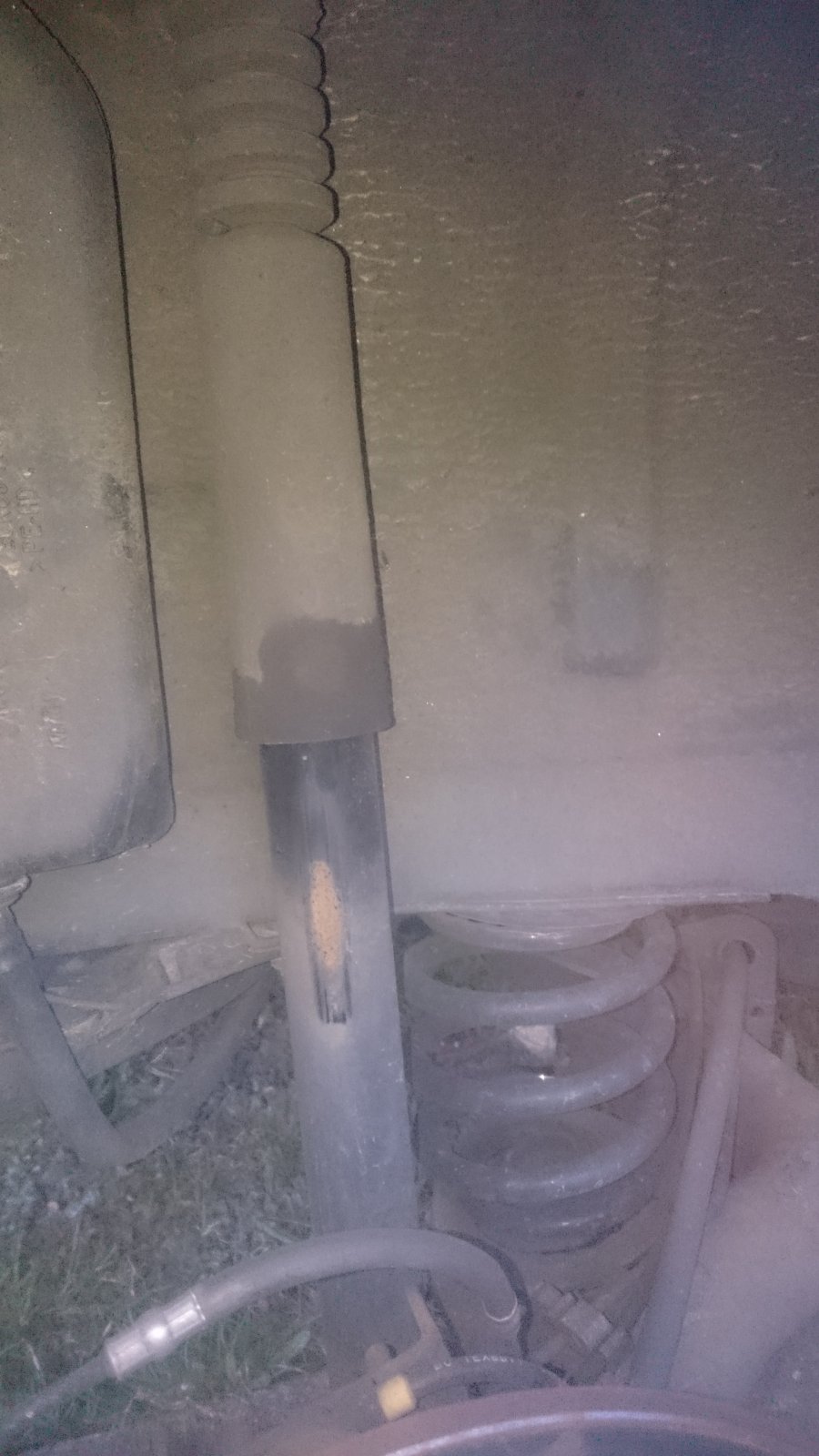

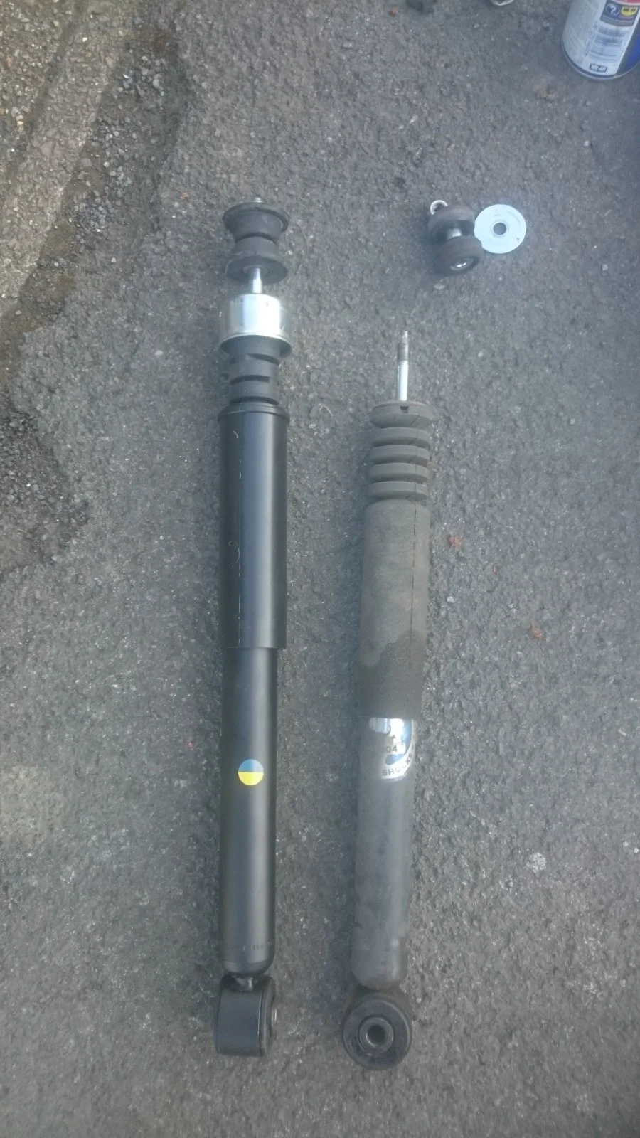

Just to keep the thread updated, I've changed the rear dampers and it turns out that they were both pattern parts and both knackered... I replaced them with OEM cup shocks and hoping this improves things, I'll see if it helps on track along with a higher starting pressure and see how I get on before deciding on the rear arb.

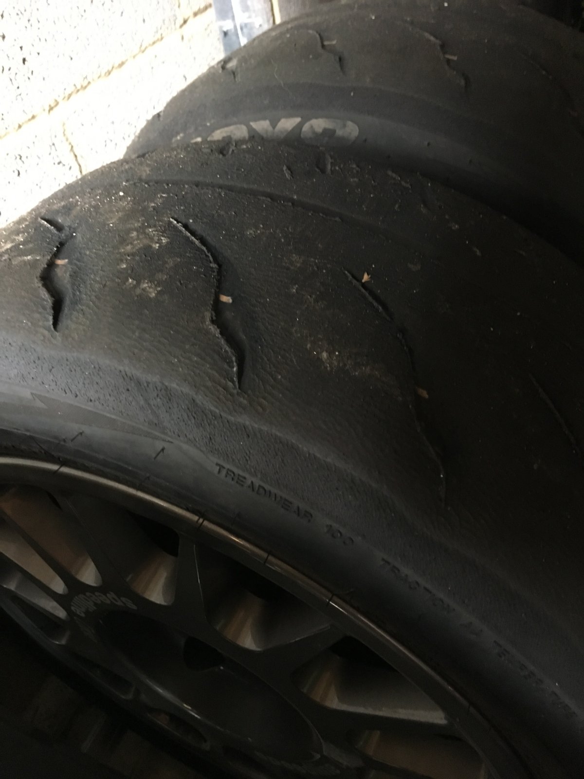

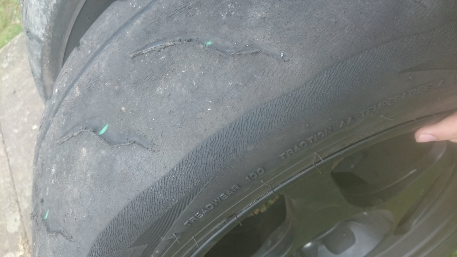

I'm running R888R's on a set of 15's on my 182 with standard cup suspension. During a track day on Friday, I noticed that I seem to be wearing the sidewall slightly. I run the tyres at 30psi hot so I don't think it's because the pressure is too low?
I'm wondering whether it's because the standard cup suspension is too soft for the tyres and whether something stiffer might help? I don't care about 'lows' and don't want a cheap nasty set of coilovers so I'm looking at the Cooksport springs, do you think a set of these would help?
Looking at this pic I'd say that your tyre wear problem is entirely down to soft suspension and too much body roll.
Sorry I can't recommend a cheap fix but I think you're going to end up chasing your tail if you try anything other than stiffer springs & dampers. Maybe a rear ARB will be your cheapest option, but if you like the handling of your car as it is then I'd avoid that as it'll change it noticeably.
ETA: Stiffer springs will of course change the handling too, but if you buy them as a full car set they'll generally provide a more balanced increase in stiffness than adding an ARB will.
