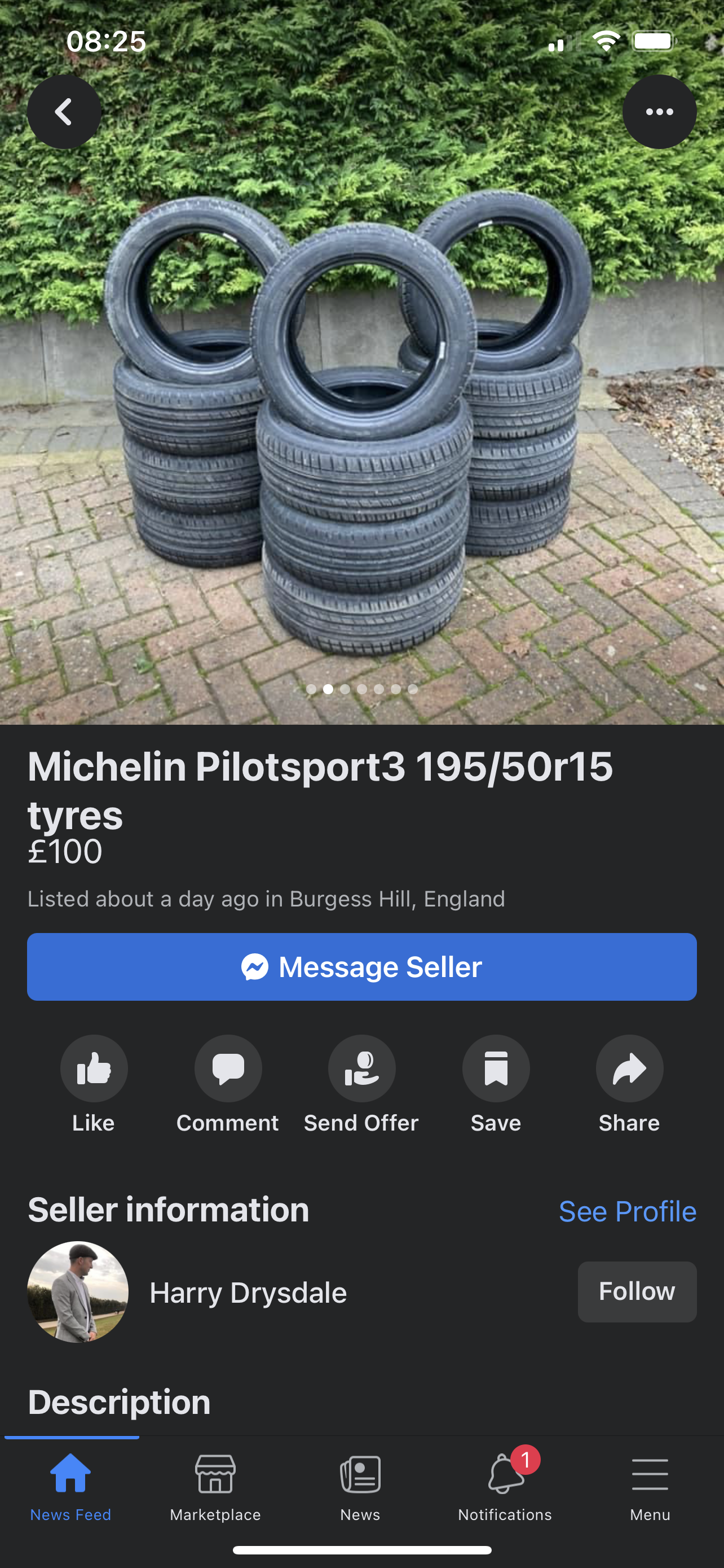

And… there’s a guy on eBay that sells a set of 4 PS3’s, hardly used, for £80-100.
bargain!

This is the guy I mentioned.
