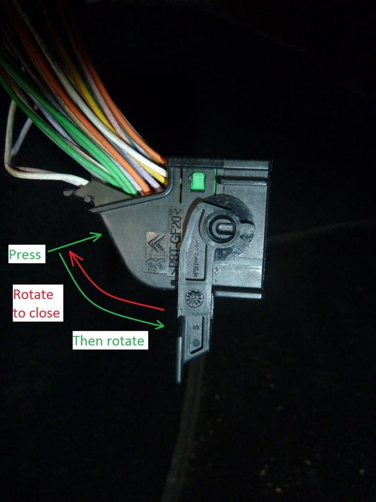

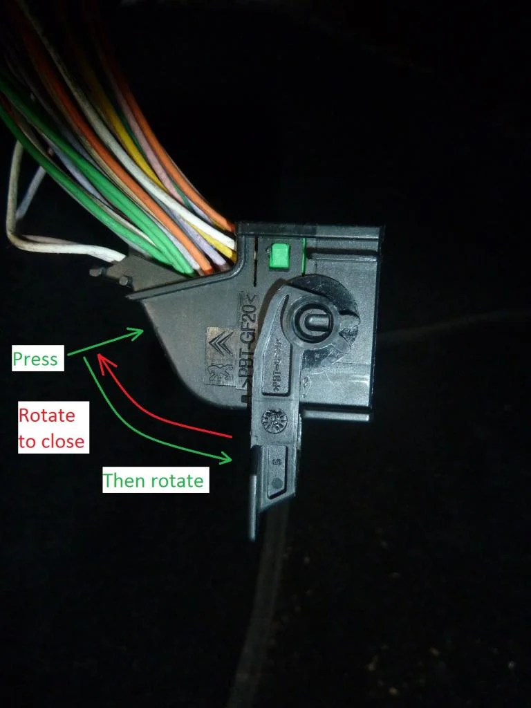

When I got the 1.6 16v and went to pick it up, there was an odd issue with the UCH relays clicking away and the lights flashing, windows juddering, wipers juddering (electrically) etc. After some research, I decided on balance to buy the car anyway but got a suitable discount to cover a secondhand UCH / ECU setup.
When I got the car home, I started to look in to the issue and do some investigation, as the fact that it affected the complete UCH range of operation indicated to me that it may be an intermittent power or earthing issue.
After some investigation, I found that if I pushed one of the plugs on the ratcheted connector in a certain direction, the problem went away, push it the other way, it came back... most odd. After pulling some pins out of the plug and finding nothing and inspecting the male plug pins, again nothing, I decided to clean the plugs... covered them in cleaning solution, mated and un-mated the plugs a few times and then left it to dry before putting it all back together.
Anyway, no more issues! I must conclude that there was some dirt or corrosion on the plug or pins and that this has been the cause of the issue. Looking through the history of the car, there's a receipt for £150 for the same investigation work some 2 years ago. Seems that in the 3 hours' work, they never thought to just clean it.
I've included a picture of the offending plug - it was the brown part (there's a brown and green part to the plug) and a picture of the UCH board from another thread - ignore the annotation - (it was the connector on the top right)

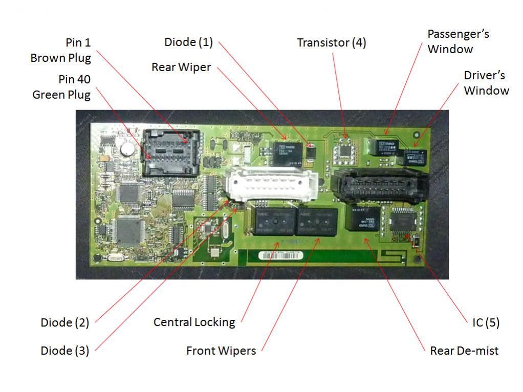

Seen it before. Usually the plug casing is worn so isn't a tight fit and cinnections move about
Re: UCH Clicking Relay - flashing lights - juddering wipers- juddering window - solv
When I took the pins out, the retaining clips did look to have been flattened, so I opened them out a bit but other than that, everything looked along the right lines...

I've done a shed load of investigation today into what's what on the board and connectors, so will add that when I get time.
I think it's oxidation on the connector causing an intermittent connection.

I've been working out what connects to what and what the relays on the board do.
As the problem affects multiple functions, I'd have to guess that it's a power or an earthing issue but assumptions are the mother of all f'ups... Investigation continues.

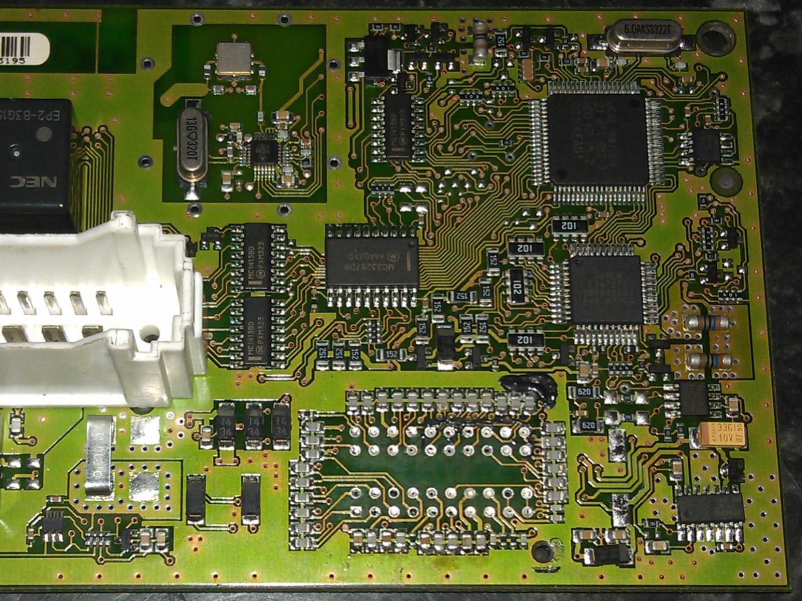

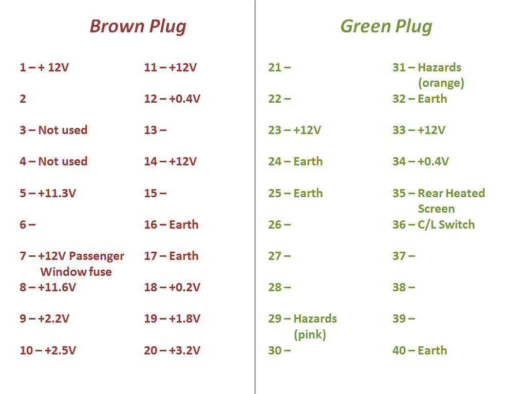

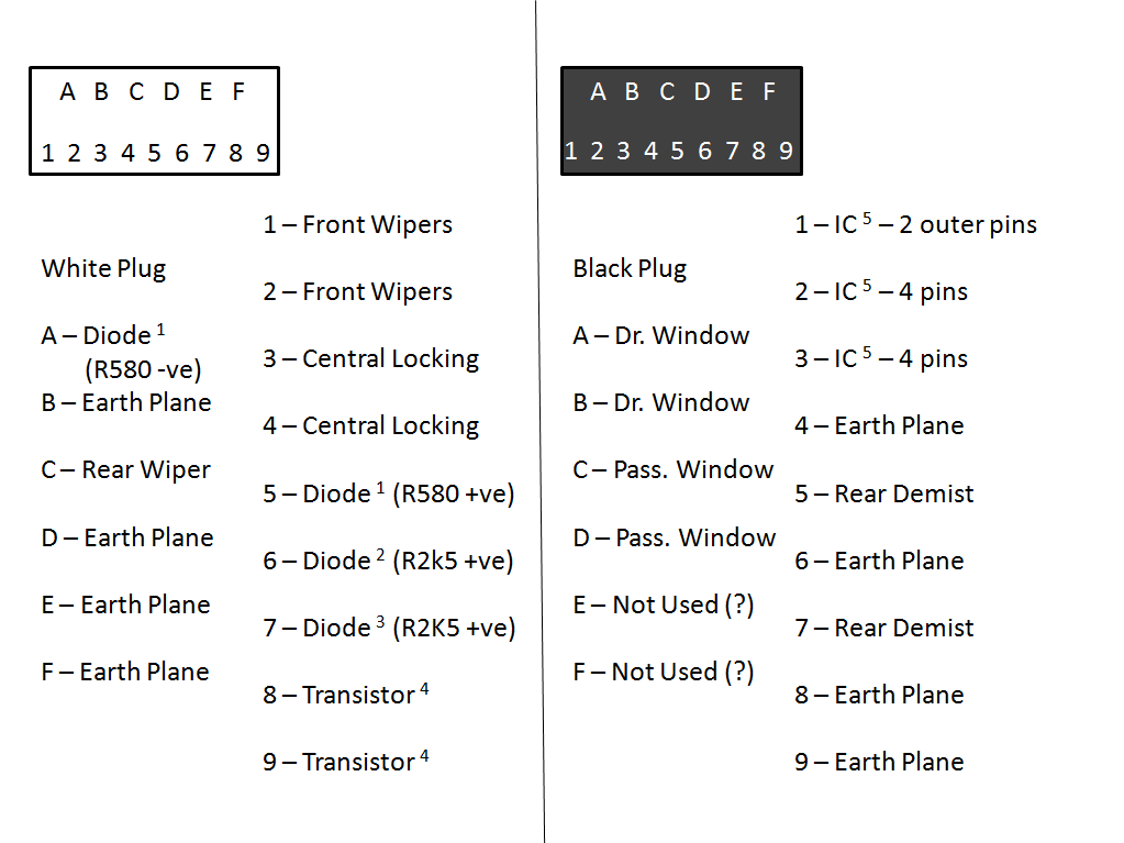

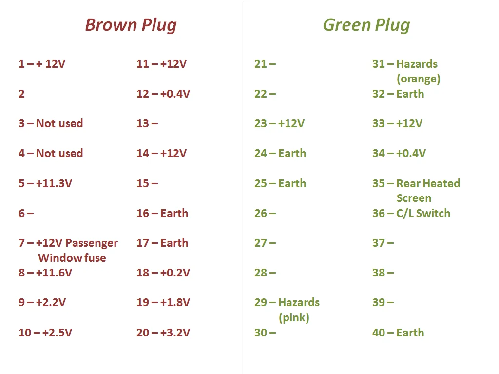

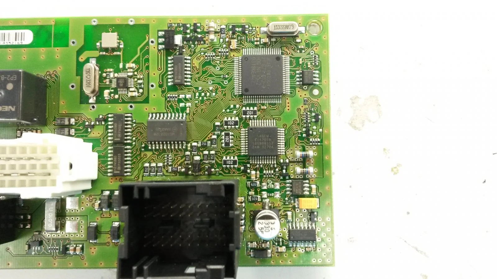

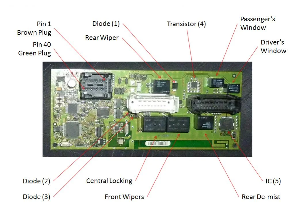

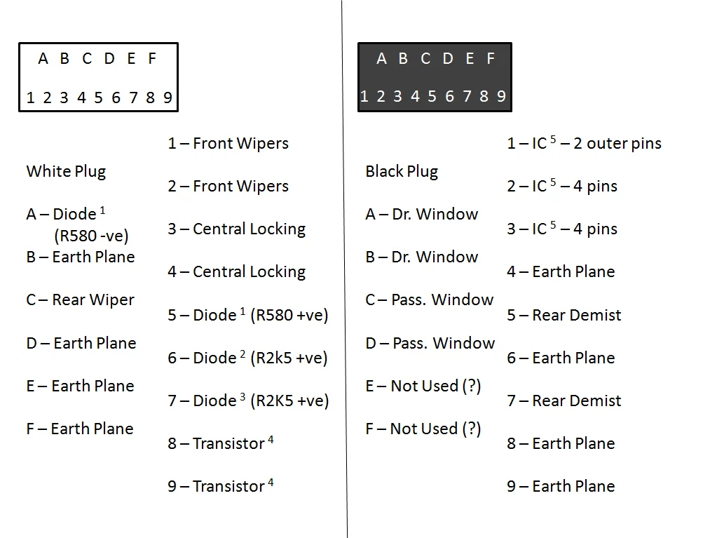

So, I did some more research in to the UCH functions. I need to do some more research, ideally with a spare wiring loom but for now, here's my findings:-
Looking down at the plug on the board:-
Looking down at the plugs on the board:-

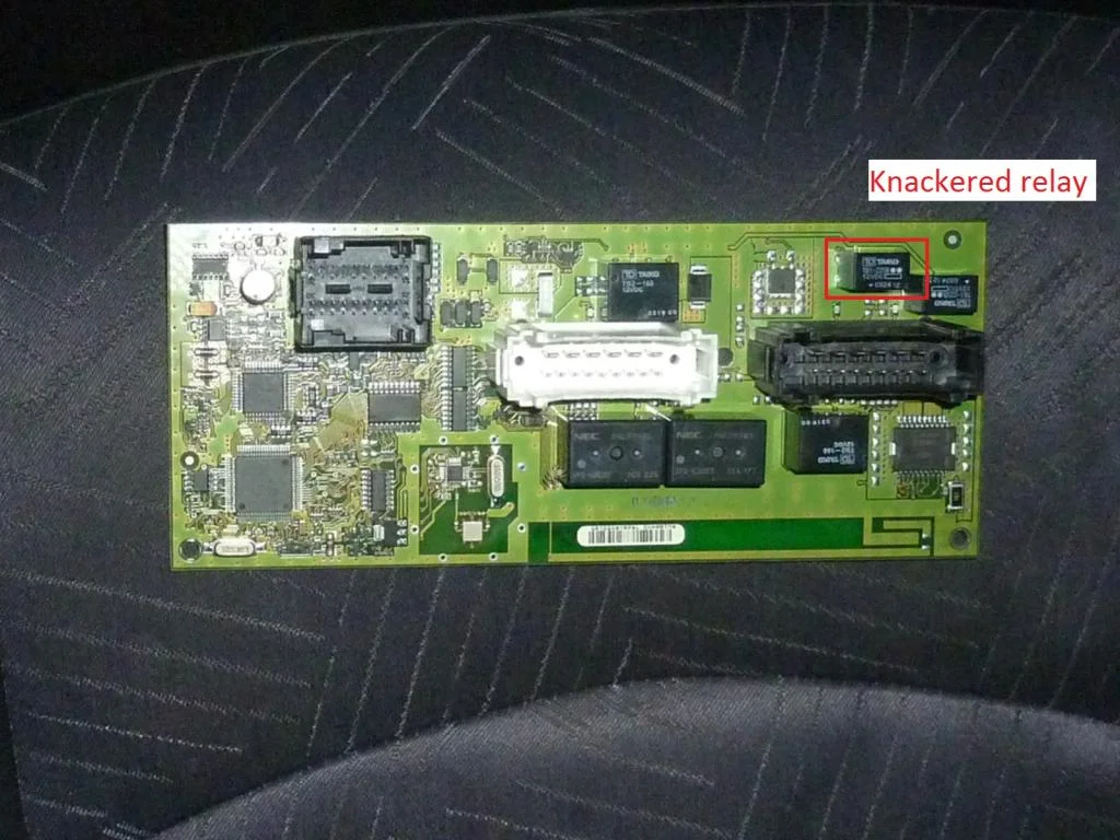

When I use my windows something clicks, like when the windows are up if I pull the switch up something will click every time I do it. Is this likely to be the uch?
Assuming everything is working correctly, the relay should click. If not then maybe a bit more explanation of the issue?
Everything works to my knowledge, so it must be the relay. Noisy fucker.

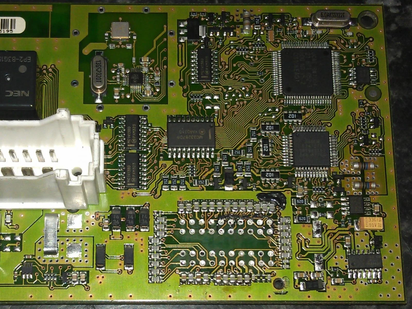

Update on this. After reading a lot of posts on here about UCH faults, problems with the decoupling capacitors came to my attention. The location of these and the way the fault presented itself all seemed to tie in, so I desoldered the 40 way connector and decided to sacrifice my faulty board by removing the caps from the board in the problem area (brow plug - pins 1-20). Anyway, it would appear that doing this has soled the issue. This points to these as the faulty components that were causing the chattering relays. Odd how wiggling and cleaning the connector solved the problem initially but then we are dealing with French electrics here...

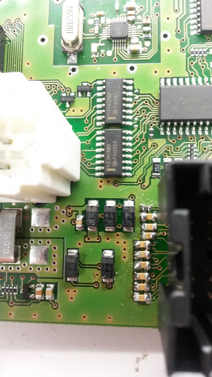

Here's a picture of what's underneath the black 4 pin connector. The components around the periphery are the decoupling caps. They are connected to the pins on the connector on one side of the capacitor and ground on the other. In my case, the caps at the lower edge of the connector / board were the problem area. One or more of these was defective.

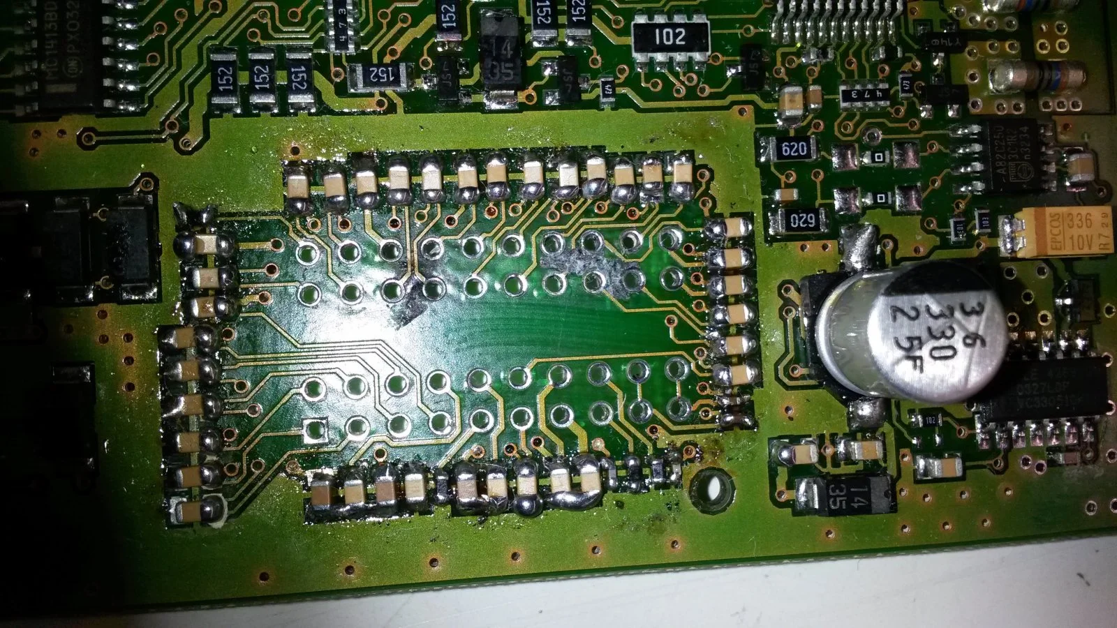

So I finally managed to get the connector off, and discovered that a couple of caps were actually loose (I picked them off the board with a pair of tweezers) so I reflowed them onto the board and put the connector back on. Everything has been working fine! Except...
Now the central locking is going crazy and continually locks and unlocks itself while I drive! After a couple of minutes the car starts to beep at me as well :\ Anyone had anything like that happen?

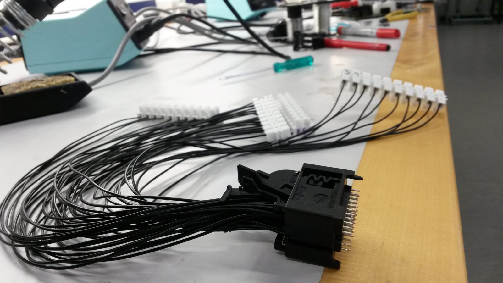

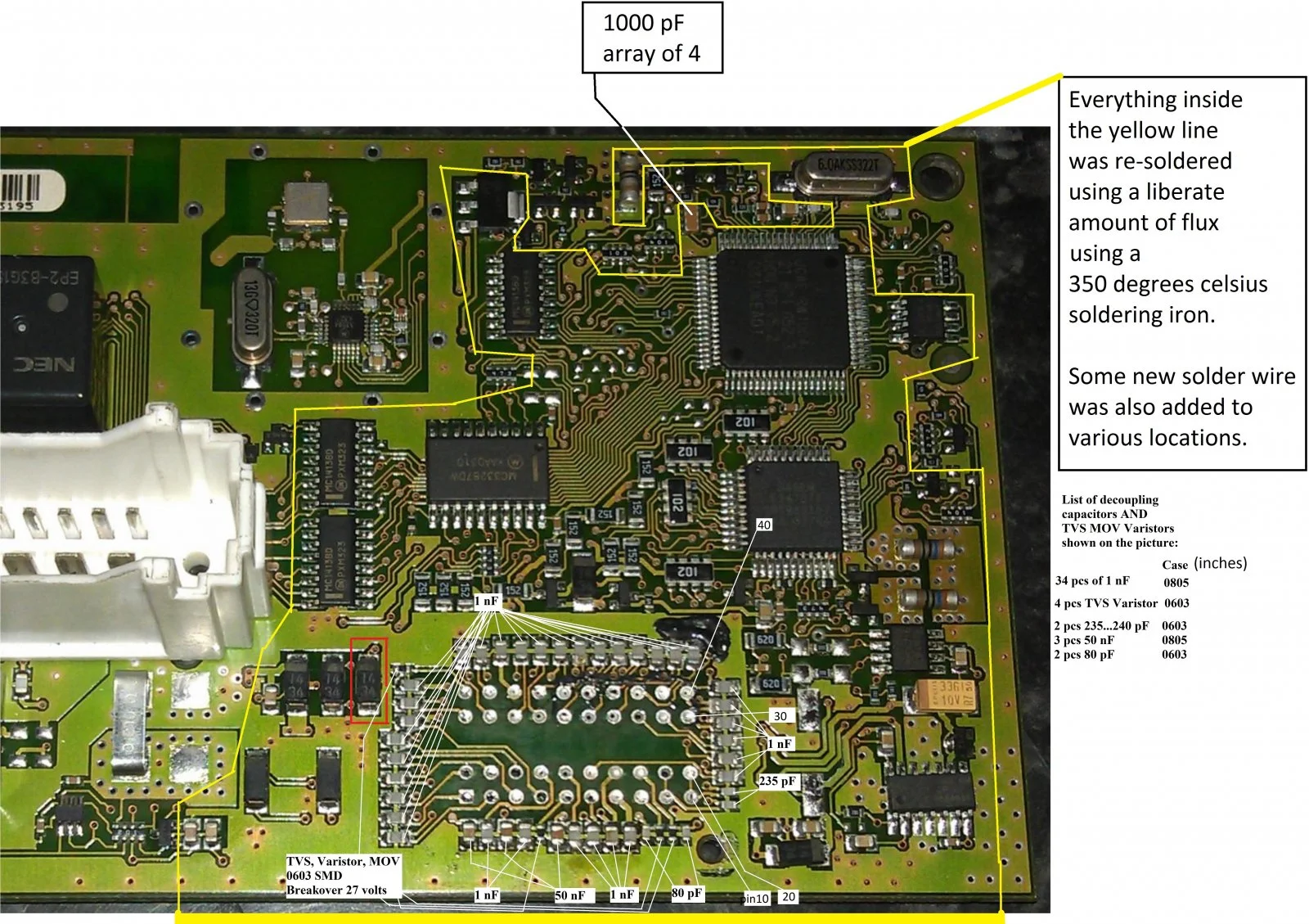

At first I was sure that the 40-pin connector was the culprit. Must be a bad contact. I removed the whole connector and substituted it with some new wire, which I soldered straight into the PCB (printed circuit board). To my surprise, this had absolutely no effect to the fault. So clearly it wasn't the 40-pin connector at all, that was causing the problems. At this point, grabbing the freshly installed set of wires and pulling/jerking/twisting them had the exact same effect as previously: fault goes on/off depending on how you twist them. What the heck? So it must be something related to the fiber glass of the PCB itself bending way or another.
At first I wanted to believe that the people on the internet know what they are talking. As in some thread there was this guy "bil_liser" saying, that ALL the UCH problems are caused by the decoupling capacitors. So I went and changed all the UCH capacitors around the 40-pin connector (although not all of them are capacitors, as you will see in the attached pictures in the end).
So, I had changed all the decoupling caps to fresh ones. Still, no effect. The fault remains exactly the same.
I did some more research on this topic online and read that BBA-Reman does a "full-rebuild" when the symptoms match what I was encountering. I don't know what a full-rebuild is but I started with trying to find out if there were replacements available for the main microprocessor. I didn't find even a datasheet for these poor buggers. So I concluded that BBA-Reman probably is not changing those either. Also, from my experience, ICs do not fail that often at all. Okay, so replacing the ICs was discarded as a solution. So what might a full-rebuild for 100 pounds be in reality? Maybe a reflow of the board in a reflow oven/gaseous phase oven. That would although require the removal of the through-hole mounted components, i.e., the 7 plastic relays on the PCB as they would melt at such extreme temperatures.

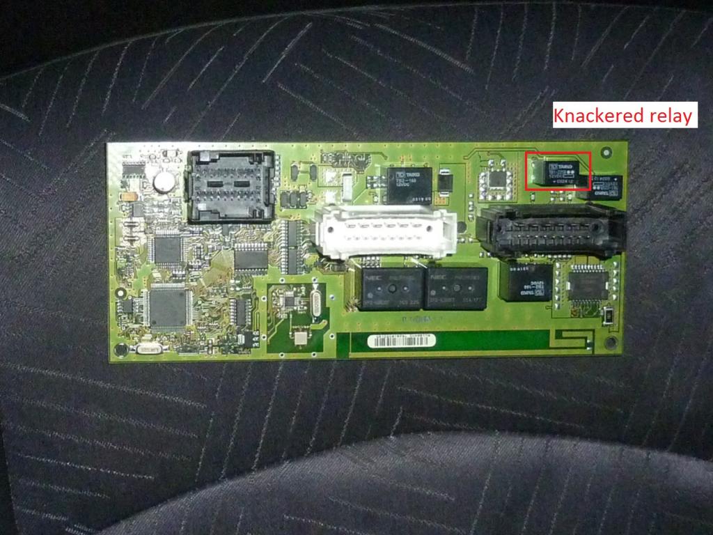

As I didn't want to detach the relays, next on the list was a re-solder of the board using a soldering iron, some flux and some new solder. The area of interest would logically be in the vicinity of the problem causing 40-pin connector. As the symptoms described in the beginning of this post (points 1...3) matched perfectly to a dry solder joint, off I went.
Before heating up the soldering iron, I used a DMM (digital multi meter) to measure some resistors. Didn't find any with a short-circuit. Then some capacitors. They also had enough resistance, no short-circuits here either. Then onto the diodes. Using a DMM in the diode mode I measured the diodes. One of the diodes seemed to give very intermittent readings. At first I wasn't getting any reading, then when I just held the measurement leads in place for a second or two the DMM would display the breakover voltage for a very short amount of time and then it again said that I am measuring an open circuit, although, I was measuring a diode. Aha! There must be something wrong with the solder joint(s) of this diode. Maybe the power to the microprocessor goes through this diode? That would explain why I was losing all the UCH related functionality whenever the fault was on.
I re-soldered all the components inside the yellow box, shown on the attached picture. Special care was given to the diode which was giving out intermittent readings. The intermittent diode is marked with a red outline in the picture. And what do u know, the UCH has been working like it came out the factory the very day.
I must give a word of warning to anyone trying to remove the black 40-pin connector from the PCB. Without using a hot-air soldering station or a suction-pump soldering station, the job was not the easiest one. First, I tried to remove the connector using solder wick. I put four hours into this and no luck. It just wasn't coming out. The next trick was to flood the pins with solder. I put a very liberate amount of solder on the pins such that I had two long rows of solder on the board covering all the 40 pins. Then I used 4 soldering irons simultaneously and gave it some good heat. Having some locking pliers/vise grips already in place around the 40-pin connector, I yanked it out when the solder turned liquid. Yay, I got the connector out without breaking the PCB. But boohoo, the connector was now a melted piece of plastic. So, I had to order a new connector from Mouser.
I am attaching some pictures, maybe these will help someone in the future when encountering similar UCH faults.

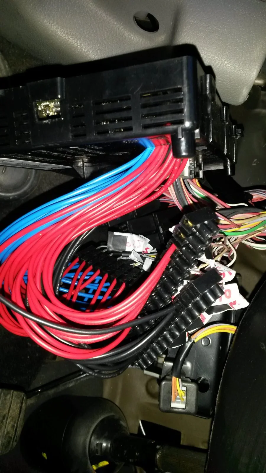

First, a picture of the temporary wiring loom I had used to figure out if the 40-pin connector was causing the UCH problems:
Next, the overall look of the board after I had re-attached the 40-pin connector. It can be noticed that the connector is sitting a little higher then originally as I inserted an "adapter block" between the connector and the PCB, might I ever need to detach it again in order to reach the SMD capacitors and such beneath it.
Next, is the picture taken by andy_casey and edited by me to include my measurement data. I had to measure all the capacitors to find out their values. Also, note the red frame pinpointing the location of the intermittent diode I was talking about, above in the text.
And the looks of the PCB, after all the capacitors and MOVs were replaced with new ones:
I’d say that those "diodes" are actually capacitors. They can be easily mistaken.
Sorry for my previous message. They’re really diodes.
I resoldered all components indicated by Rone and no problems anymore. I didn’t replace anything, just resolder. However, I have experience in electronics repairs and when there’s a broken solder I’m able to see it. In this case, I looked very thoroughly all solders under magnifying glass and I couldn’t notice any crack. I removed the connector with vacuum sucker (desoldering station) in order to resolder all components underneath.
I’m sure that less resoldering would be enough, just a few components really require resoldering, but I’m unable to determine which ones exactly.
