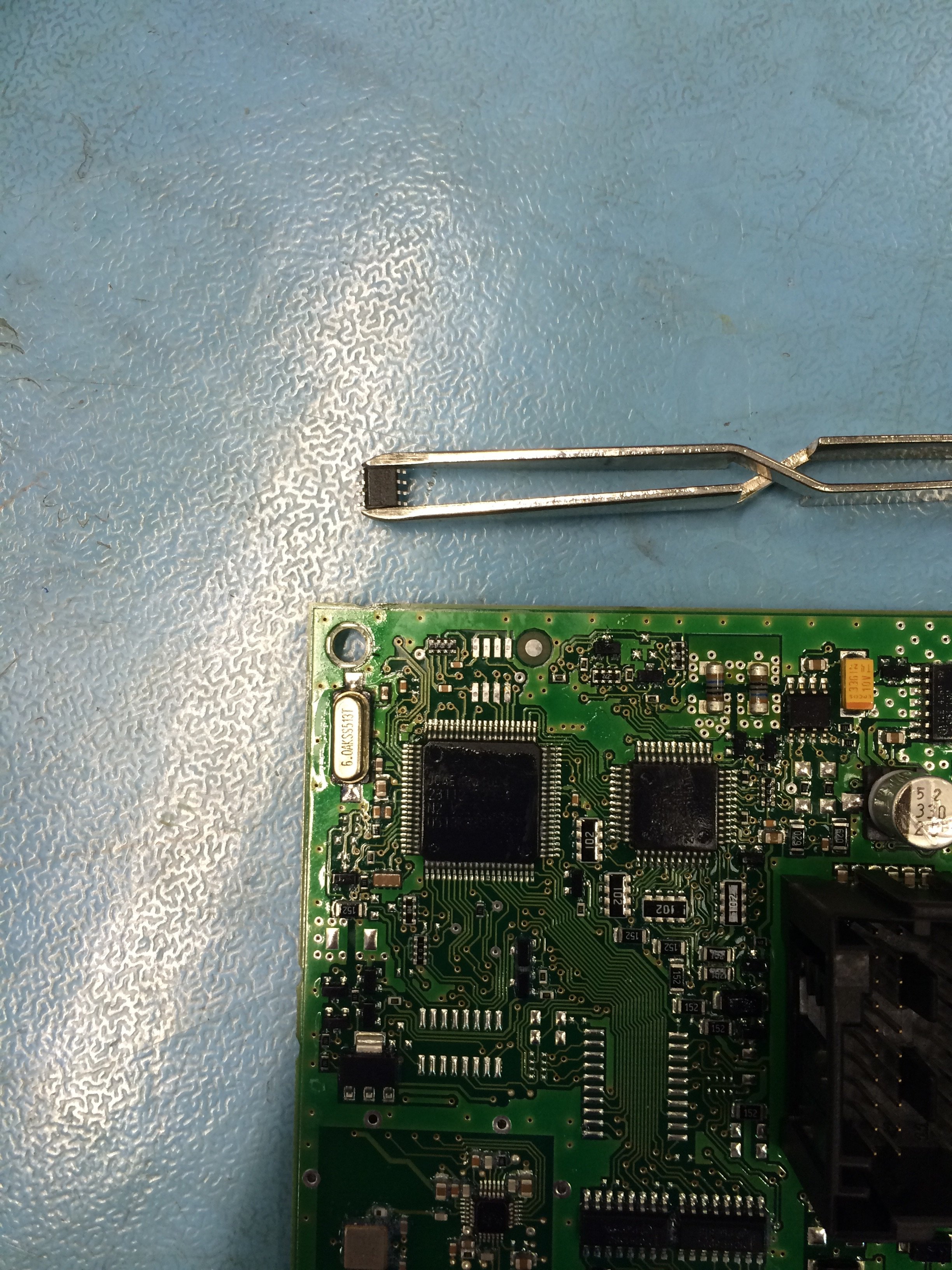

small 8 leg eeprom soc package.

Security chip has 93C66 written on it, 8 legs, as stated above. Best of luck, hope it works for you.

Sure thing. I used a heat gun an really carefully applied heat to the area until the chip slid off. Make sure it's all level and that you don't knock it! Otherwise, you're in the cack. Top tip - take several really good pictures of the board before you start, so you can rebuild it, if necessary - I had to do this on an early test board after removing the 40 pin plug with a little bit too much heat! All worked in the end, which totally amazed me but the UCH was the wron version, so it would only lock :(
