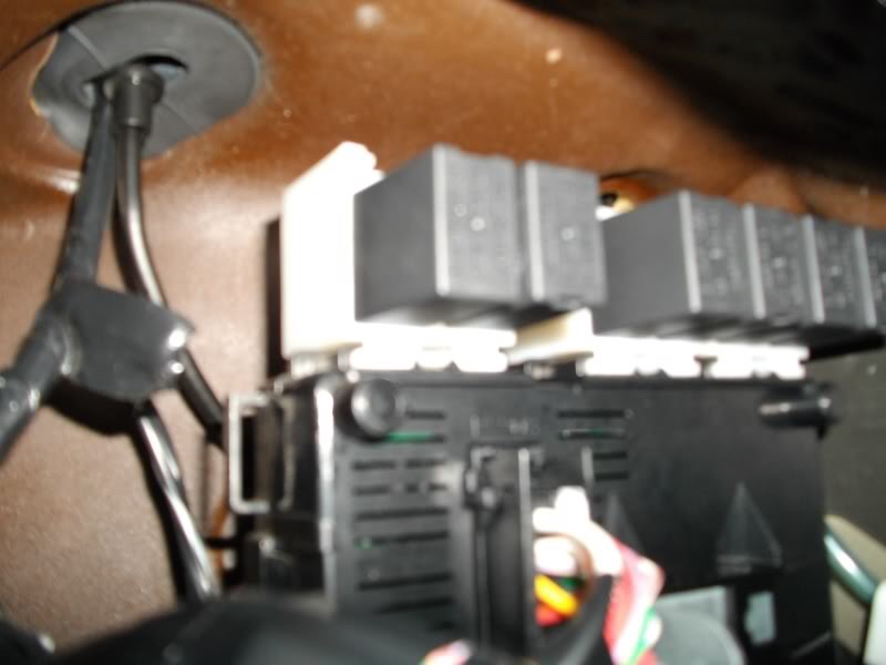

Can you just change the uch without changing anything else ? Think this is my problem with passanger side window not working no clicking noise from the relay :(
The relay is located near the uch

I tried changing them all around but no luck :( drivers side window makes it click but nothing for passanger side window on both switches
If that isn't the problem than it's the problem with the uch most likely... I think you can't change the uch only you need to also change the ecu too and including get a new key from Renault
