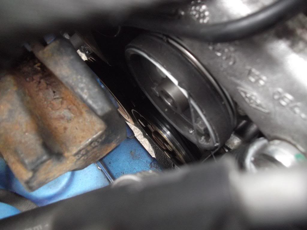

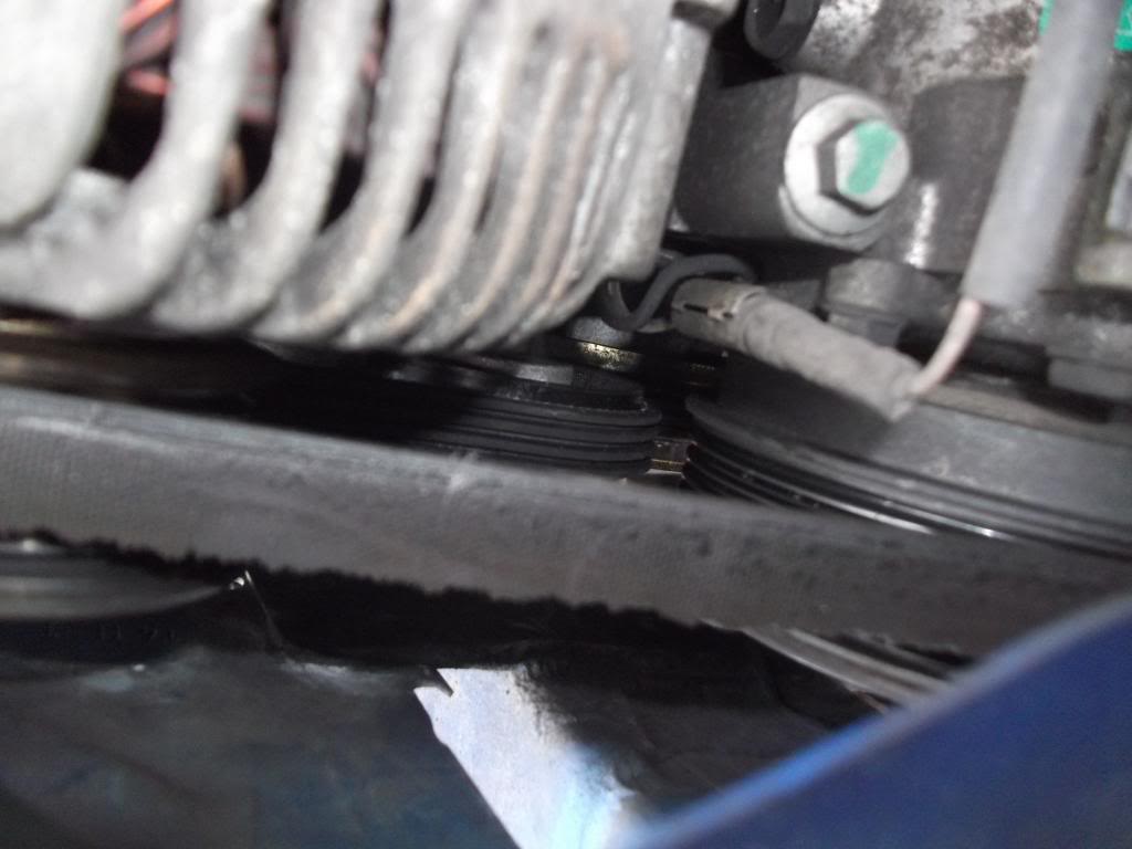

Hey guys, just after any sort of input regarding the car.would be nice. I believe the cambelt has decided to go its own way.
Scenario is, pulled out of a junction at about 12mph then the car just died and wouldn't start. No loud bangs, just cut out.

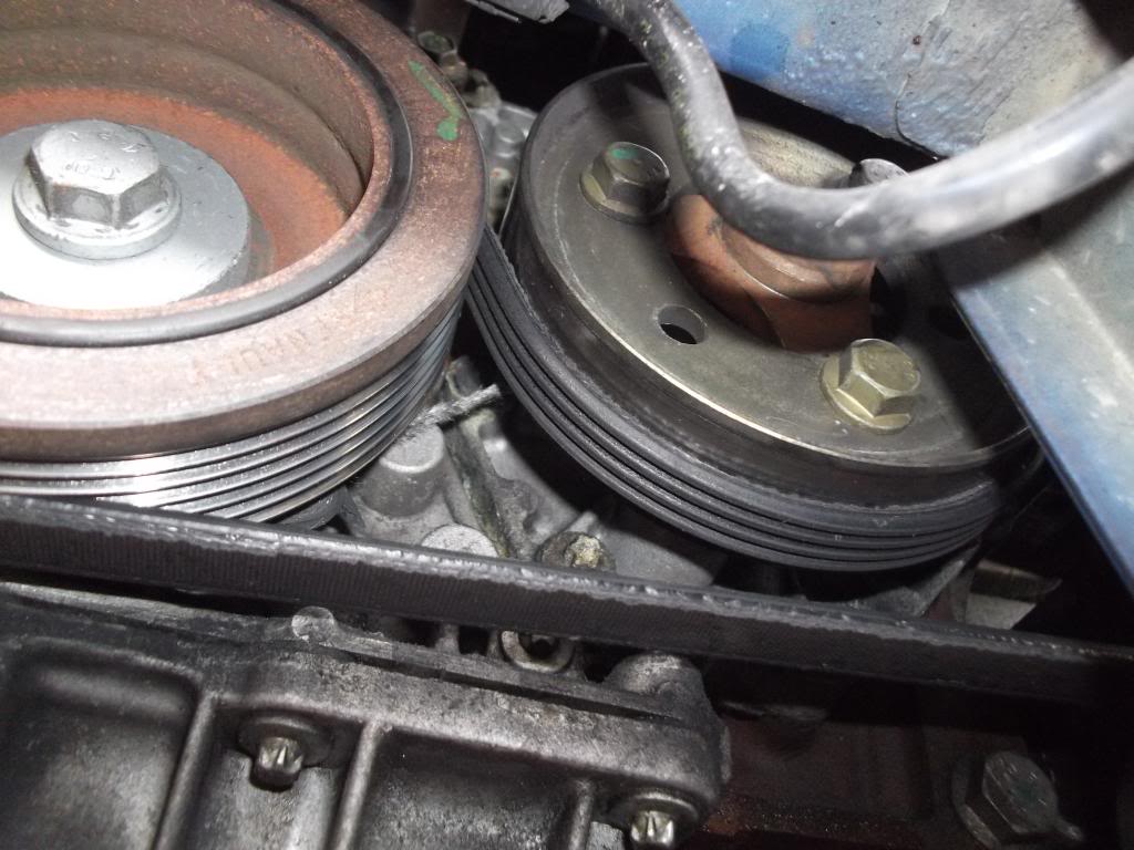

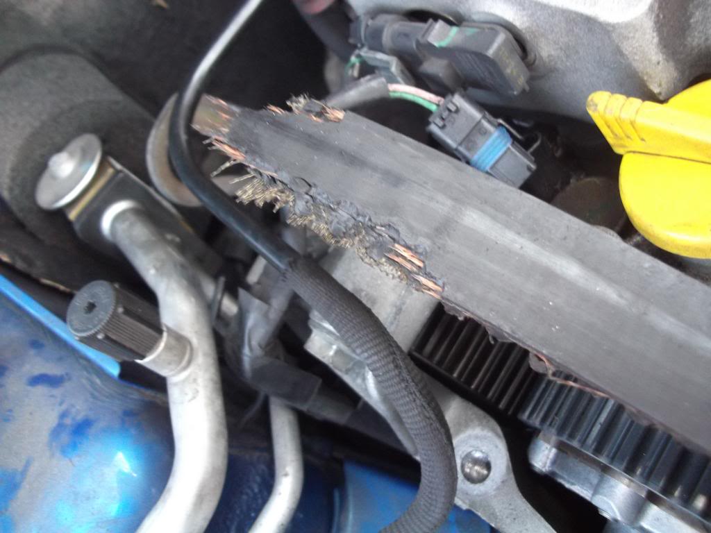

called the RAC and he came and had a look, we noticed the auxillary belt is still on, however the belt has literally been split down the middle. See photos below.
Is there any way I can access the cambelt to see if it is still actually on there, I imagine it won't be as the camshaft isn't turning when the engine is turned over when looking through the filler cap.

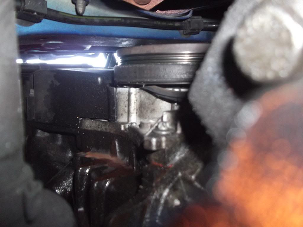

If you jack the engine up and remove the top engine mount/cam belt cover you'll see the state of your belt.
Which garage did it? Local or a specialist? Was the tensioner replaced?
Edit: picture looks like the tensioner was replaced as its still fairly shiny.

The aux belt looks all over the show aswell, half the pulleys its on the engine side and a couple its on the other side so something's gone a miss.

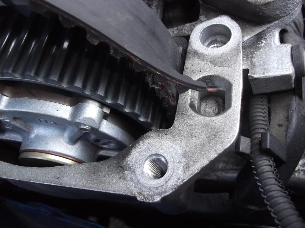

you can see bits of belt behind the crank pulley so i expect the timing has slipped.
its a hard one to pro under warranty who done the work etc?
edit the belt looks old to me and your sure the full kit was done. i bet the name of the place begins with n

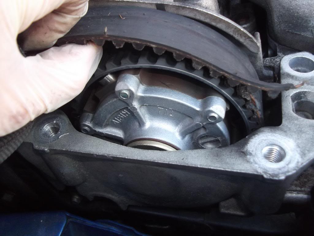

Well there we go chaps, cambelt confirmed
Slight update on the facts as I was a bit out before, car has covered only 2588 miles since fitted full new aux kit.
  Clio 182 arctic

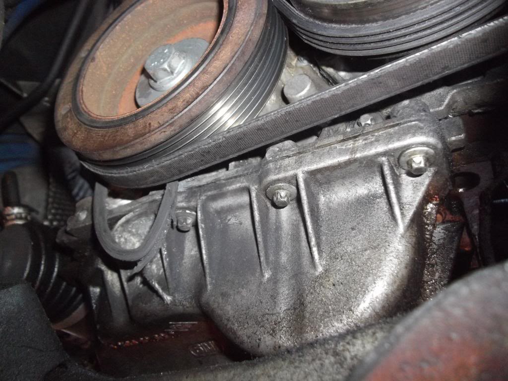

I have found the other half of the aux belt!
It is well and truly wedged into the cambelt behind the crank pulley
My theory atm is that somehow the aux belt has sheared, worked its way into the bottom pulley, that has then basically locked up the bottom and as the top pulleys are trying to carry the belt over then it has snapped? It is going into renault next week so will find out eventually I would imagine.

Car diagnosed at Renault. Power steering pump cut through the belt due to incorrect fitting. The power steering pump was changed with the belt 2500 miles ago so the car is going back to the original garage to be fixed.
So an incorrectly fittted few hundred pound job has now turned into a full rebuild with new belt kits. Brilliant. Won't have a car for a few more weeks.

Power steering pump reconditioned incorrectly, the shaft was too long and caused the pulley to be out of line eventually cutting through the belt and taking out the cambelt.
