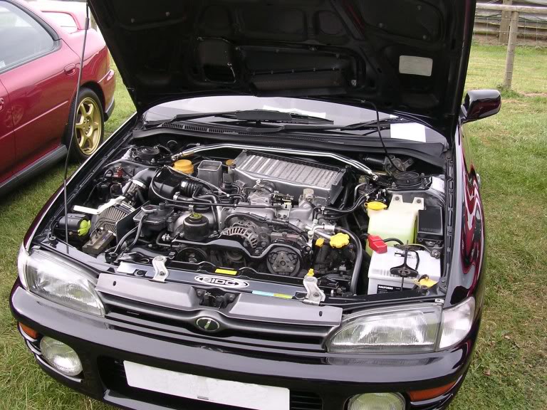

That WRX was one well looked after car....was 11 years old when I sold it.
Really kept on top of the engine bay cleaning..used to give it the once over on quite a regular basis as quite a lot of dirt used to get round the sides of the bonnet and in the IC scoop.

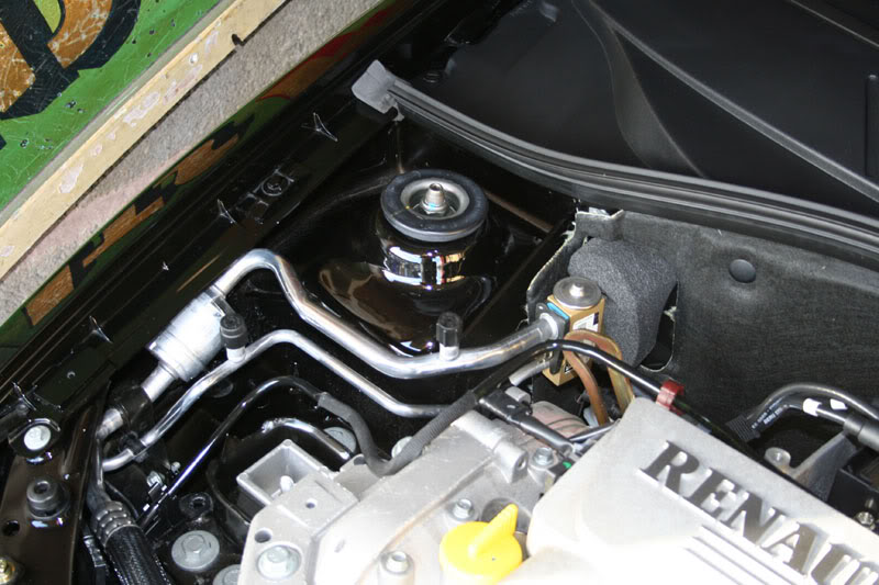

Not needed anything on the fuel rail protector yet apart from a wipe with a damp cloth.
Took my engine cover of to clean up the pipe work etc around and covered by it.
