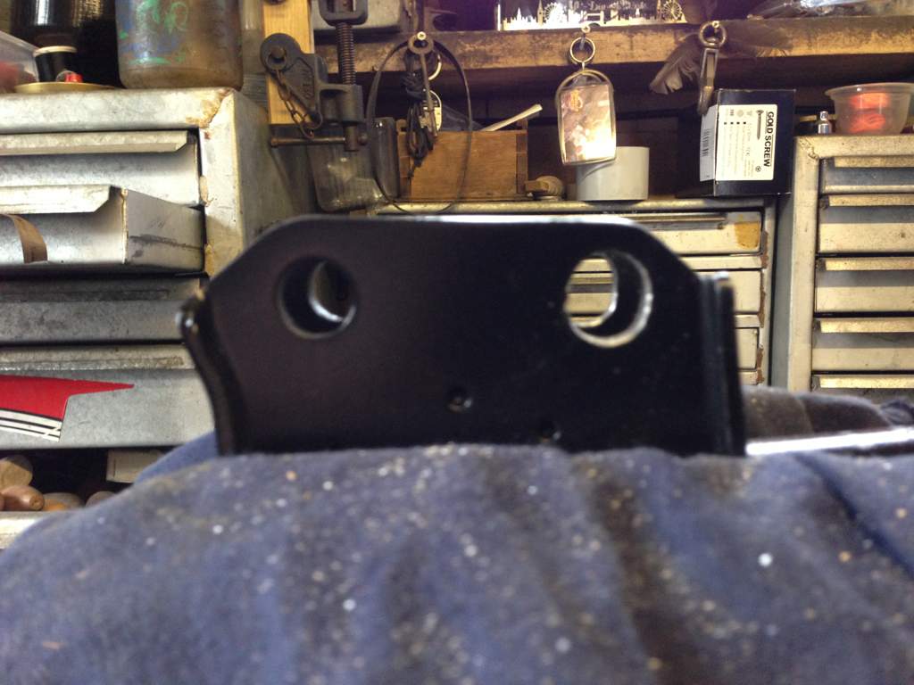

Camber bolts are the only way on standard shocks.
Oh really? ;)
