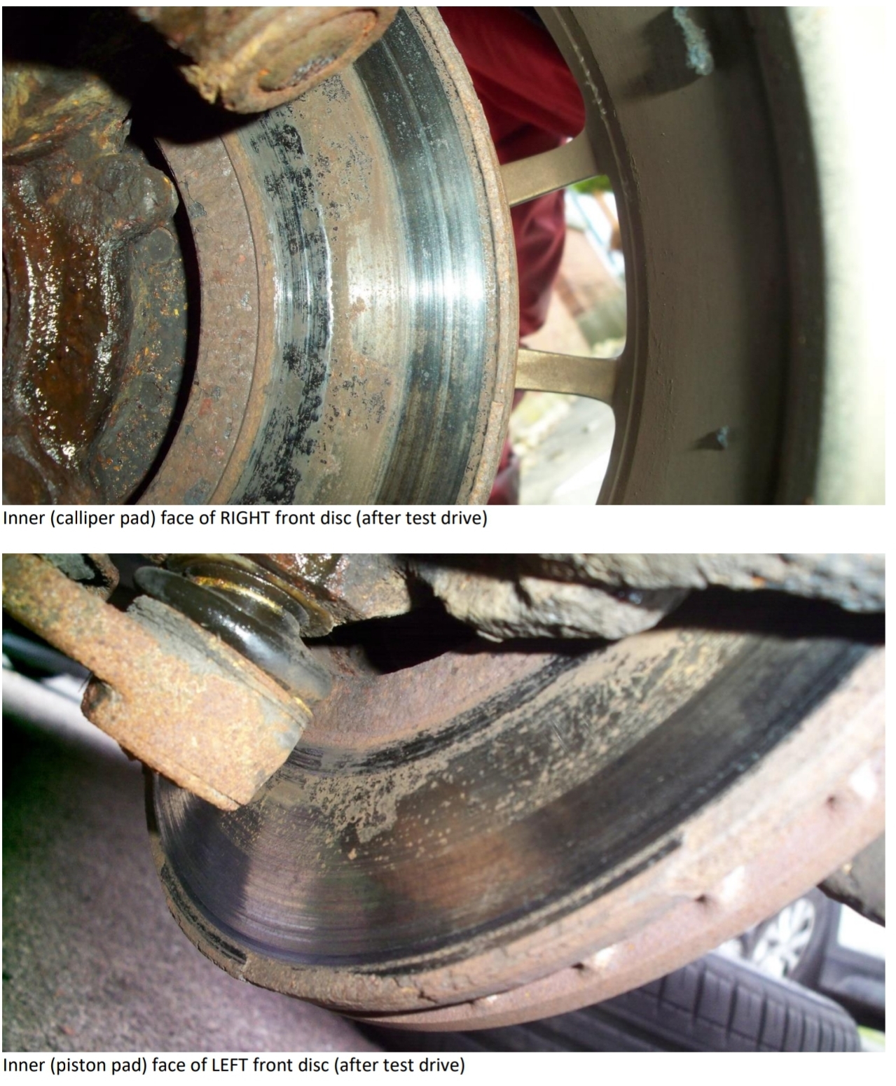

What could be causing this? The pads apparently aren't contacting the inner face properly on both front discs. Both discs and pads were replaced last year with genuine Renault items and have only done around 1000 miles so I'd assume the issue isn't them being worn out

Slider pins are a bit corroded but I just put that down to the car being sat for a few months, not sure how long this issue has been happening though. I'll get some replacements ordered and hope it solves it 👍

If the outside of the disc is ok it's probably the inner pads seized in the carrier as the piston and sliders appear to be moving and pulling the outer pad into the disc

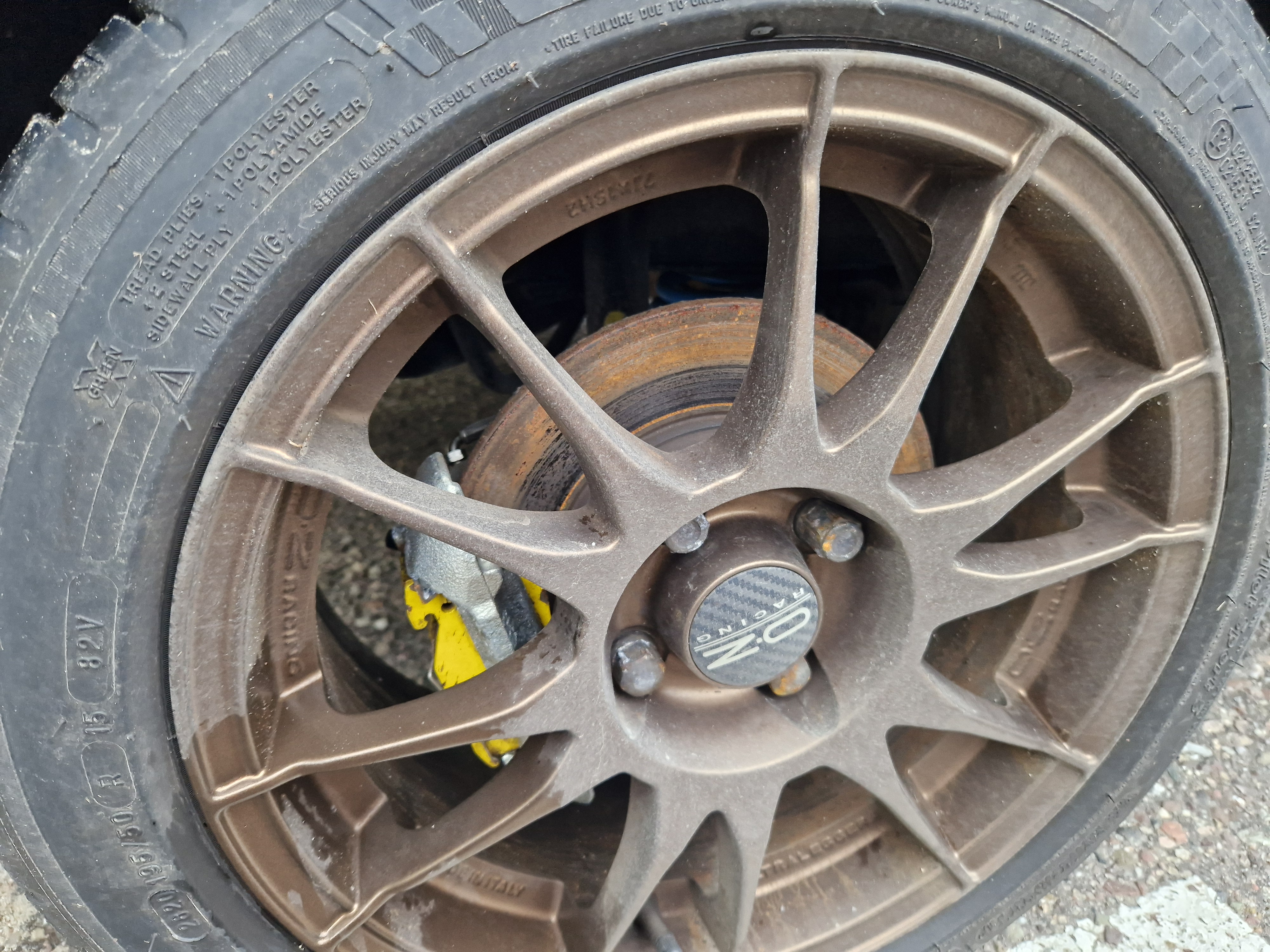

This car is driving me mad. I replaced the rear drivers side caliper about a month ago and everything was fine (apart from the handbrake but that's a different issue). Drove home and checked the disc and it was beautiful and shiny.
Parked the car up for a while and the discs obviously went a bit rusty, but no big deal because obviously that would rub off next time I went for a drive.... Or not as it turns out 🙄
It looks like the pads are barely contacting half the disc, but they were making full contact before. I think I can rule out sliders and piston as it was a brand new caliper, so why is this happening? It's the same on the inside of the disc as well but it was awkward to get a photo.
All the other discs cleaned up fine, and the pedal is nice and firm so I'm pretty sure it's not leaking fluid from anywhere, and there's no wetness on the caliper where the brake line connects.

Looks normal. Rear brakes do nothing so it will take a few miles to get the rust off the full surface
This was after about 30 minutes of driving 🙈
Not mega loose or seized solid, if you can push them then the piston will be able to.
I might whip the carriers off and check the pads are still moving or if they've seized. I remember them being quite stiff but it might be worth filing them down a little bit just in case. Might even swap the clips over while I'm there 🤣

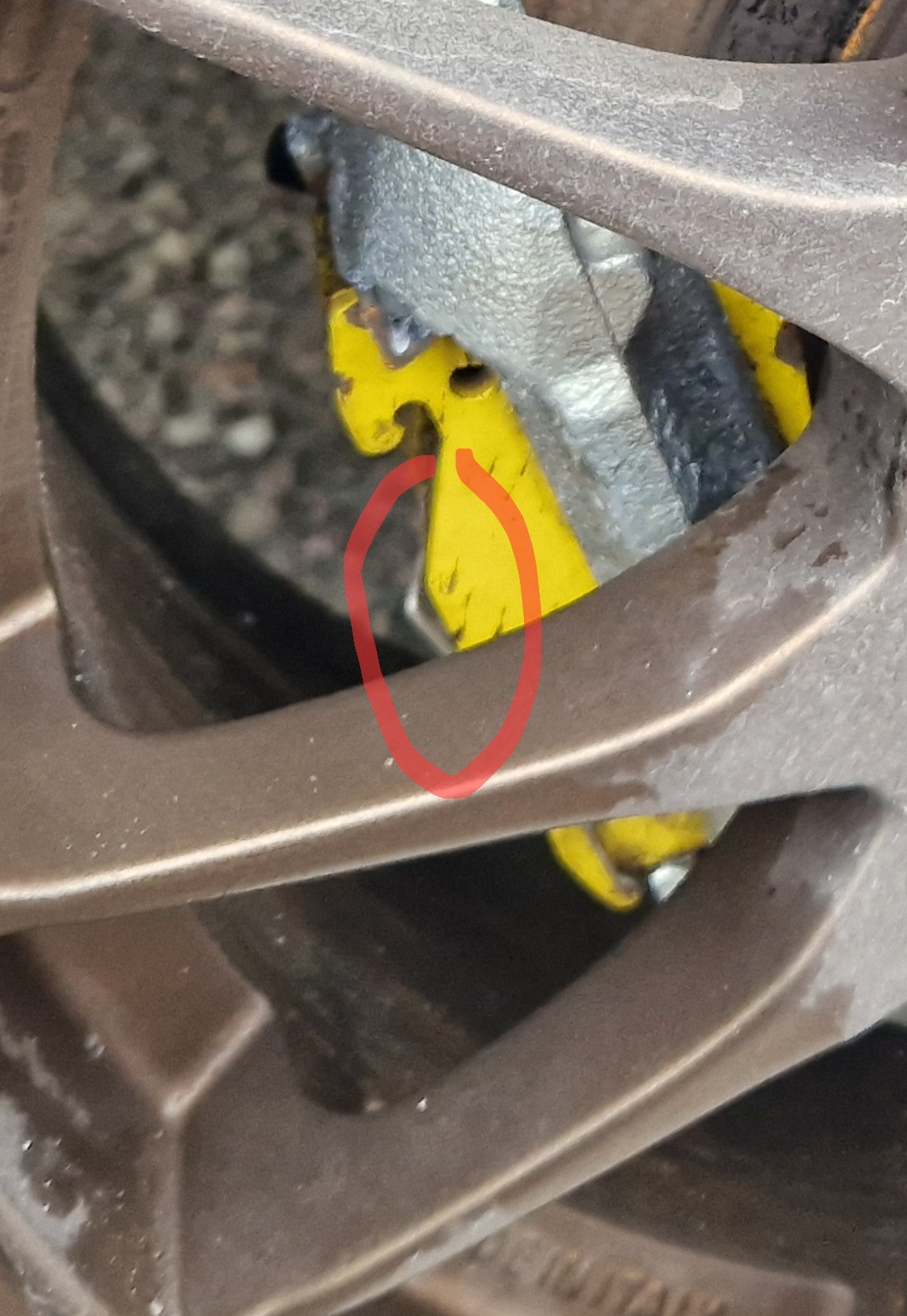

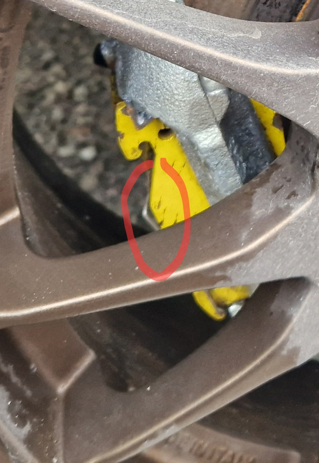

Yeah worth a look.
Clips at the top and the angled bit of metal wedge at the bottom.

Decided to brave the snow today and pulled the pad carrier off. Outside pad was seized solid and had to be smacked out with the back of a socket wrench, and the inner pad wasn't much better.
Filed them both a little bit until they just moved freely, and refitted the metal bar thing and anti-rattle clips the correct way round.
