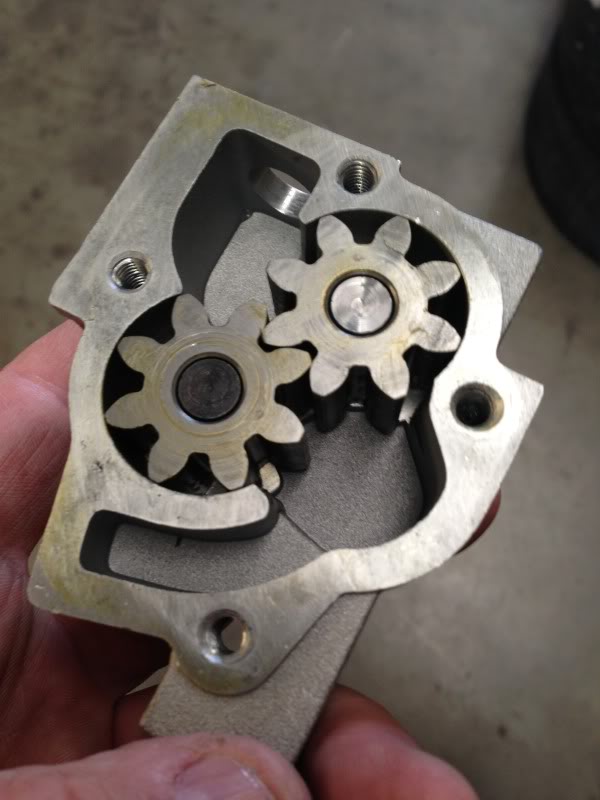

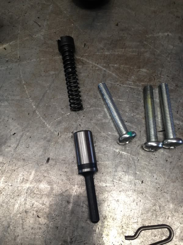

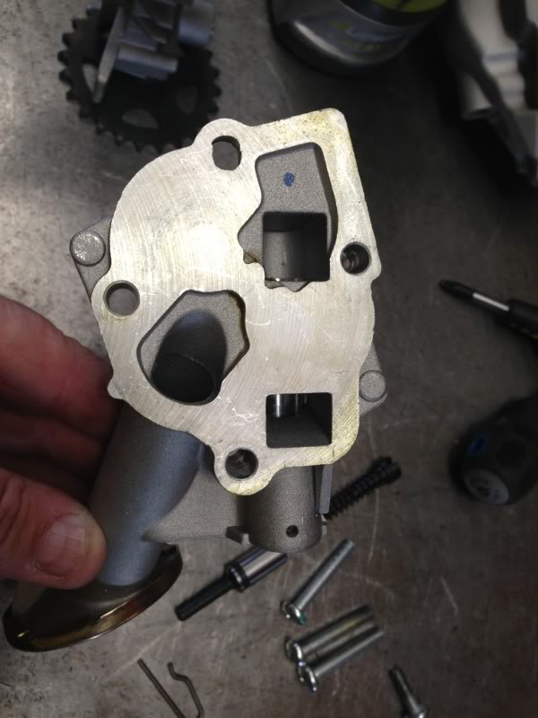

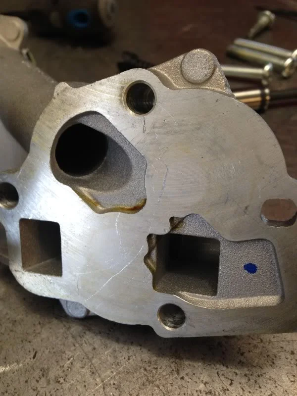

Just taken photo's of a brand new pump I have had delivered to have a look at it , looks easy enough to shim the spring , I guess i'm missing the obvious part about upping the oil pressure !

I am by no means an engine builder so it could be the most obvious obvious thing staring me in the face and I wouldn't know!

so what are the mods you say can be done to a standard pump , I can't see after looking inside the pump

The mod to up the pressure is just a simple and easy one that requires no faffing. Look for the R clip in the pump. The piece that the R clip secures is the bit you modify. Measure how deep the recess is in the original item and then turn it through 90 degrees. Make another groove that R clip can locate into. You just make it look like a hot cross bun. If the original groove is 4mm deep, make the new one around 3mm deep. You'll immediately see an improvement in o/p. It also gives you the opportunity to adjust the pressure to suit if you don't go lairy with the groove depth. You can take out but you can't put back in.
Yes you could very easily just shim the spring with penny washers to get the same result, but if the pressures to high you have to machine it down to suit - this method requires the use of a round file. I've done it and it works.

Can you tighten up the tolerance between the pump body and gears ? this will surely reduce the amount of pressure you're loosing , perhaps its worth looking to see what clearance is there on a standard pump , and if that clearance can be improved on.
