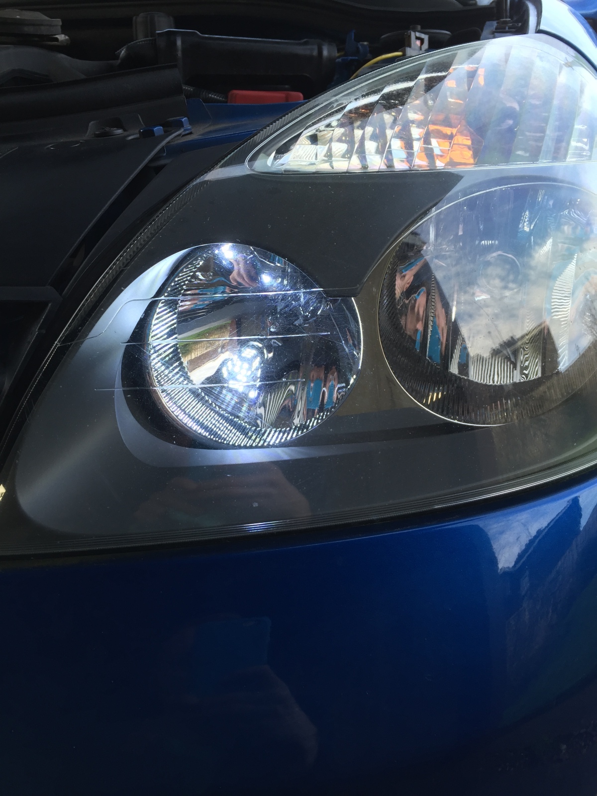

So these are my headlights atm, with the side light fitted.

Just buy a set of 172/182 Xenons, and change the sidelight bulbs.
Plug and play.

But as mentioned, get the whole kit. Ie headlight units , ballasts , ignitors etc and it'll all replace your current setup. Don't worry about the washer jets most remove them anyway

Depends how strict your MOT place is.
Fitting the 1*2 xenons is plug and play BUT! Technically you should also fit the washer jets and the self levelling mechanism that sits on the rear axle.
Then again its such an easy job to swap back to your standard ones for your MOT that I would just keep the old ones in the shed and put them back in for MOT
I say its easy but that's because I never put any screws/bolts back in my bumpers on any of the mk2 Clio's I've had. The clips themselves are more than enough so ripping the bumper off to swap them is a quick job.
