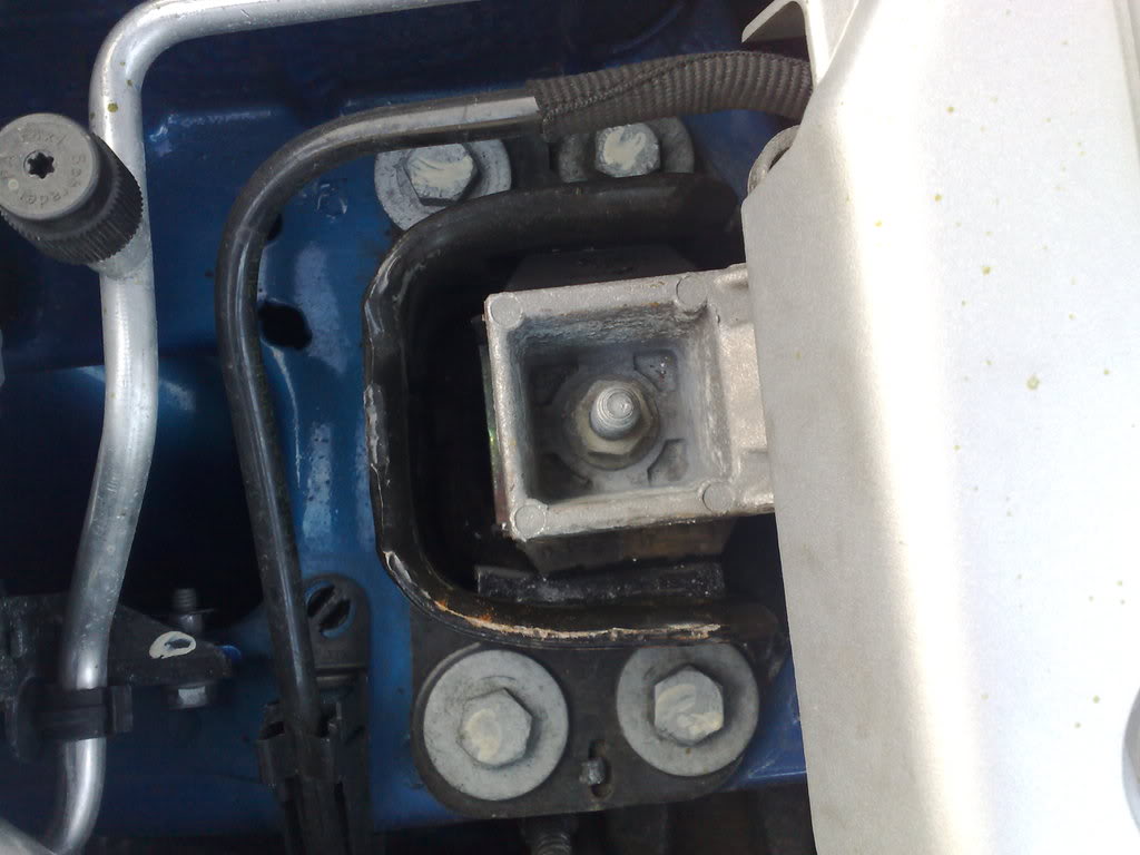

  Dodgy one
I'm surprised no ones chocked the topmount up yet with packings we used to and still do it on the GTi6s, The mounts have too much play in them as standard and cause the chassis to crack when combined with a bit of corrosion
i fitted thsi s**t, i didn't get no problems, dont' believe anyone elses bulls**t, just fit it and learn form your own experience
better ways to put it, but as far as im aware the "elongating" or damaging of other mounts has been experienced by ONE person on here.
Uprating the dog bone may highlight other weak points but will not cause damage its self if fitted correctly.
Choked mount, see the piece of hard rubber stops movement as if you dont have that there is a gap either side.
when i fitted my new top mount, the new buffers that came with it filled out the sides of the mount nicely; there's no real movement to be felt when attempting to rock the engine by hand, but there does seem to be whilst driving the car - i can still feel the powertrain 'shunting' whilst pressing on or during less than perfect gear shifts. i guess it's the relatively soft nature of the rubber in the mounts; KTEC have recently introduced a pair of uprated mounts that might be worth a look further on down the line.
Henry this surprises me; When i got my new mounts (did them all round) the top left one you are talking about with mine did'nt fill out the sides , had some space.
Also my engine can be moved by hand easily, not much though..
Are there different mounts going around at the Renault dealer ??
Frank, the mount i used came from EuroCarParts but it's no different to the Renault mount in design. when new, the buffers should be a tight fit within the mount but they'll wear down in time, which is where the movement that you can feel by hand comes from. guess you could try closing the mount in a vice as sideways danny suggests?

^^ i'm just surprised about yours fiting "snug" in there. Mine was defo not.
I hope the boys at Renault gave me the right mounts !
When standing over the enginebay i can easily rock back and forth the engine about 4-5cm (2 each way)
Are there differences in any of the 172 +182 RS topmounts they sell at Renault ??
Maybe a different one for a Cup or something ? Can't imagine this btw...
i think they're all the same; 2"s of movement's definitely not as it should be - is that all in buffer clearance?
Nope do'nt think so.. 2cm each way, not inches.
