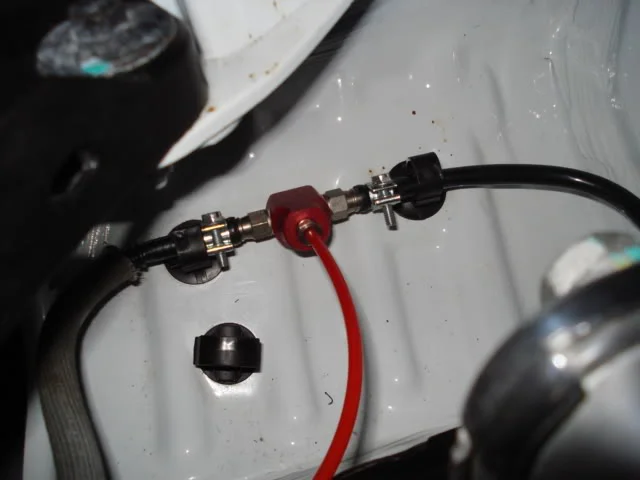

50bhp shot but with controller kicking in a 60% delivery and timed for 6 seconds to 100% the bottles lost most its initial pressure/flow so never actually runs 50bhp, probaly 35-40bhp max. fuelling via STD pump ( 56psi i believe ) through T-piece before fuel rail, running to a fuel specific solenoid that injects with the nitrous, quantities of both matched via flow jets for correct mixture.
