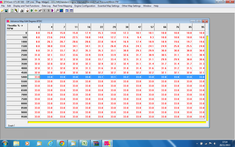

ignition map has made me giggle so much I thought I'd share it. The epitome of lazy
