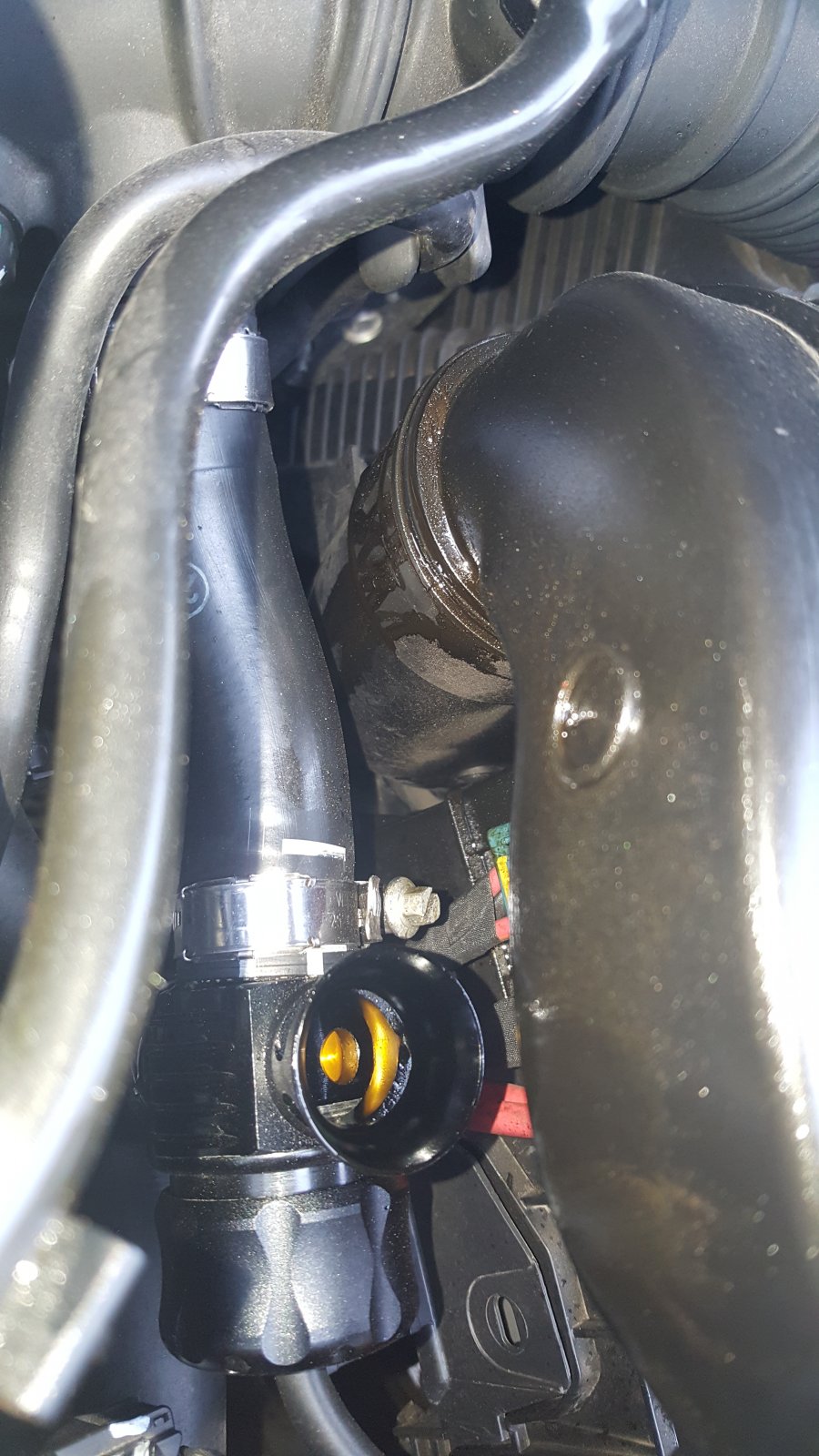

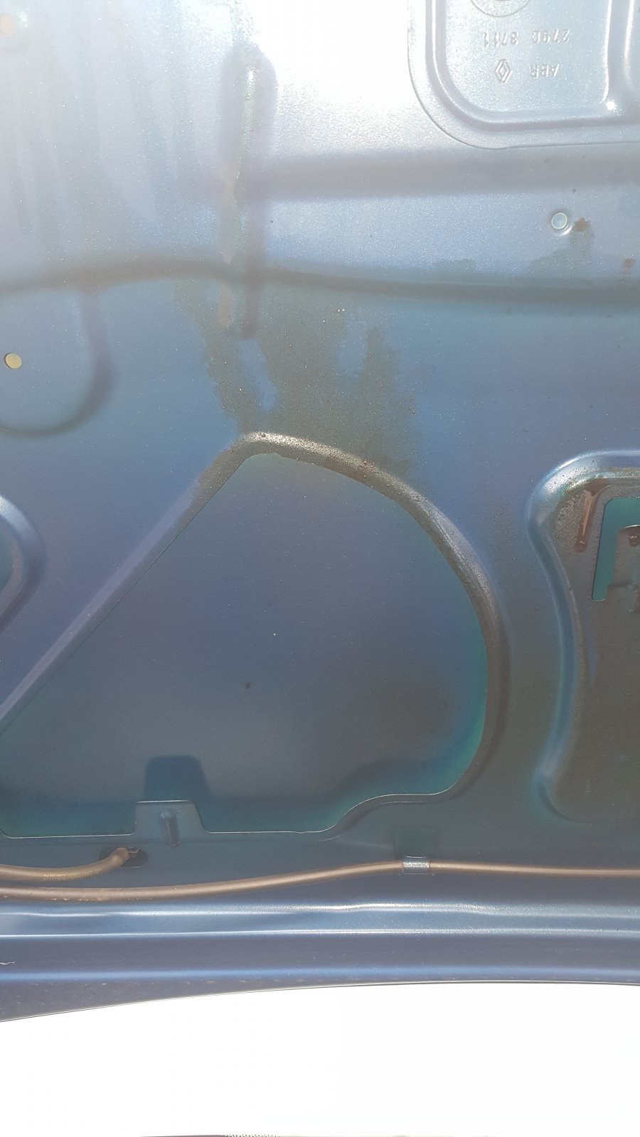

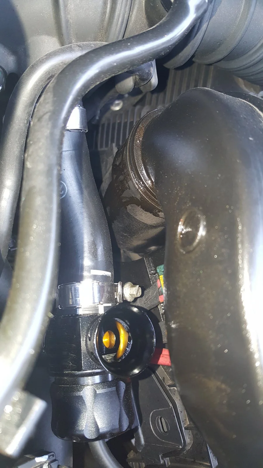

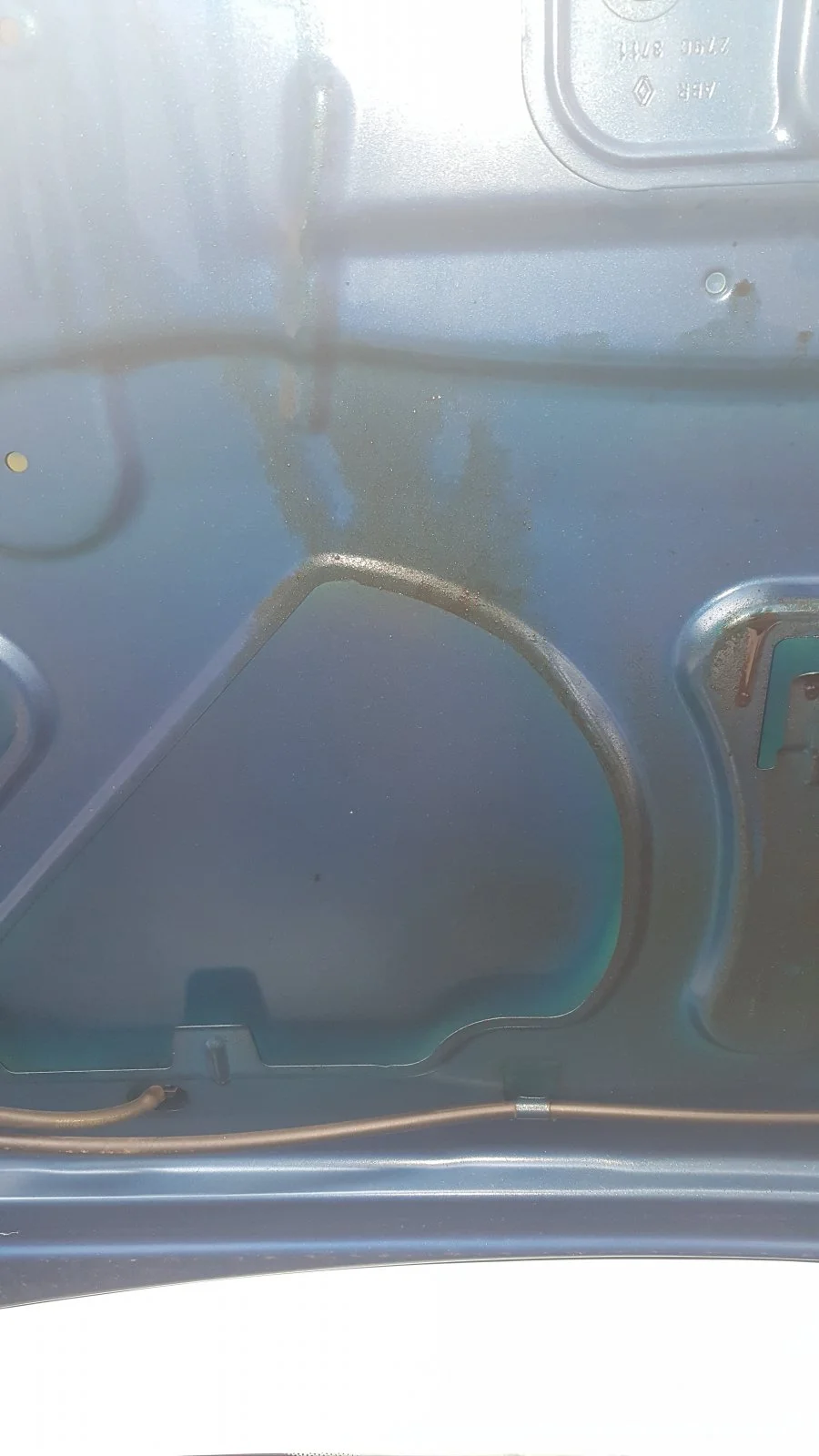

I could but it started to spraying oil up on to the bonnet and I was told by ktec that it is the wrong valve and needs to be removed.
Spraying oil?! It shouldn't have that much oil going through it - otherwise it would point towards failed turbo seals. Have a look at your air box/filter and see if that's coated in oil or not.
Not sure why there would be any oil in the air filter box.

Oil on the underside of the bonnet?

This was the state it was in then the atmospheric was installed.

You sure that oils come from the valve?
