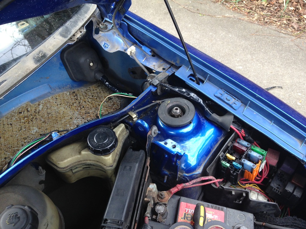

Can just about see the relays in the bottom right of this pic

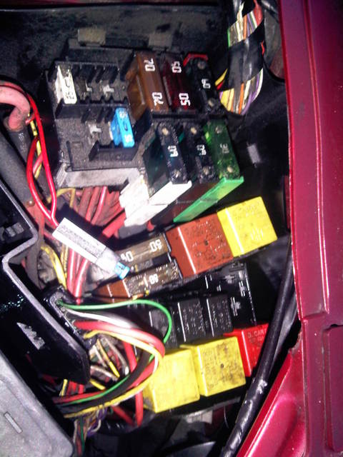

Another pic from the net. The small black ones.

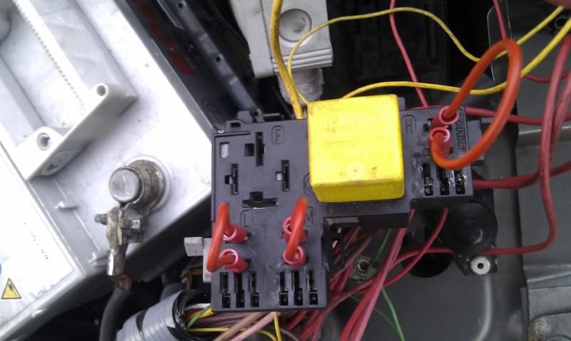

This is hot wiring of the relays to rule them out. Someone else's pic from a ph1 though so slightly different layout of relays.
