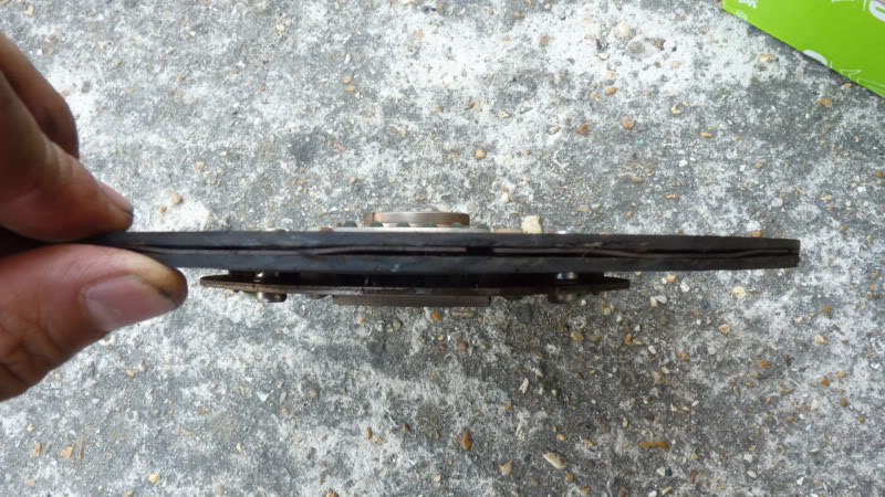

C c6mby ClioSport Club Member Car 172 May 21, 2010 #1 hi all im trying to fit my clutch and new gearbox as i type this, anyway quick clutch question in the picture below does the fat side(lower side next to my thumb) of the clutch plate go towards the gearbox or engine please??
N NWPerformance Car Various May 21, 2010 #3 The thicker bit by your thumb goes gearbox side. Sometimes say which side is which
C c6mby ClioSport Club Member Car 172 May 21, 2010 #5 thanks very much, i had to look online at other cars in the end regards sam
