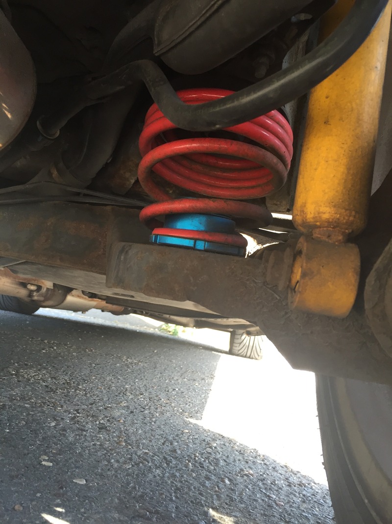

Recently bought a Clio 182 half done track car, stated in the advert it was 'lowered on coilovers' which normally means to me the coilovers fitted are not a brand make to shout about.
Anyways since owning it i haven't really given it a proper drive on some decent roads, however i did the other night. A road i know well and the 172 Cup with K-tec coilovers on handled just fine but the 182 bottomed out under conditions i would not really consider extreme enough to even get close to using a whole travel of the suspension.

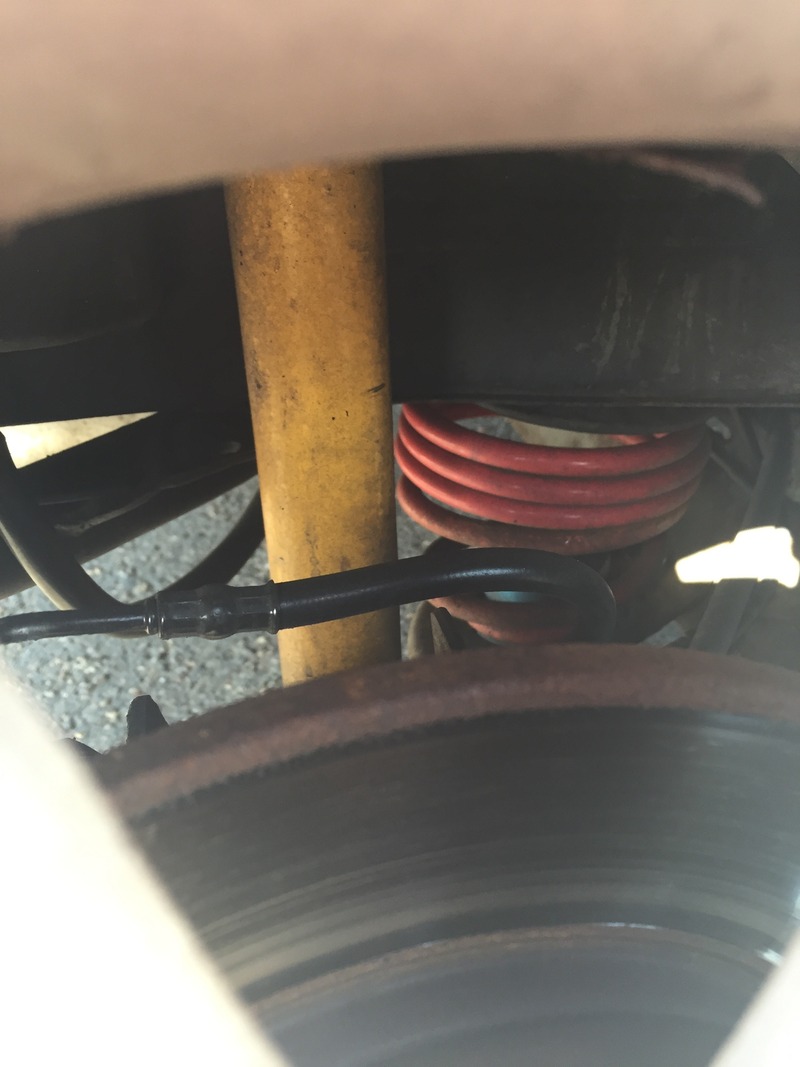

Upon looking underneath i found the rear spring was sat on with about 3 coils one on top of the other. Hence why it bottomed out as i mostly have about over 50% of the travel taken away.
Sorry for the poor pictures!
Is this how they actually come? Both sides are the same, or is it shoddy fitting?

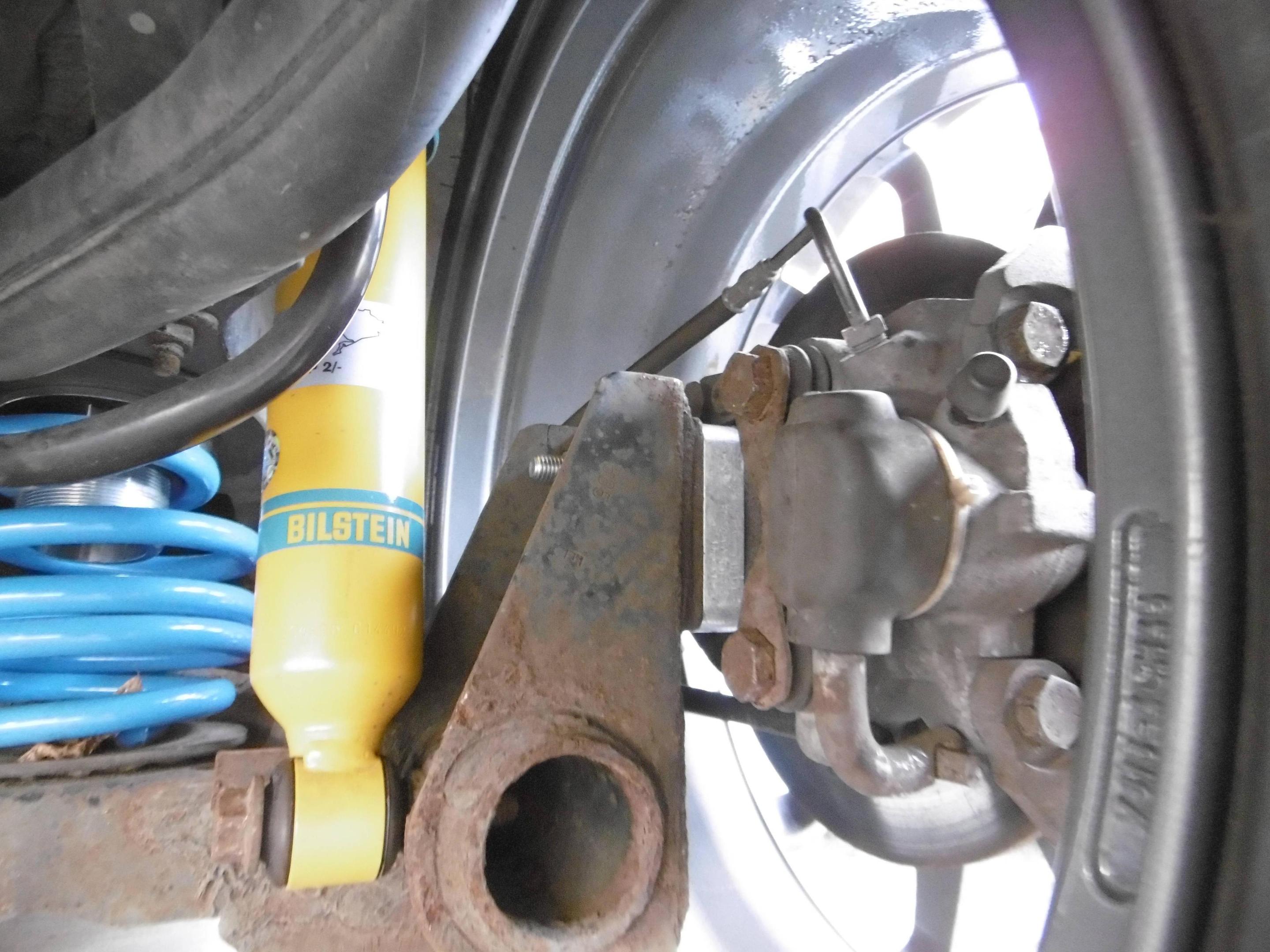

Just looked at my rear suspension as I was curious as the shocks looked the same
Not sure if I have the adjuster in the wrong place after seeing yours. this is my spring anyway.

I think the adjuster on them billies could be on the wrong side. I've never known adjustment from the top!

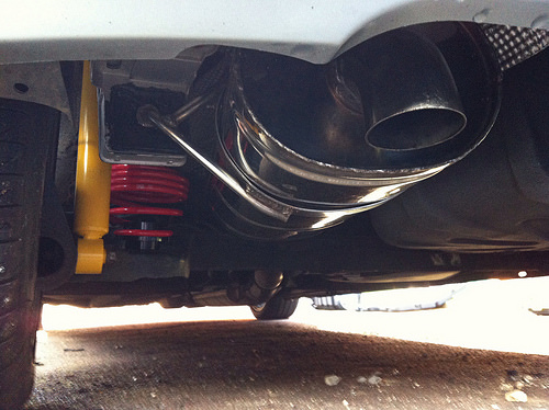

My AP Coilovers are the same, are the rear springs actually meant to be coilbound?
I thought mine were broken at first :smile::down:
