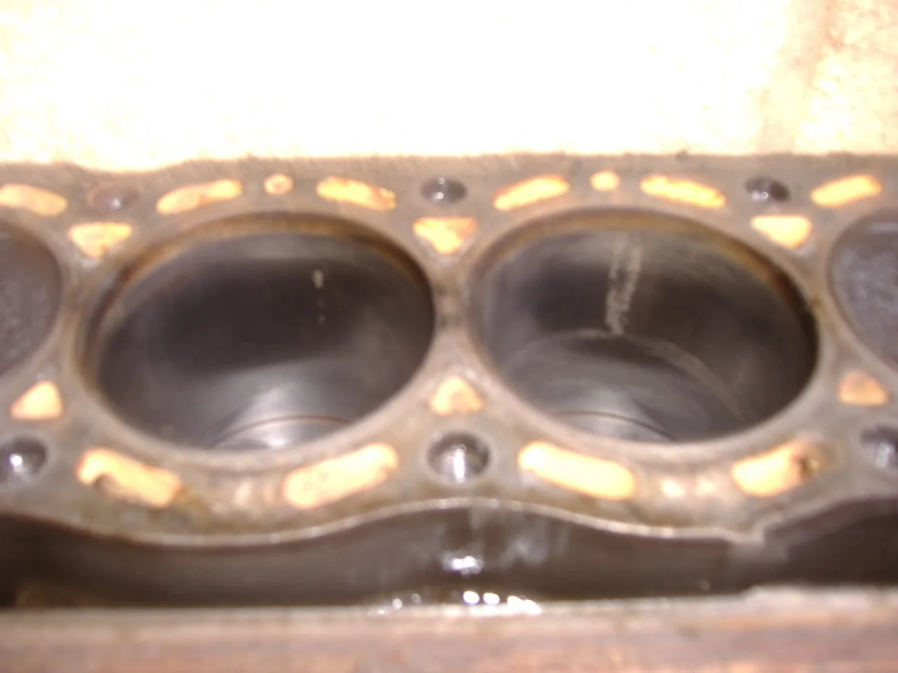

im currently in the process of stripping down a valver engine that i bought. it burns oil so am replacing piston rings, an everything else like water & oil pumps etc, etc. i looked at the bores today after i took the head off. i found these marks:
how bad is this?? re-bore needed? ive done loads of engine work but never a bottom end re-build.

i would but after seeing this, im thinking of going down the megane 2liter bottom end route. anyone on here done this?
Quite a few people have done it and for ht eprice its what I would do as well.
