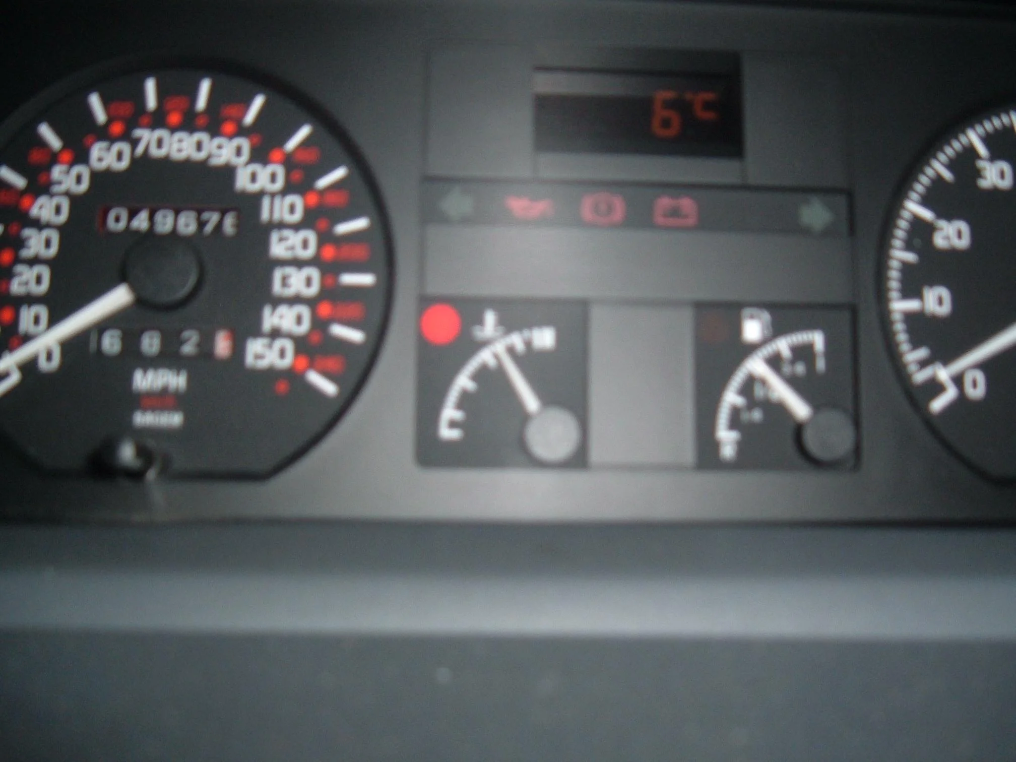

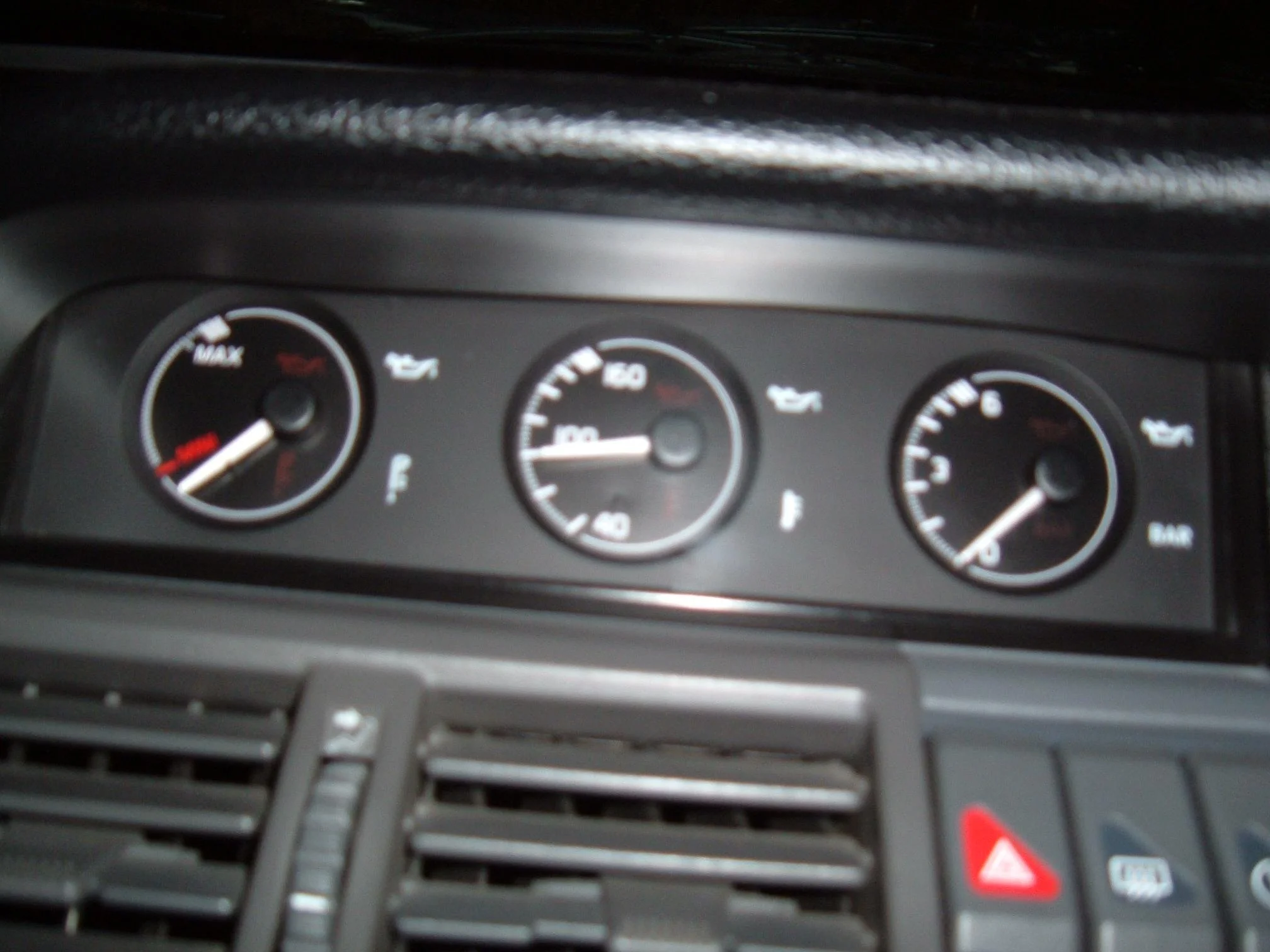

I think that i'm having a few overheating problems ever since I changed the rad on my valver a few months ago. The fan seems to kick in even on a normal journey. Does anyone know what is the normal operation temp is , and what it should be on he motorway? I have some pics to shows the temps. Cheers, Matt:)

on the temp gauge when sitting in traffic mines goes up to where yours is now (well a bit below it) then the fan kicks in straight away and cools it right down.
on the motorway the needle sits on the 2nd line (the one level with 1/4 tank of petrol)
my oil runs hotter than your does though by the looks of it, above 100 a quite often
mines on 84k.

Took her out for a spin tonight and the fan seemed to be kicking in when on the motorway:( The oil temp was a bit higher that the pic, above 100deg like urs. Just hope it not doing to much damage if the engine gets too hot. I changed the thermostat when I did the rad and I think it tends to run at a higher temp now. Should'nt do any damage should it?:eek:

at standstill my old valver would be where that needle is in the pic. Running, the fan should not need to come on!

Also noticed you ahve almost zero oil pressure....unless the gauge is fucked
From the pics oil ooks about the right temp, just coolant, i'd put money ont eh fact the fact you have an air lock

oil pressure gauge works fine m8, engine was not running at the time, just turned it off, ran in to get the digi cam and turned the ignition on again. Think I may have used more than 1ltr of water when i changed it last as it tends to go down when it gets flushed round the system. Cheers for ur help m8:cool:

fitted that and now my temps are a LOT higher, previously the stat would open up just after the first main bar, 1/3rd way up......once that happened it would drop to below that bar and the temps would fluctuate back and forth depending on driving/traffic etc........now, it goes all the way up to the 2nd main bar, 2/3rds, then the stat opens and it drops to about half way on the gauge, etc etc

When I went to a machanic to get some advice he said that at normal operating temperature the engine should be about 90deg, which it was when he tested the coolant temperature in the system. It's when I'm on the motorway or put my foot down a bit it seems to shoot right up near the top, as pictured. It never seemed to do this previously with the other stat I had. Should'nt have changed it:mad:, never mind. BB Tuning do a Low Temp Thermostat that opens up at 82deg,so I may put one of those in and see if it make any difference. Will probaly try bleeding the rad first though, incase there is an air lock.:approve:
