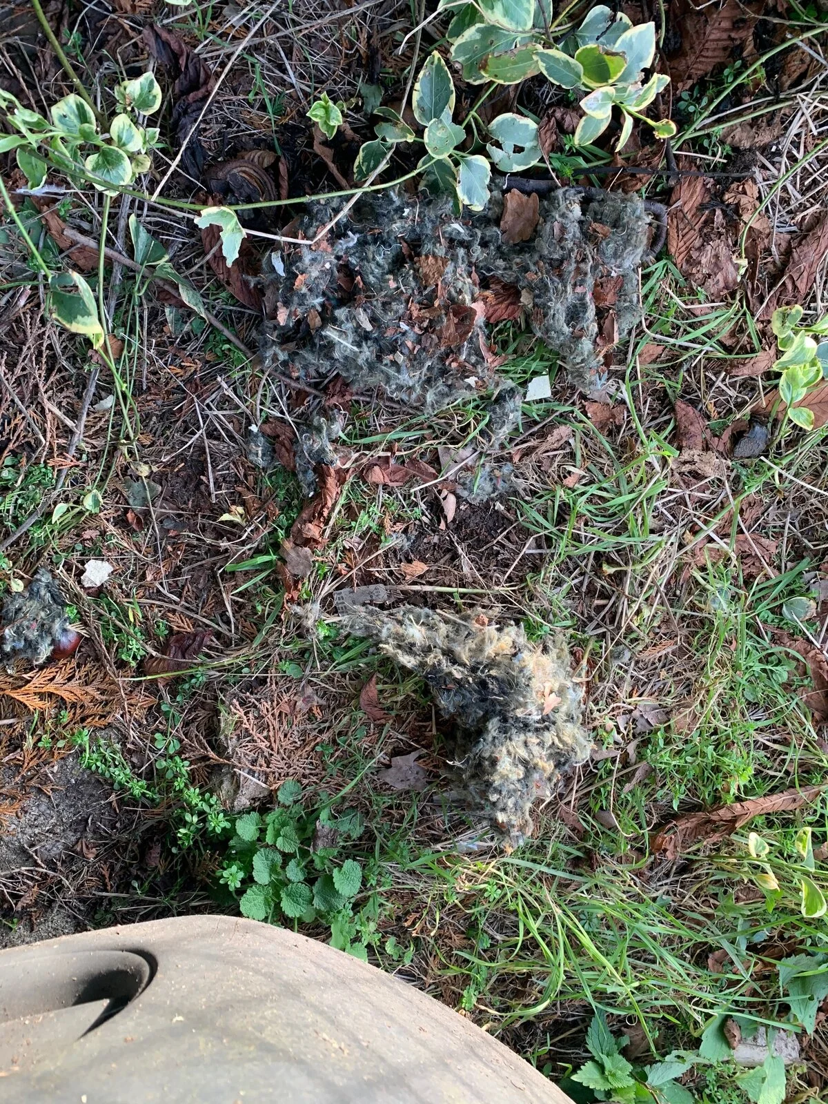

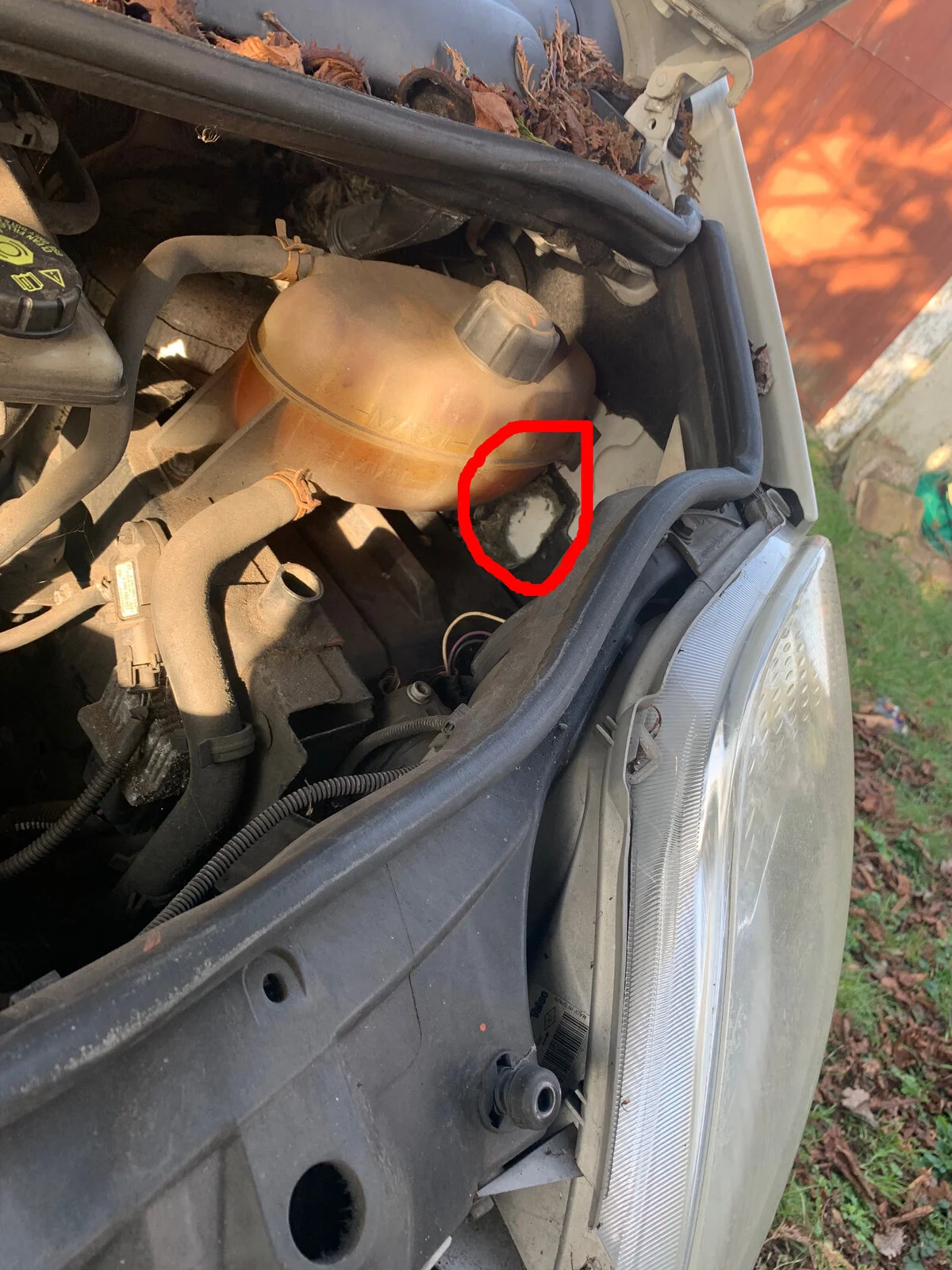

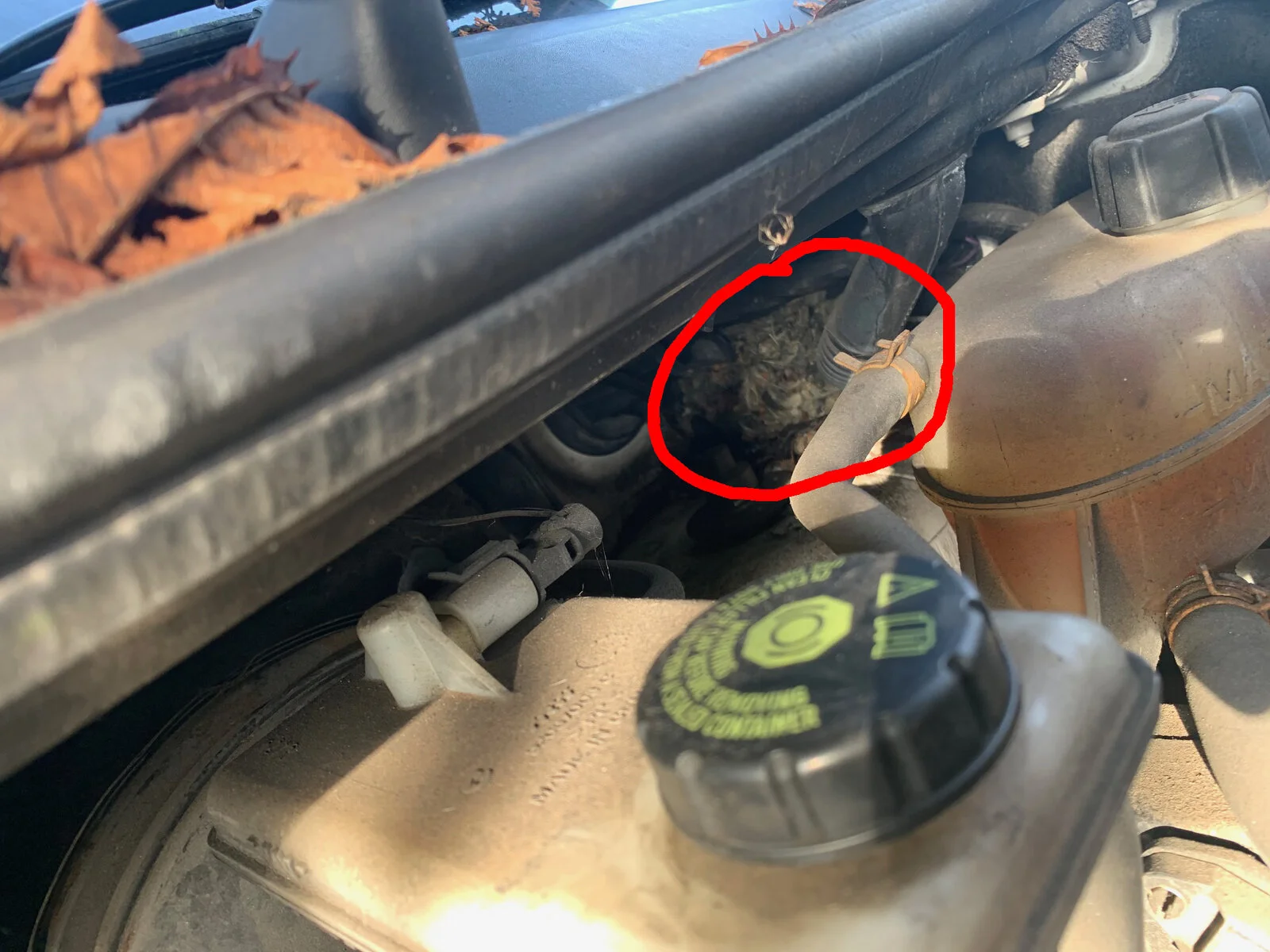

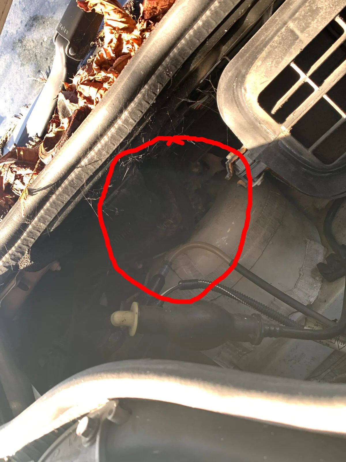

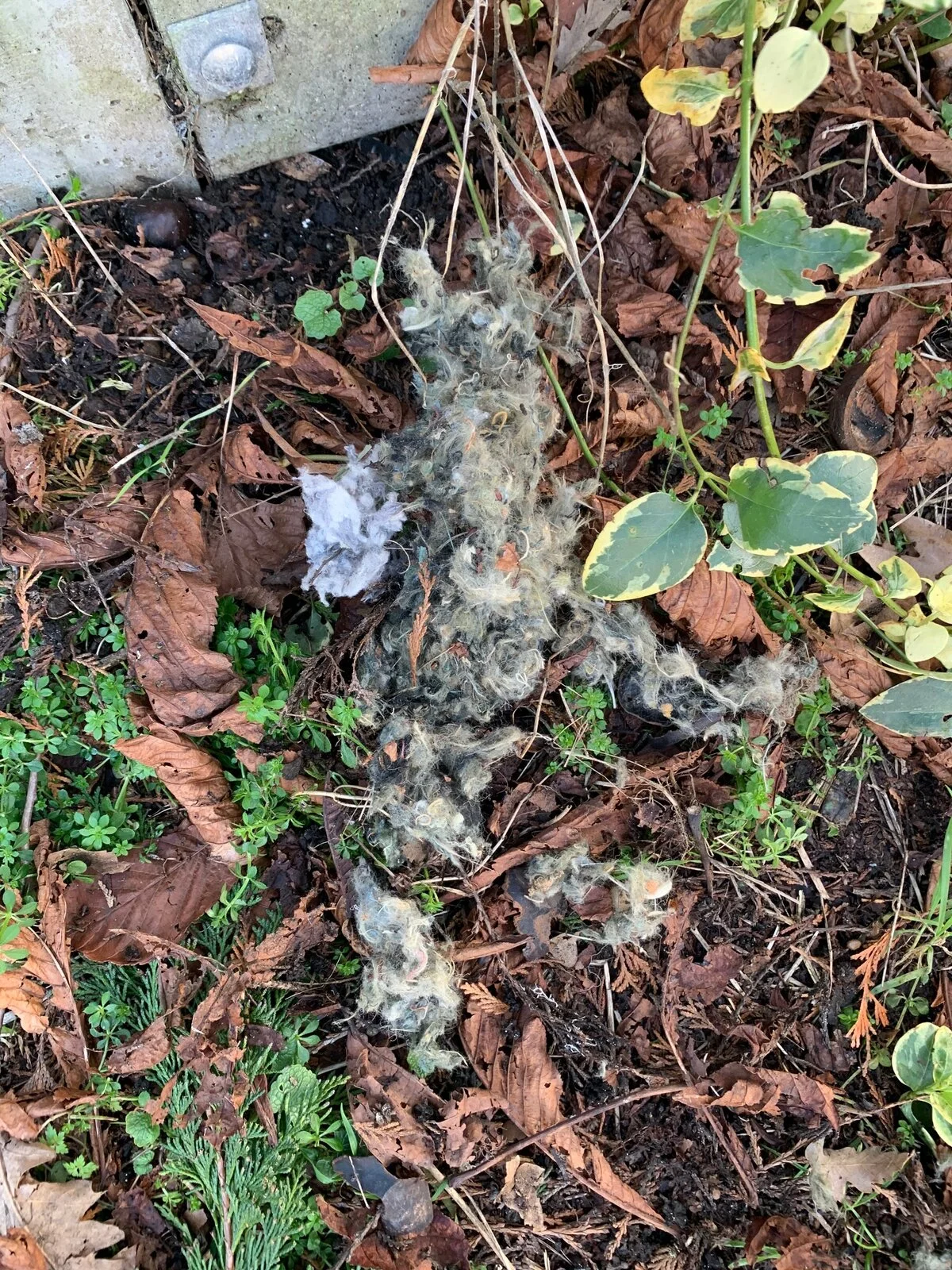

I have noticed that mice have been living in the engine bay (it's parked down the bottom of my drive and is very dark etc). They've chewed through some soundproofing etc round the edges and they've made two 'nests', one on either corner of the chassis. I've cleared these out now but I'm hoping they haven't chewed through any electrics so does anyone have any idea about the glowplug issue? I can't see any damage to any visible cabling on the loom but understand it could be further down the line.. but the issue clears if you leave the van off for a little while.
I'll upload the photos of what the three blind mice have been up to while it's been sat just for the luls but if anyone has any ideas then let me know and I'll see what I can do.

Pic 1: Hole in the felt (They've chewed a lot more than this going by the amount in their nests but unsure where yet)
Picture 2: Nest 1
Picture 3: Nest 2
Picture 4: One nest cleared
Picture 5: Nest number 2 cleared out
