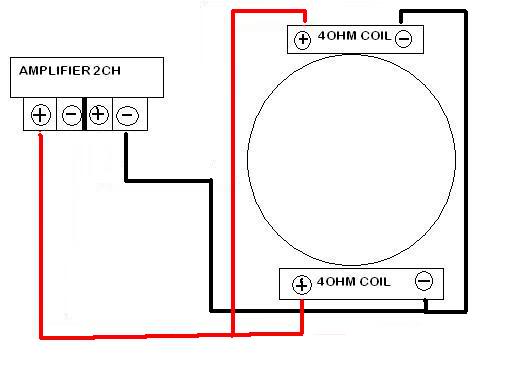

Ok, its now time to check the actual amplifier to sub wiring configuration....
The sub your using looks like a dual 4ohm voice coil sub, so can be configured to show either a 2ohm or 8ohm final impedance....
The Juice Amplifier your using is a 2ch Amplifier, it would appear to be a budget brand, (reads as, "cheap TAT" I'm afraid), which IMO wouldn't be 1ohm stable, which would imply it can't or shouldn't be bridged into less than 4ohm....
So, who fitted the sub in your enclosure ???
How are the coils configured, running one at 0 degrees & the other at 180 degrees would result in very little output & accelerated heat build up which would cause premature coil failure....

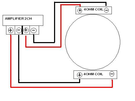

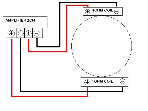

I would wire the sub at one coil per channel;

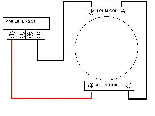

You could try it bridged into 2ohm;

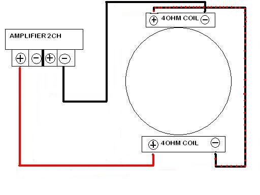

You could try it bridged into 8ohm;
But if the coils are wired out of phase with each other then expect issues & possible damage;
Sub wired one coil per channel, (OUT OF PHASE);
8ohm bridged, coils out of phase;
REMEMBER, COILS OUT OF PHASE IS BAD
Double check.....
Laymans definition, Coil A is pushing, Coil B is pulling = very little cone movement, very little output, excessive heat build up in both coils.....

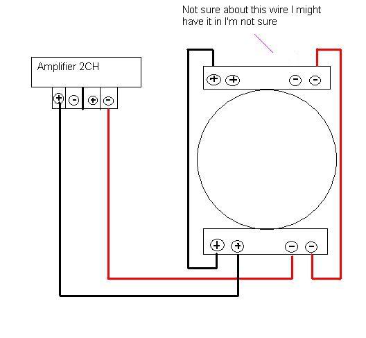

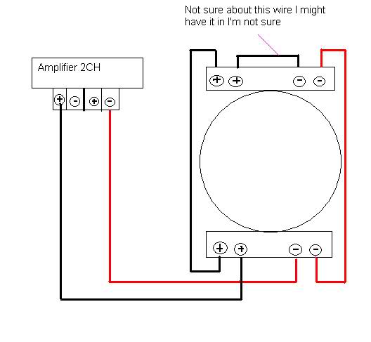

  Clio 1.2 16V Dynamique
Thanks for the reply man. I fitted the sub into the enclosure myself, there are two holes in the enclosure and wiring already fitted to the other side of the holes so I dont think I can do some of the ways suggested. Here is the way I done it, I dont know if its right or not but it sounded ok from my home stereo:
  Polo + Micra
by the looks of it that wire is just a short between the + and -.
and just make sure the coils are connected right as wallop has shown
  Polo + Micra
well yes if the amp is stable with a 2 ohm bridge load. if not then no(can't answer this as there are no real specs. to be found on the net)
i'd connect it the way shown in wallops first pic in his post a couple of replies before

Ok thanks, the thing is though, the sub works fine on my home stereo so I would of thought the problem was nothing to to with the sub.

A picture paints a thousand words, if your sub is wired as your pic, (with one coil shorted out), then that needs to be sorted before you try it again....
The second terminals on each coil are simply to make wiring easier....So if you configure your coils like this, your running your coils in 'parallel' at 2ohm....
