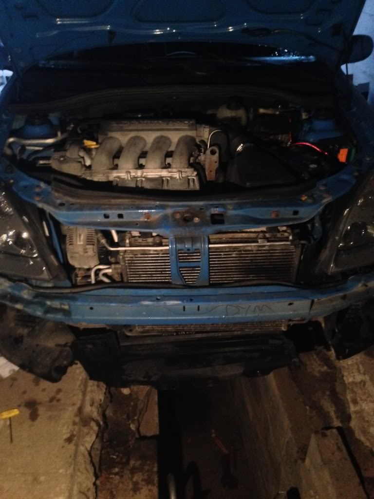

front bumper came off last night and hopefully get it all sorted tonight
heres a pic
