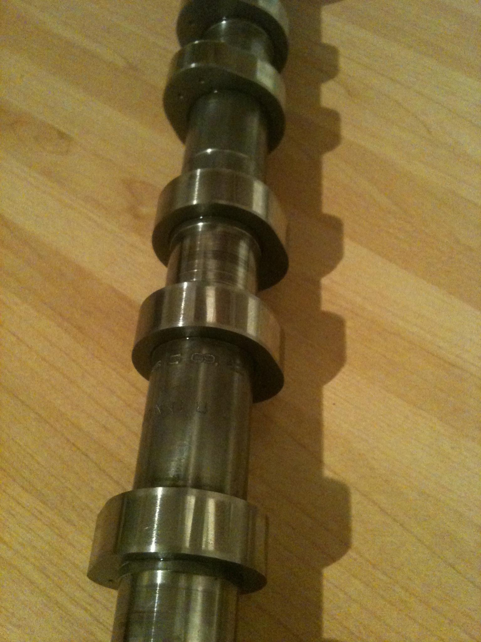

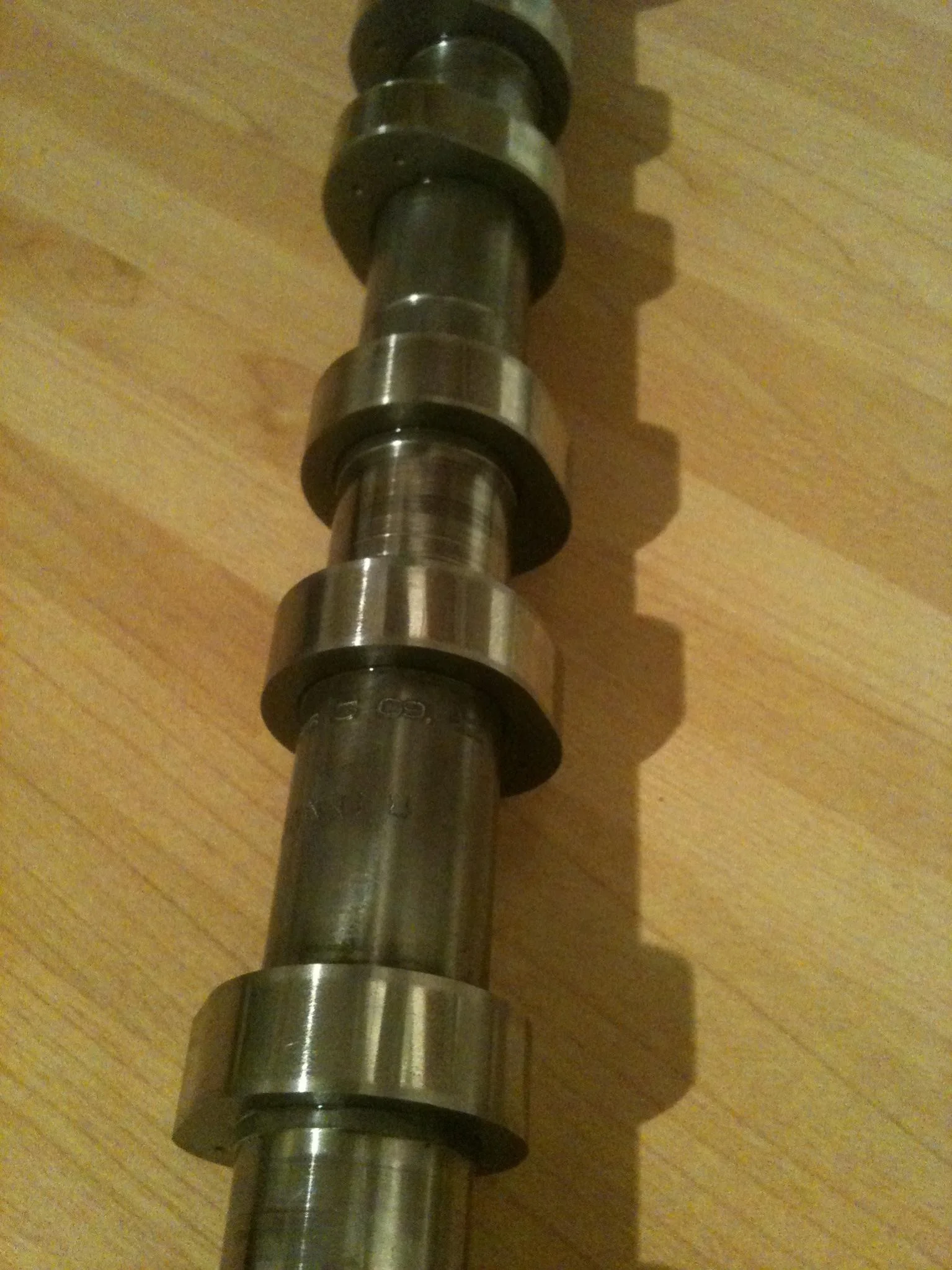

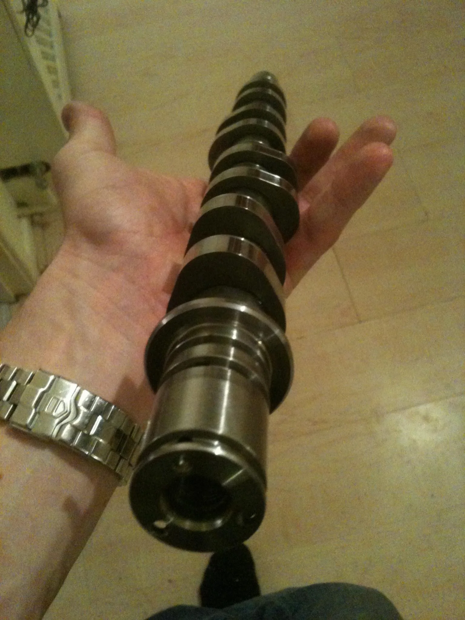

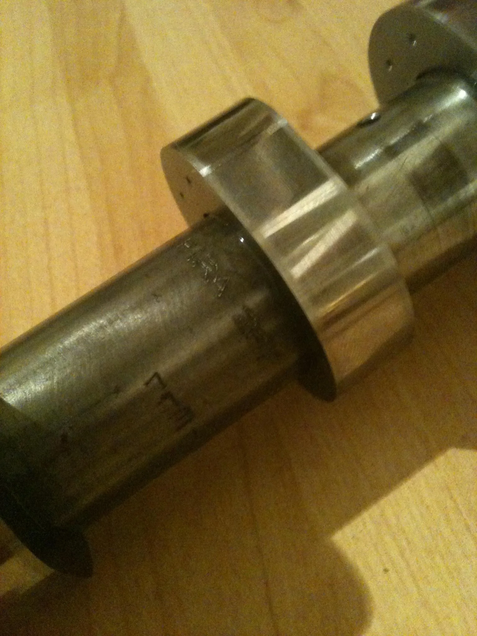

What's the visual difference between STD cams and updated cams in a Clio sport? Basically Ive bought a Clio sport as a non runner and were replacing the engine, the original engine is supposed to have race cams but have no proof, there is no major markings on the cams. How can we tell the difference?

Stock cams have the nocks pressed on to the shaft and all aftermarket cams I know of are of billet type (made out of one solid metal piece) Other indications vary from cam to cam,

iPhone pics sorry, but these are standard 182 ones

what do you think then? i tried to show in the 2nd pic the only writing on the cam at all was those numbers....
