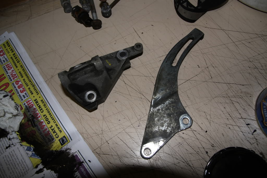

I took two rubbish pictures of the parts i think i need to delete the AC & PAS. Can somebody confirm that these parts will fit the F4R engine.
First is the bracket
It seems to be longer on the left hand side compaired to this part which is from the Mk1 clio.
Will that be an issue and can i just cut through the excess and round off the sharp edges?
The next part is the Tentioner, its a really bad picture because i was in a rush to get back to work :(
It sort of looked similar with the long cut out for the alternator to go up/down.
And also looks to have similar bolt holes.
So will these parts fit, both or just one?
Thanks
Looks different to what most use, as you say there's more there ( looks like a factorty fit engine damper.....COOL ) i belive it would fit though
