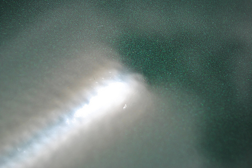

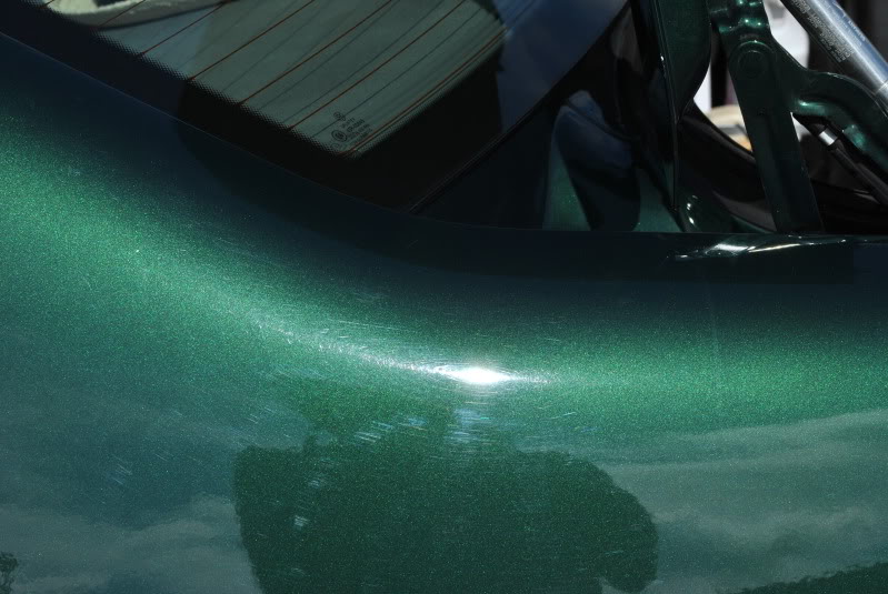

The whole car was covered in this level of swirling, as well as some random deep scratches (RDS) over the doors and bumpers.

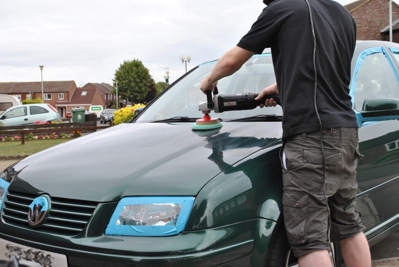

Seeing as I only had 1 day to complete this and the main focus was to remove as much of the damage as possible (coupled with the fact they aren't exactly the smallest of vehicles) I played around with a few combinations, but decided on the SIM180 with 3M Fast Cut plus and a green Hex-Logic pad.

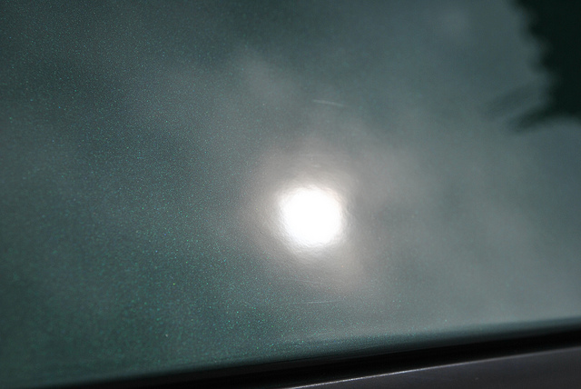

This combination produced a great level of correction:
(the almost horizontal line half way up the pic is the residue left from the tape for a 50/50. You can see the odd RDS, but as I said (and Ads knew) we couldn't achieve 100% correction in 1 day).

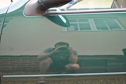

The whole car was attacked in the same way:

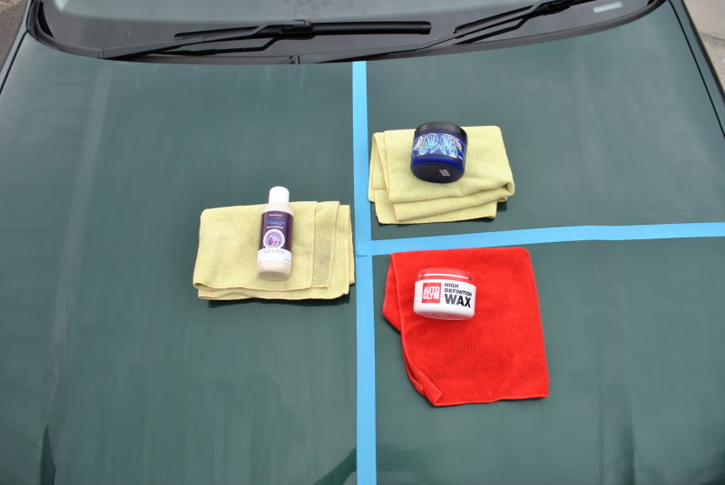

At around £30 for 200ml I put it to the test against 2 competitors of around the same value (£29-32); Dodo Juice Blue Velvet and Autoglym HD wax (both, in my opinion, great products that I use regularly)

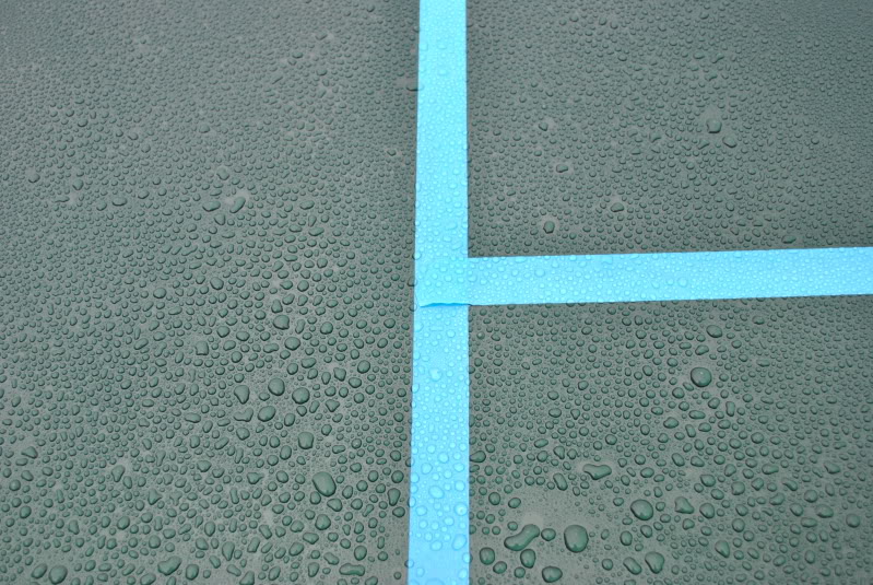

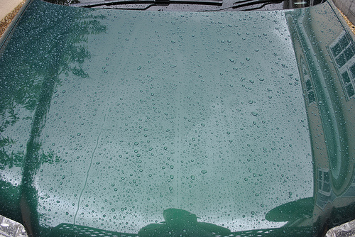

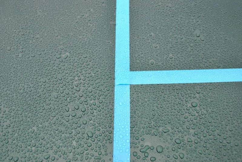

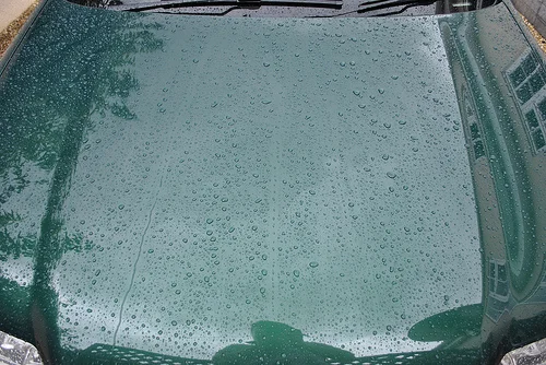

The bonnet was taped up to allow the nanowax to be compared to both BV and HD side by side:

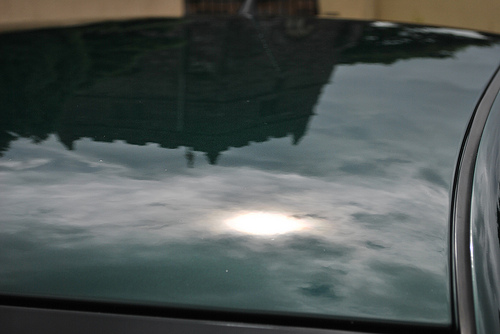

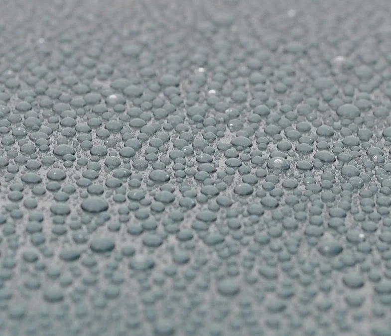

As far as being a wax, it beads just as well as the others:
Beading on the roof:

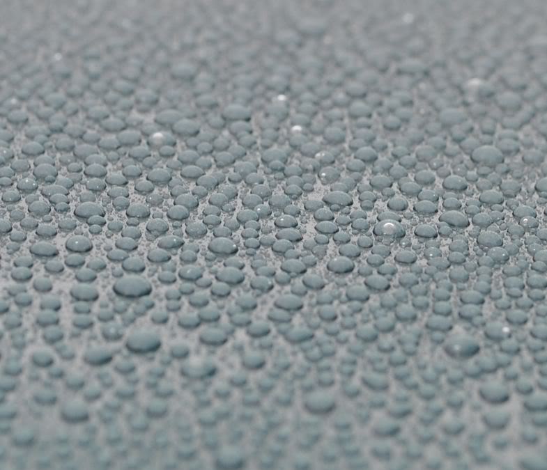

and a close up:

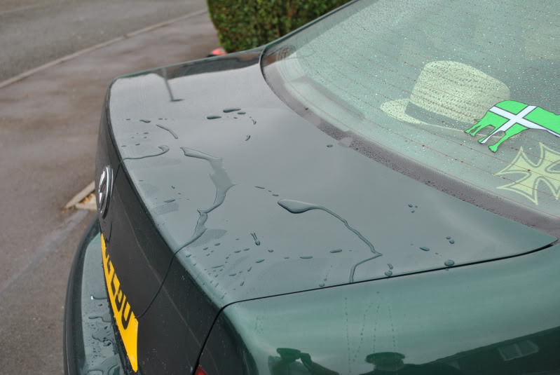

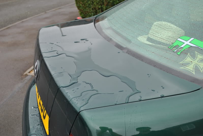

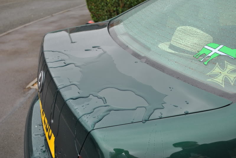

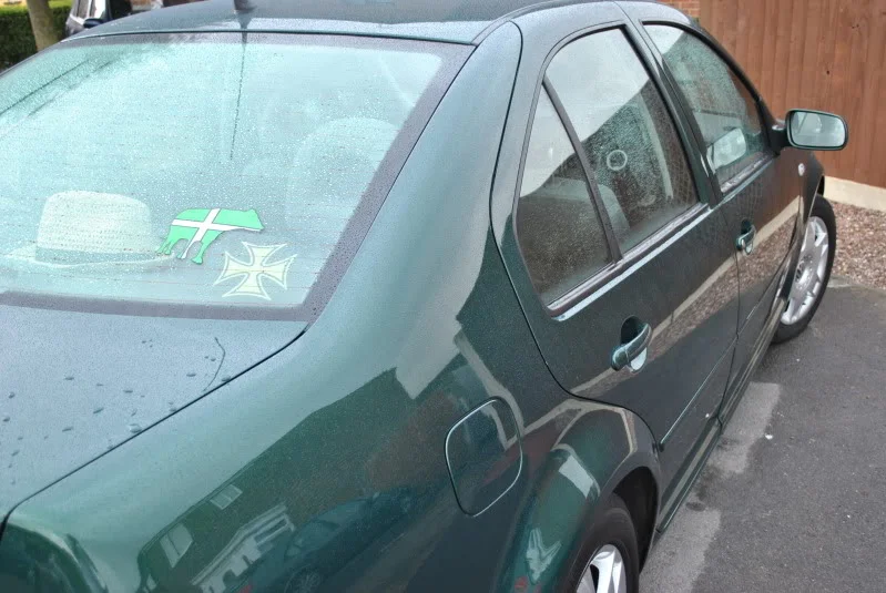

And as far as being a sealant, it sheets VERY well:
(remember, the boot of a Bora is basically flat, so no angle like a bonnet for the water to run down)

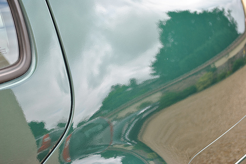

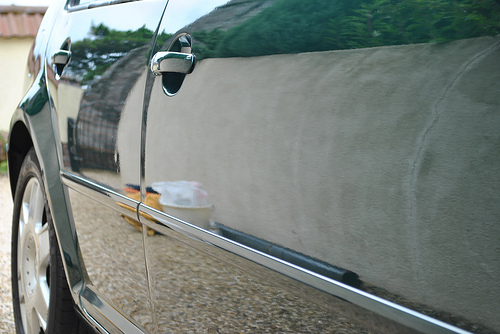

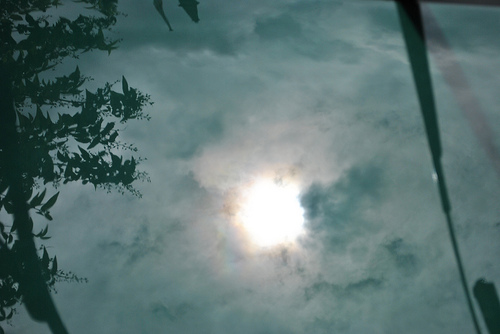

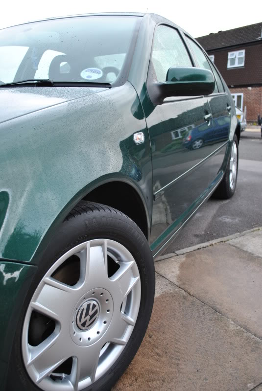

Here are a few pics of the car finished (yes, it did decide to rain just as we'd finished):

TBH Jim it produced great results. Obviously it hasn't got the high gloss that a finishing combination would have, but Ads' main concern was removing the damage.
I used the Zennith Technique to get the best from the FastCut+ and with the nice creamy wax the car looked great. Shame the sun went in literally 15 mins before we'd finished, but Ads' has said when he's washed it and there's some sun about he will take a few more shots, so I will update this.

The rain kind of deceived the results at the time and the car being dirty straight after meant I couldn't really see the difference that Mark's work had made. Now that she's clean again the difference in the depth of finish is really quite staggering.
