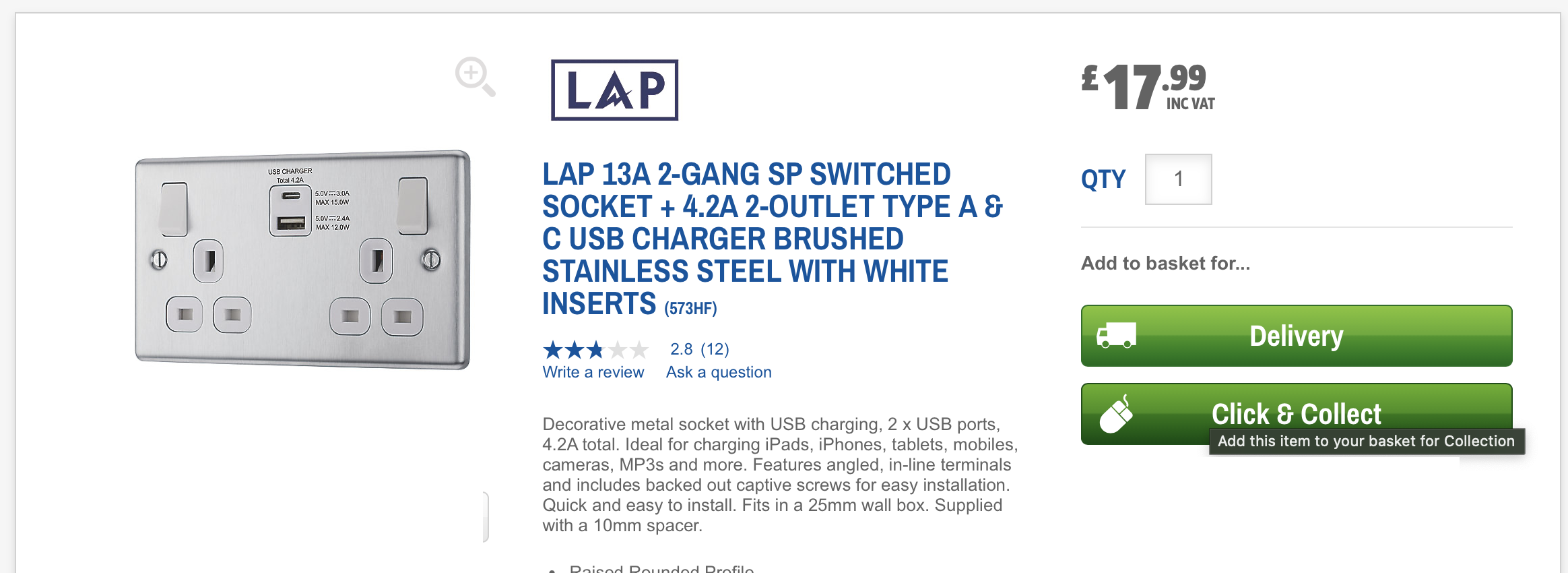

Had a spark out and changed all my sockets in the house for a double standard wall socket with USB & USB-C outlets a few months back.
Tried to charge my iPhone 15 with them and nothing, So asked the spark to come back and check them and the spark was out this morning.
We used a LAP (Screwfix), Click Mode, & BG double socket, All of them charged 2 different Samsung phones with a genuine apple USB-C cable, A Genuine apple USB-C Thunderbolt cable and a generic USB-C cable from eBay but none of them managed to charge the iPhone 15 or my Apple Watch Ultra with USB-C Charger.

What’s the watt output of the wall chargers you’ve bought?

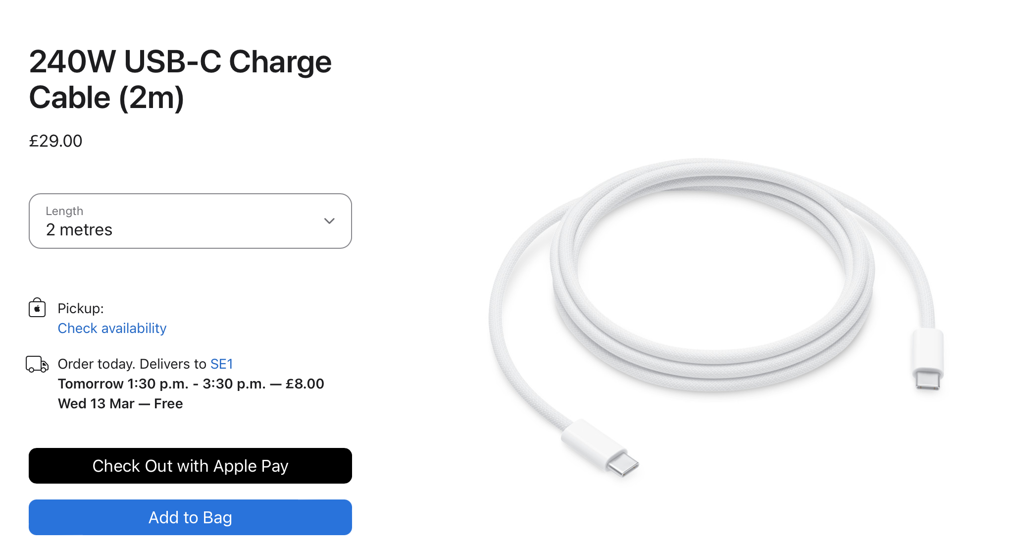

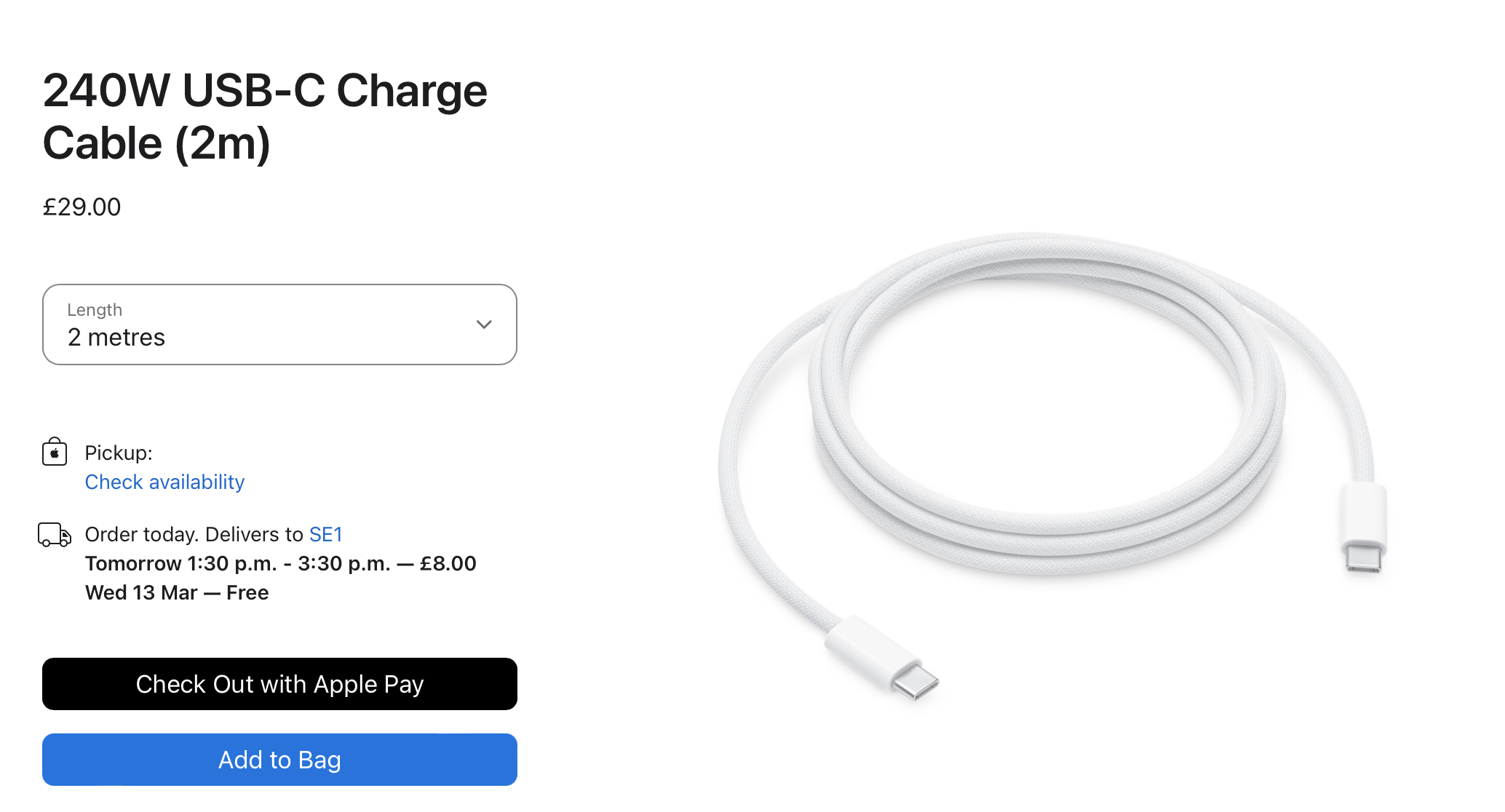

Standard Genuine Apple USB-C to USB-C Cable won't charge the phone.
Standard Genuine Apple Thunderbolt USB-C to USB-C won't charge the phone.
They all work fine and charge / Sync on my MacBook Pro or when I put them into a plug.

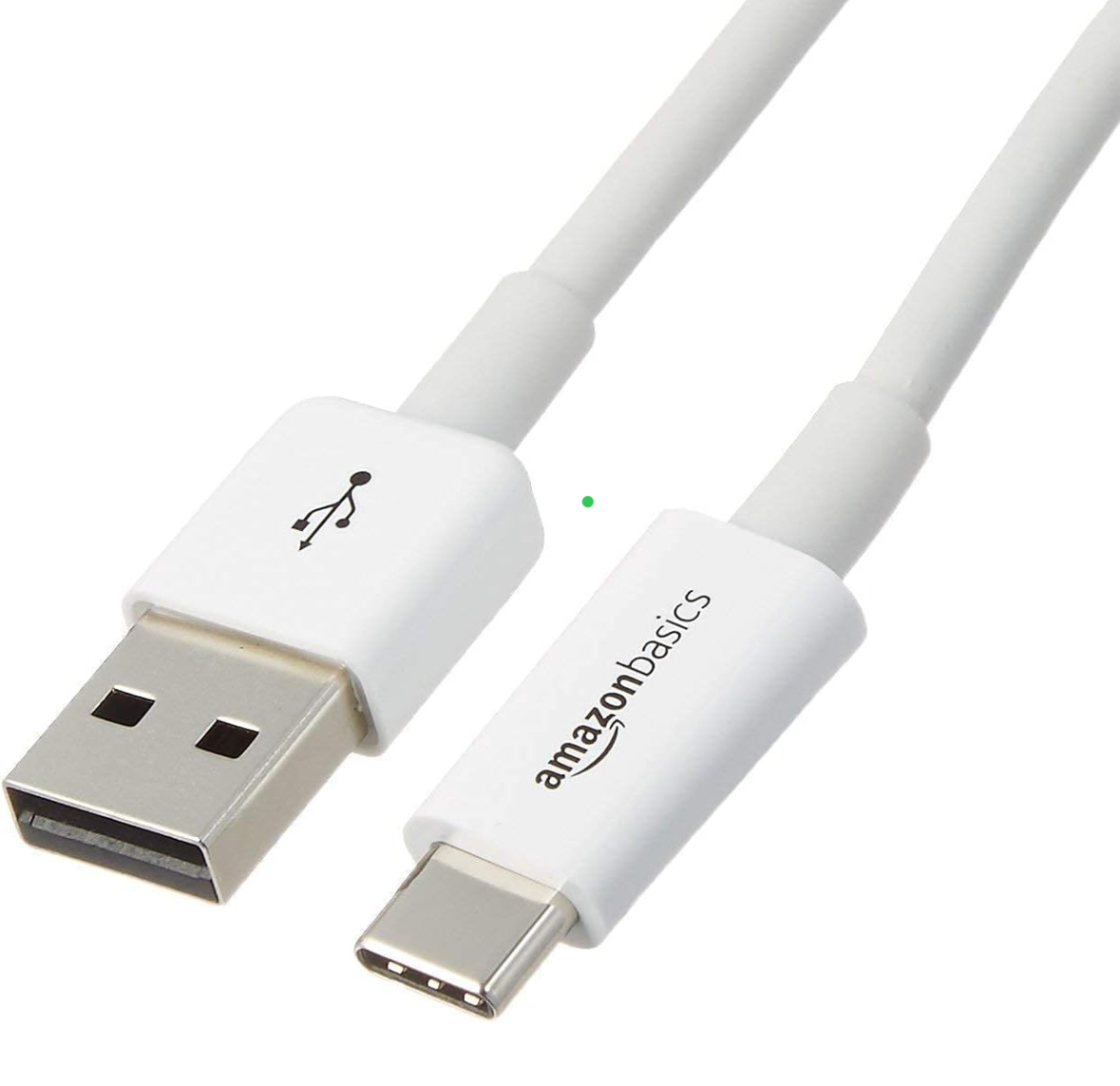

Have you got a usb a to usb c cable? One of these:
Does that work?

This is the exact cable im using.
All cables are both USB-C at both ends.
