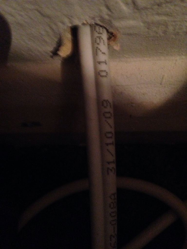

That's the cable as it enters the room.

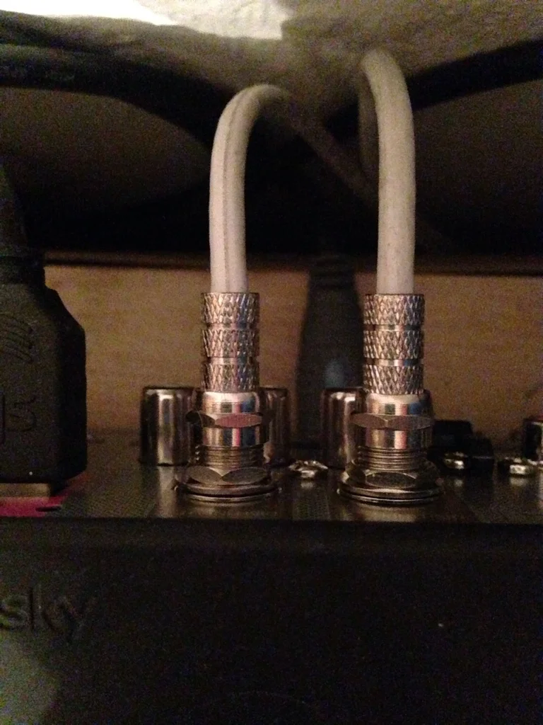

And the back if the box.

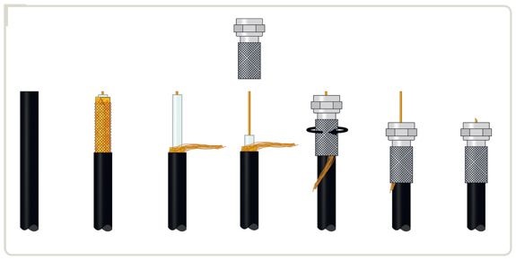

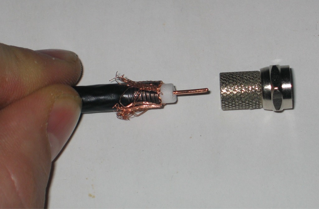

Shouldn't be too much trouble mate. Id pop into Homebase/B&Q & get some 'F' connectors & a couple of F's. Grab a length or 2 of the twin cable for sky plus & away you go! Fit them like this, pop the coupler on & your good.
Edit: You could use eBay & the first link as above, but if it was me I couldn't be bothered to wait for delivery & would go to B&Q lol.
  Clio Sport 172
Yeah it's real easy I did it in my living room, extended it about 7m. As above you'll just need twin cable, 4 F's and 2 F connectors
doesnt make any difference really, the second cable is only so you can record one channel while watching another and also allows the tv guide to populate properly. you can buy either a double cable or 2x single cables. so long as you have 2 cables going into your sky box it'll be fine
