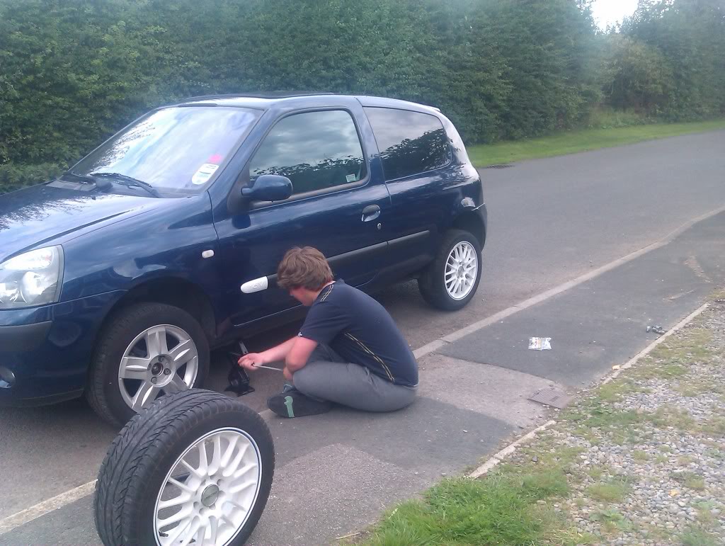

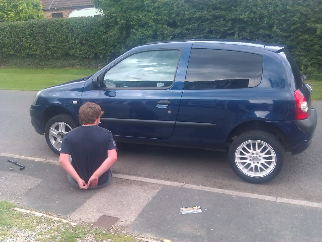

Hey guys, had trouble fitting my wheels, trying to find various things like nuts and bolts etc...anyway, got the bolts i needed and after a while finally fitted my wheels...
however, after taking a drive down my lane, on the way back my brother noticed the front left wheel was wobbling :( i hope the wheel isnt buckled, but cant really think of anything else it could be? HELP? ha

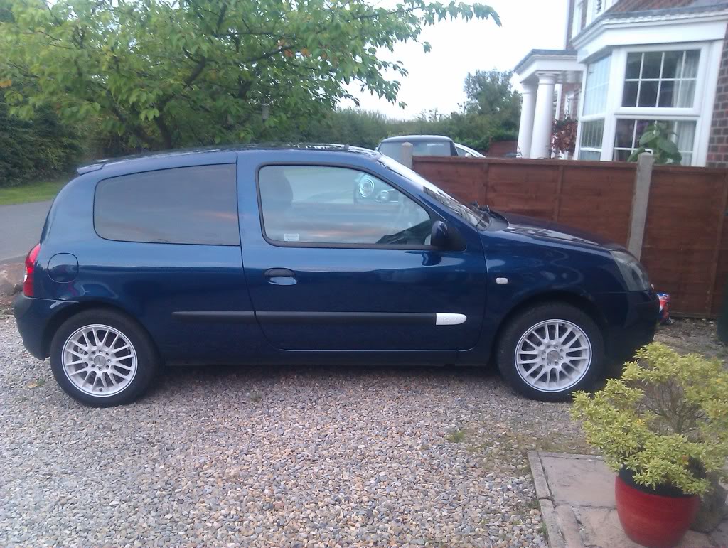

Looks better standard :( New wheels are at least 2 inches too small to be pulled off IMO.
Needs MEGA lows to work.

if anyone can use photoshop, a few different ones of different heights would be muchly appreciated, and anything else you wanna add (colour coding etc)
thanks in advance
