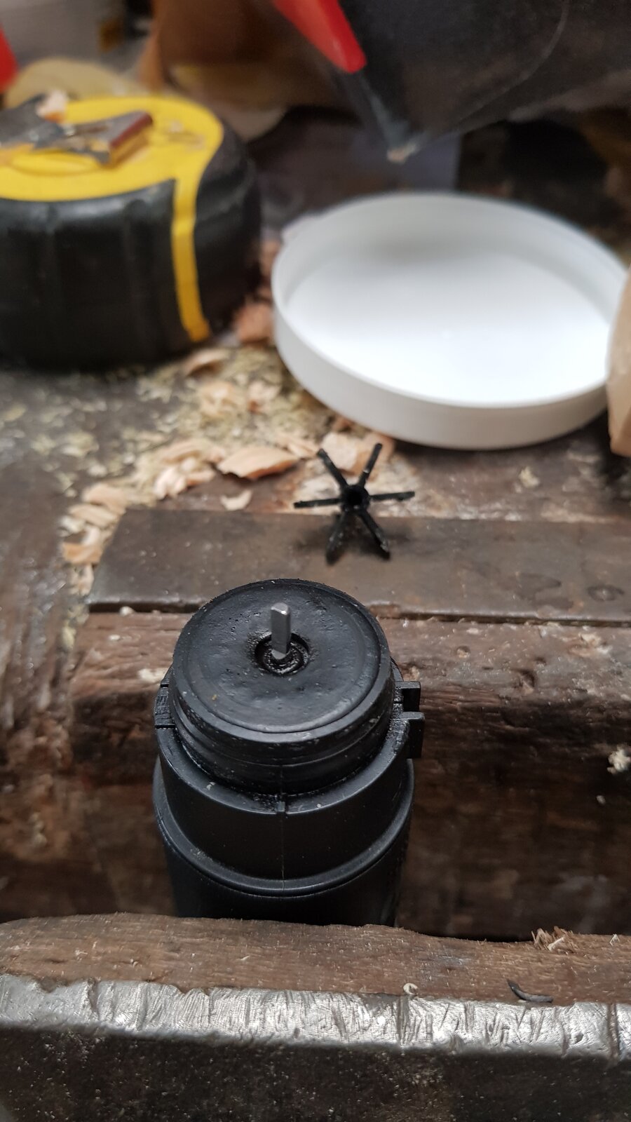

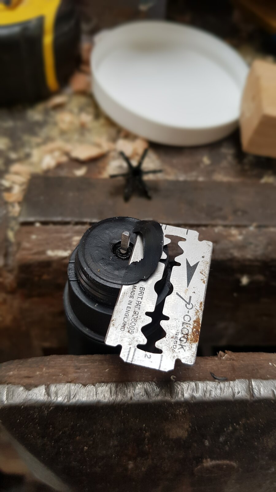

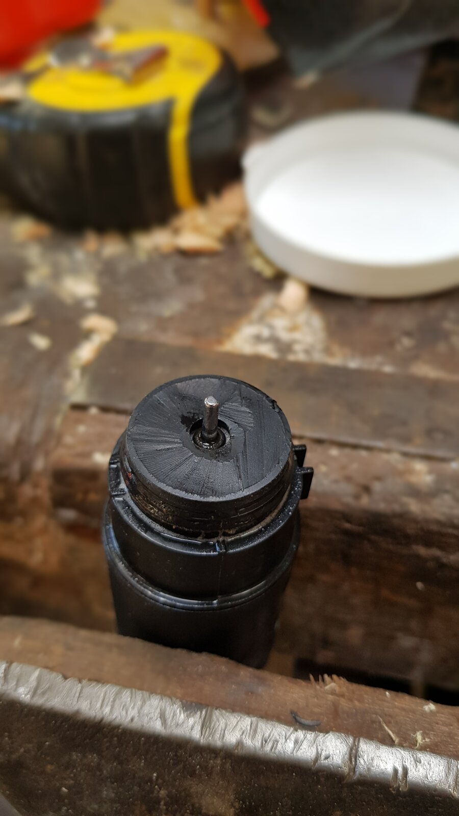

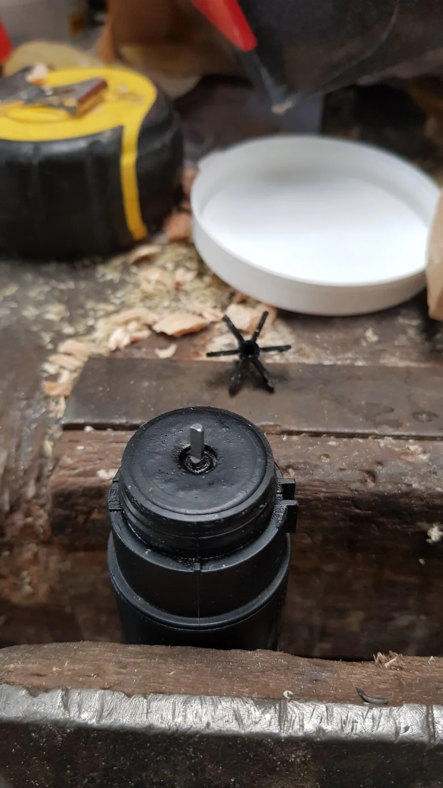

@Amos91 solved it! I thought theres nothing to lose in pulling one of these pumps apart, so pulled the cover from the end with the inlet and outlets on. You know the well known fix for the valve, well it would appear that a similar issue is what causes the pumps to fail. The impeller sits over a seal that over time swells and presses against it preventing it from spinning so I shaved it flat with a loose razor blade, reassembled and hey presto, all sorted!
