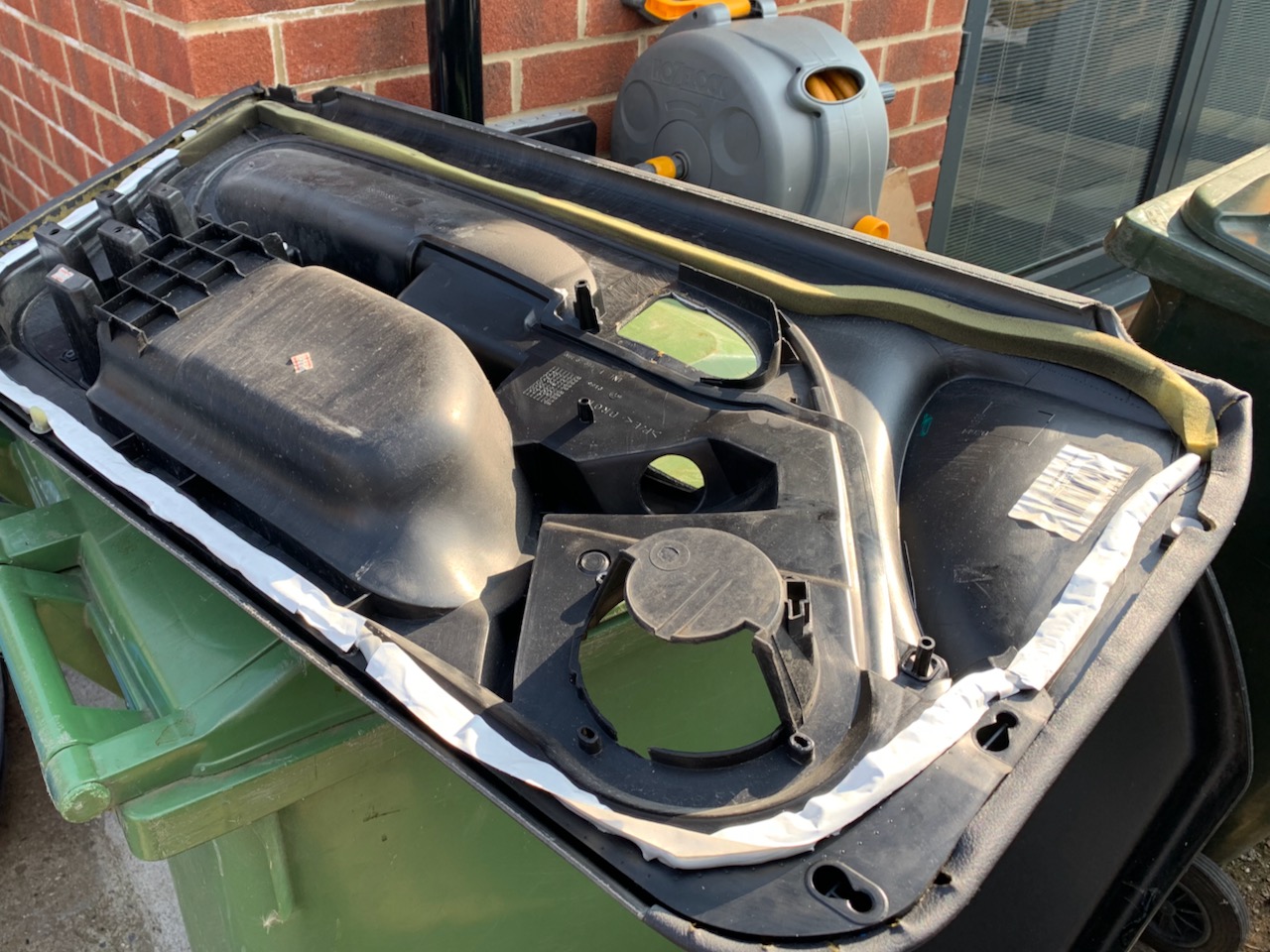

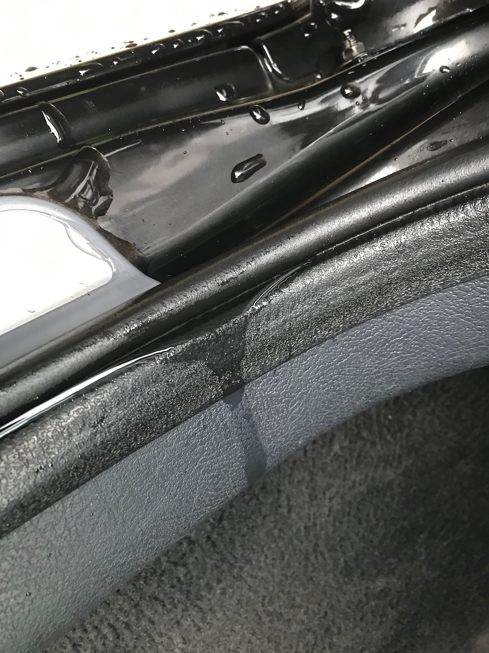

Mine came through the door card. Telltale signs are water sitting in the rubber with a line of water dripping into the footwell.
The solution was to take the door card out and reseal it with Butyl tape. That wouldn't explain why the sill is filling up with water though.

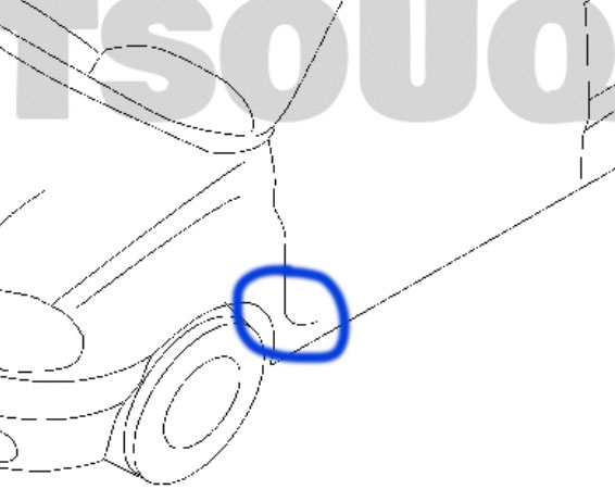

Some holes are at the bottom of the door panel - near the UCH - that's quite a vulnerable area.
Water can reroute if there's blockage around there, water can access the sill.
