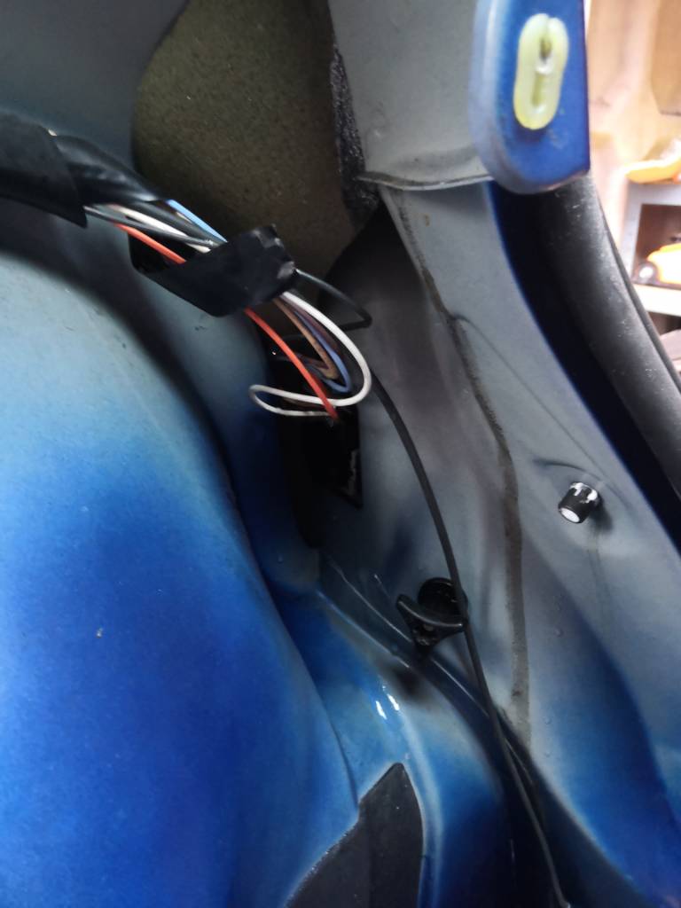

Hi all,
I've got water pooling up under my rear bench and having trouble locating where the water is getting in from. It looks like it's coming in from the c pillar, trickling down from the punch weld quite high up, moving along the carpet and then down under the rear bench. Problem is I can't figure out which pinch weld it's coming from, if it is even that?
Hoping someone else has had this problem so I can identify the problem area.
You can see the brown stain on pic one where its coming from.

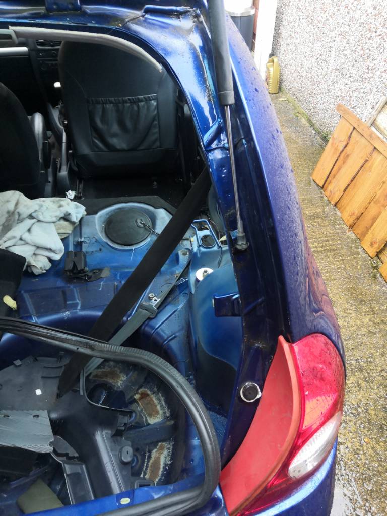

Pic of outside if it helps at all

You can see in the first pic there's no water around the light fitting, the waters coming in from above the light fitting
