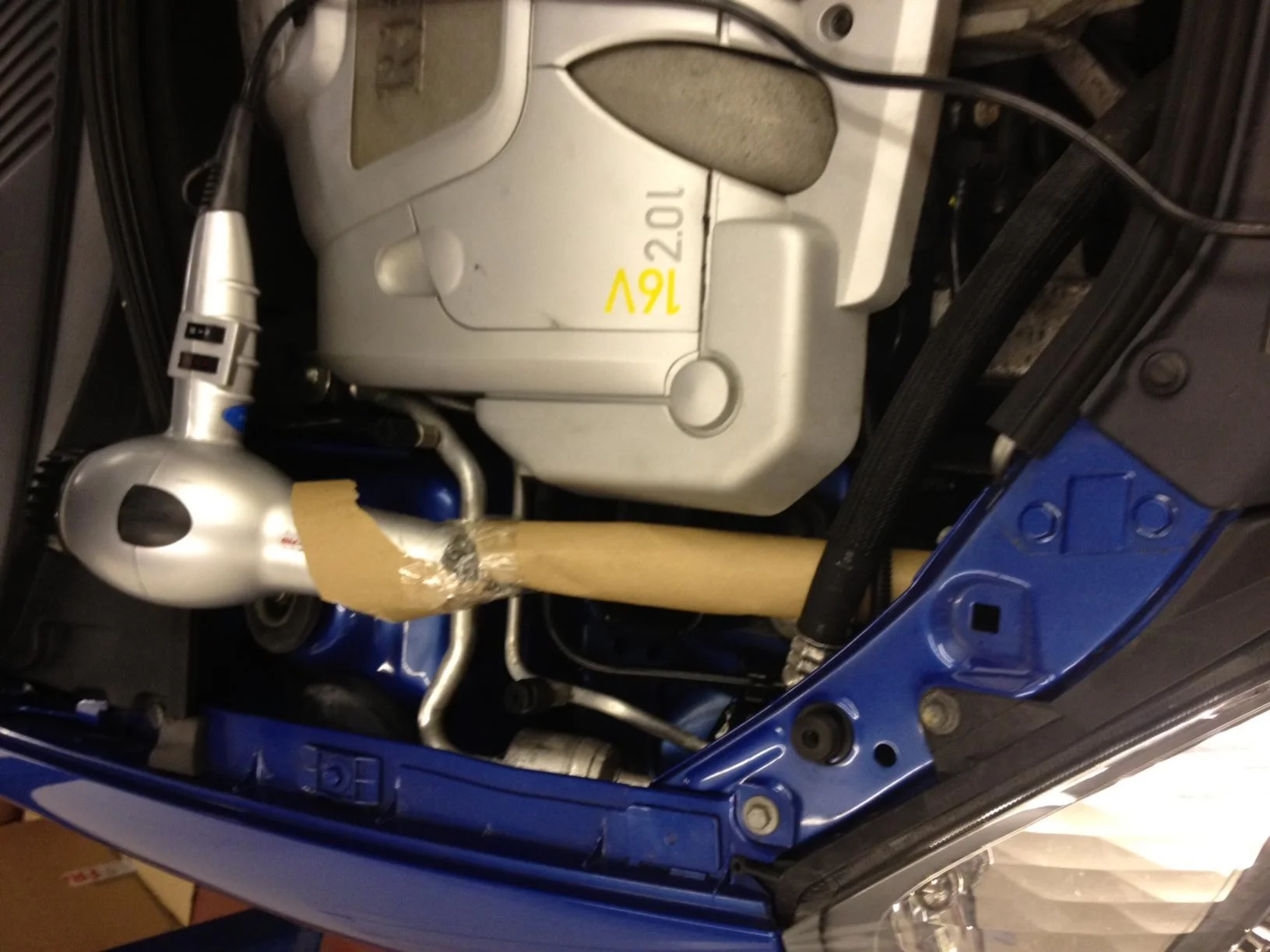

After installing my LED sidelights I didn't put the rubber seal on properly and therefore got water / condensation got inside the headlight. So so very annoying.
This was my fix and it worked a treat. 100% clear now :
Don't know why the post has rotated the image.
