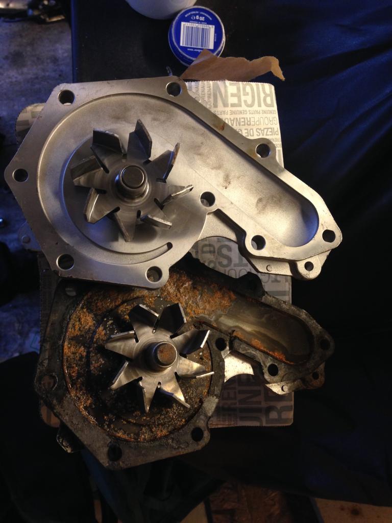

The gasket was all broken up on mine & mostly stuck to the pump. One of the bolts rounded off so I had to remove the head off it then get the thread out last. Hunting for a bolt before I fill it up again now!

Filled it up with water and it leaked, so took it back off again and managed to split the gasket.
Going to get a set of M7 bolts and a new gasket tomorrow and tackle it again, I'll get it right this time! Lol
Only took me 25minutes this time to go from it running to removing the pump :)

Just recently did mine, come to fill it up tonight ready to start up after a full service and some other bits, and mine too started pishing out water [emoji20] . No time tonight to remove it (and I agree it is a ball ache of a job), but just in case I need one, where do you get the separate gasket from - can't see any on eBay or ECP, is this a dealer only then? Got to get this thing ready for an MOT next Sat [emoji26]
Yep, well I totally screwed up the first gasket, live and learn as they say. Hopefully got another coming today from Adam @ Renault Wolverhampton. I can't get to an ECP or similar during the week to get some gasket remover, can anyone suggest what else can clean the old hardened gasket off which I'm still finding traces of?
Also, I'm guessing no additional sealer should be used given how well this stuff sticks?
if it makes you feel better I did the same, I just used a Stanley knife to clear the old gasket.
I also used a dab of loctite blue, it's like a gasket sealant that doesn't go off iirc.
