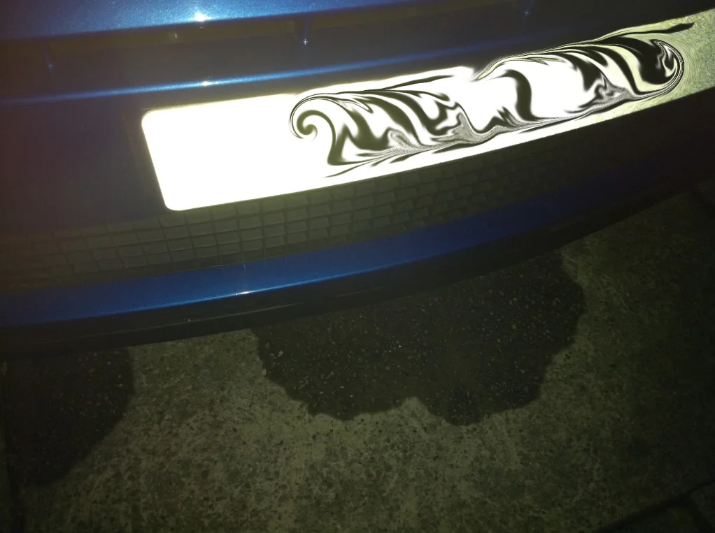

noticed over the past couple of days water under the front bumper only its not coolant as im not loosing any and it doesn't smell & its clear not green like the coolant in the bottle it seems to be dripping from the splitter area :S

no it doesn't smell of anything could it be rain water like you said it rained yesterday & a little today i have been to work in it today so its not like its just sat there but my drives is on a slight slope downwards so it must be storing it somewhere i have had the car just over a month & its not happend before :S

No I have aircon. Weird how it's not done it before though, it's actually dripping off the splitter

Could have been a build up in ac drain tube and now it's decided to do it's job. I would go with that personally

looks like it is windscreen fluid as i filled it up this morning & its gone done about a couple of inches in the bottle now

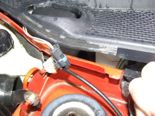

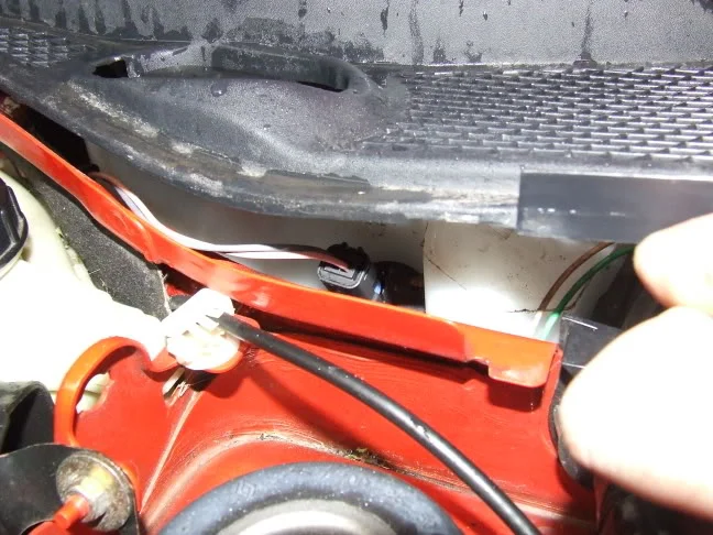

Right so i took the bumper off this morning to see where its coming from & couldn't see anything both rads are bone dry all i could see was what can only be rain water stored in the bumper the washers weren't leaking from what i could see but i disconnected the pipes anyway & bunged them up do i need to unplug anything on the bottle?

If it's not using any washer fluid or coolant i wouldn't be bothered.
I'd unplug the headlight washer motor to.
  182 FF Arctic
It is using washer fluid but the headlight washers seemed dry Its only happened since I filled the washer bottle to the top The other day

Thats my thread!
Yeah unplugging that, means the light washer won't try and squirt.
