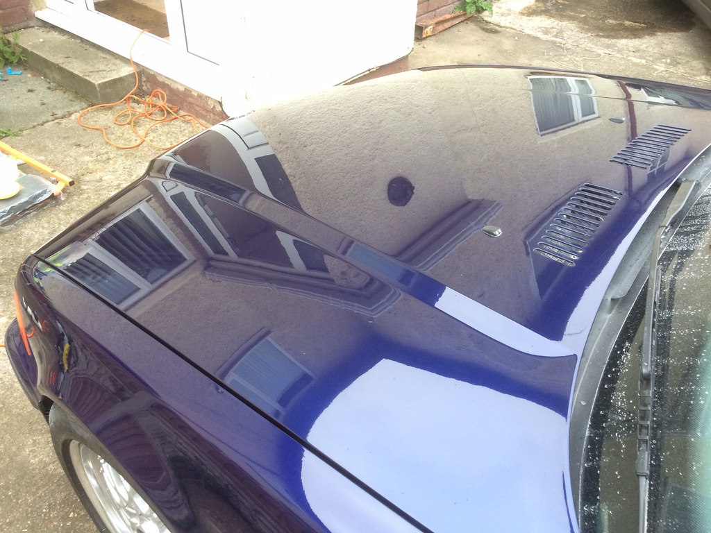

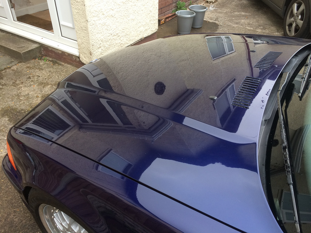

I think it does. I'll see if I can dig out a pic... But as my camera is my phone, I'm not sure you'll tell much. In person though I think it adds a fair bit of depth and gloss prior to waxing.
Not the best pics but before
After
You can see a slight increase in gloss and the orange peel has been 'smoothed' a bit

There is a decent difference there to be fair! Can you inflict scratches with a mild clay bar? Another matter that haha. I'll glaze too haha XD
