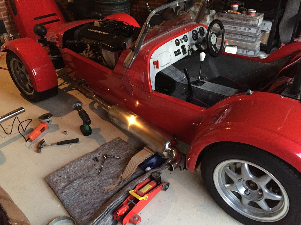

New exhaust trial fitted. Looks and sounds good!

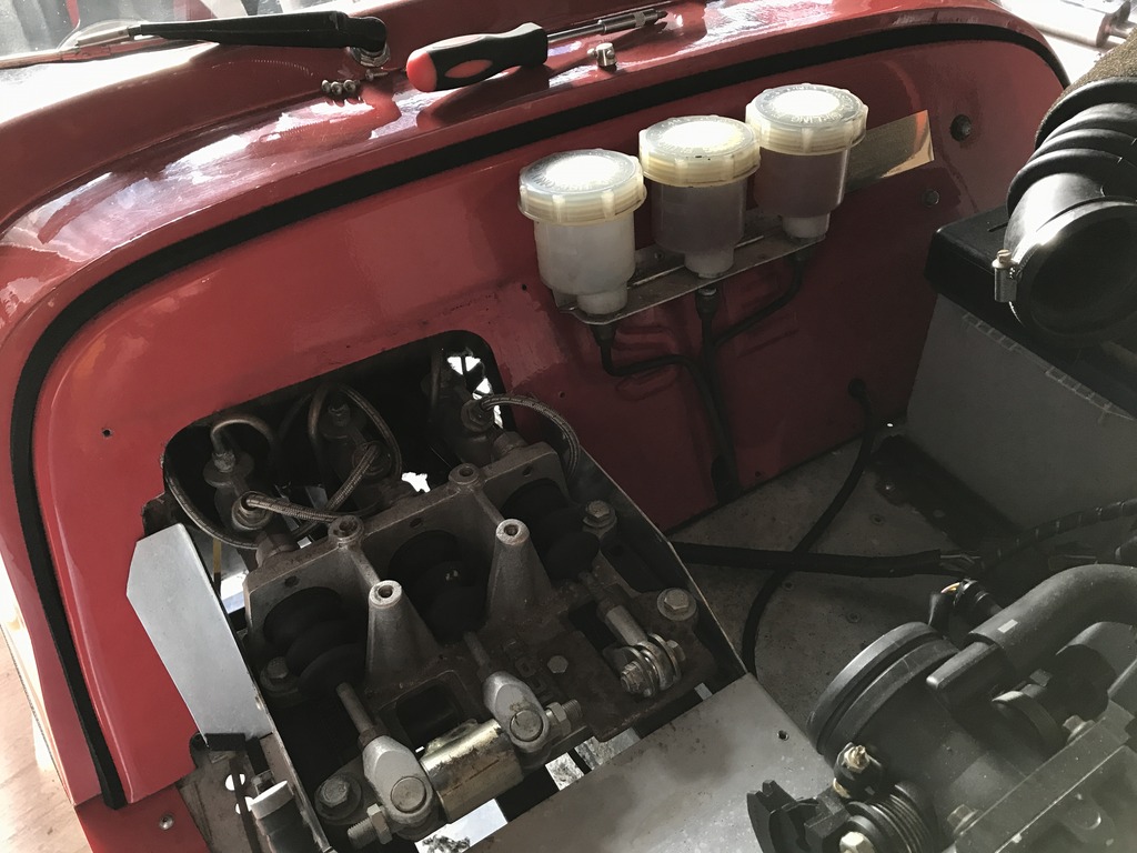

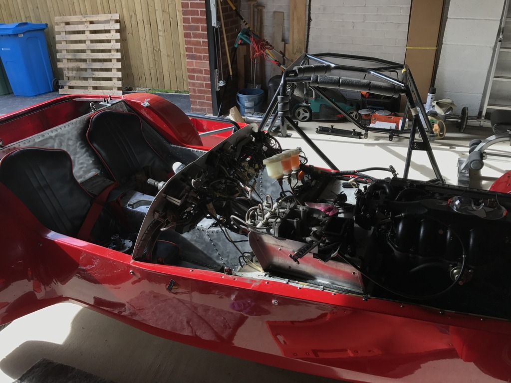

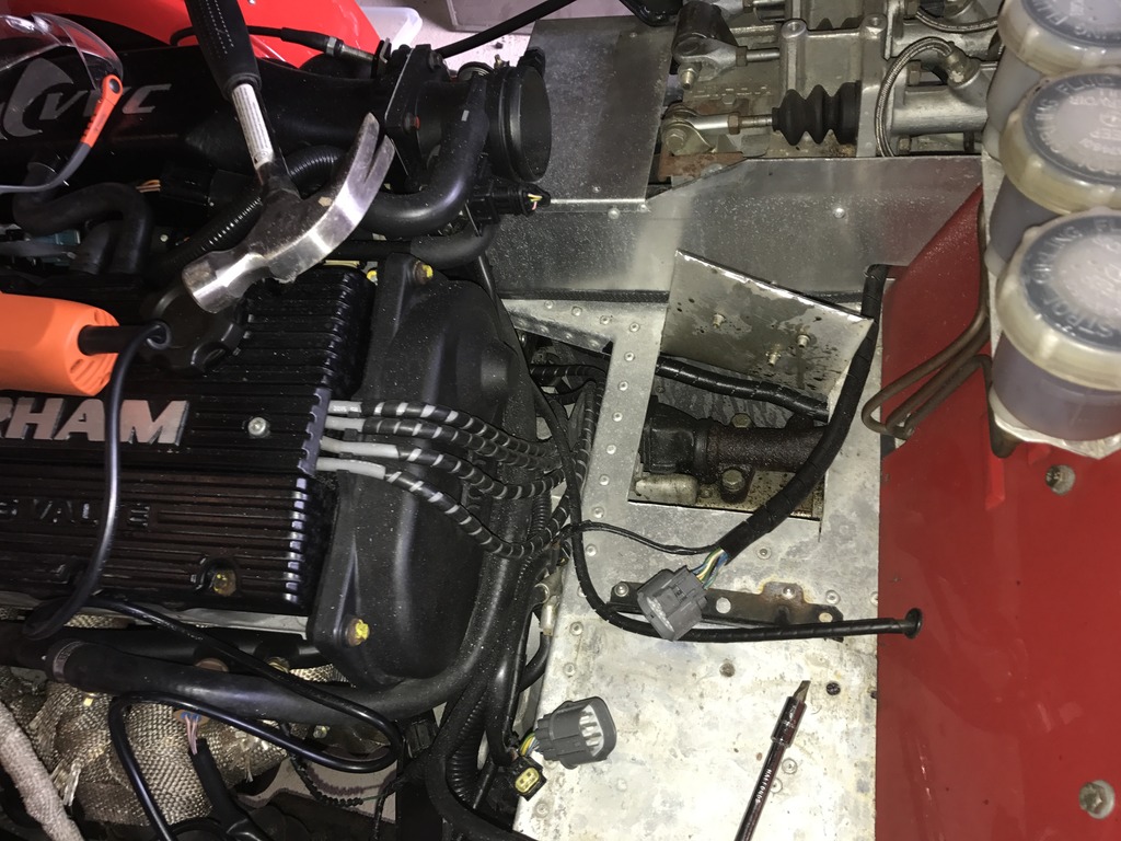

Got home to find this:

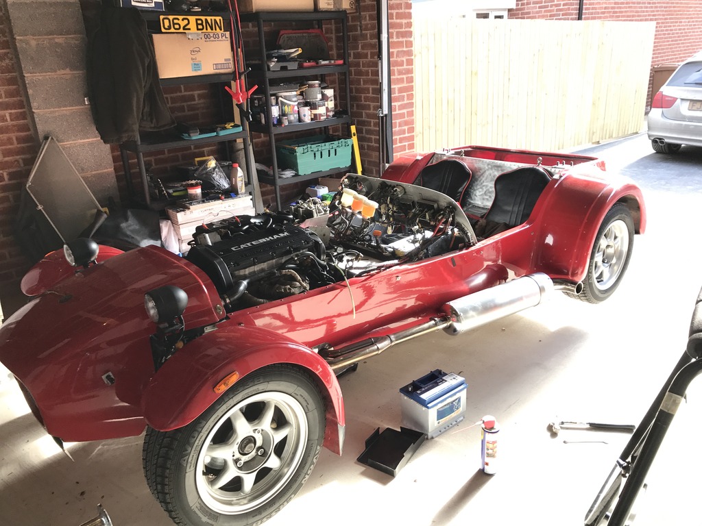

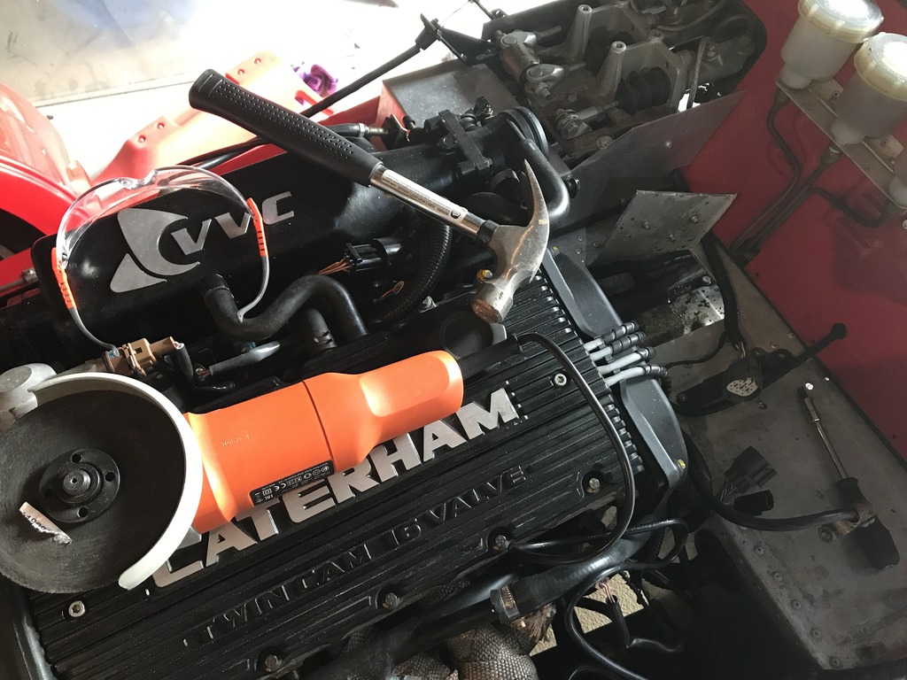

Slight lack of any clutch fluid. Sadly the slave cylinder is hidden under the scuttle. Out came the hammer and angle grinder.
Slave cylinder is now out and the trans tunnel is cleaned up. Had to spend an hour on the net identifying the slave cylinder. Seems it is off a classic mini which is good as a slave cylinder is only £20!
Should be here next week. Forgot how much love these things need.

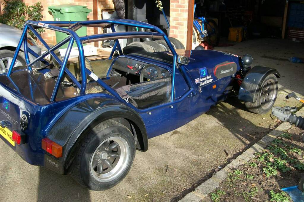

@Waitey I was the man behind the caged cages when Phil and I first sorted them
Lots of bitching at the time within wscc about it and Westfield themselves , then caterham got arsey
That's why the top bars are curved ones caterham and triangulated on the Westfield version
They are a cracking cage , but then you need the fluke caterham aeroscreen

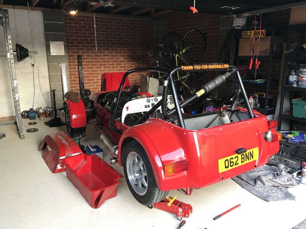

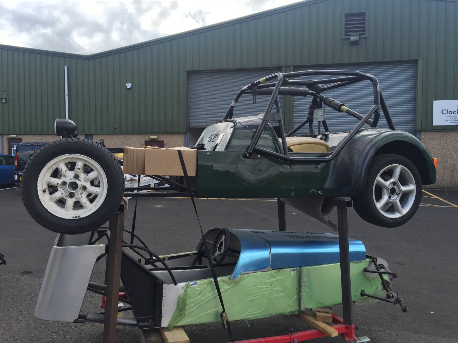

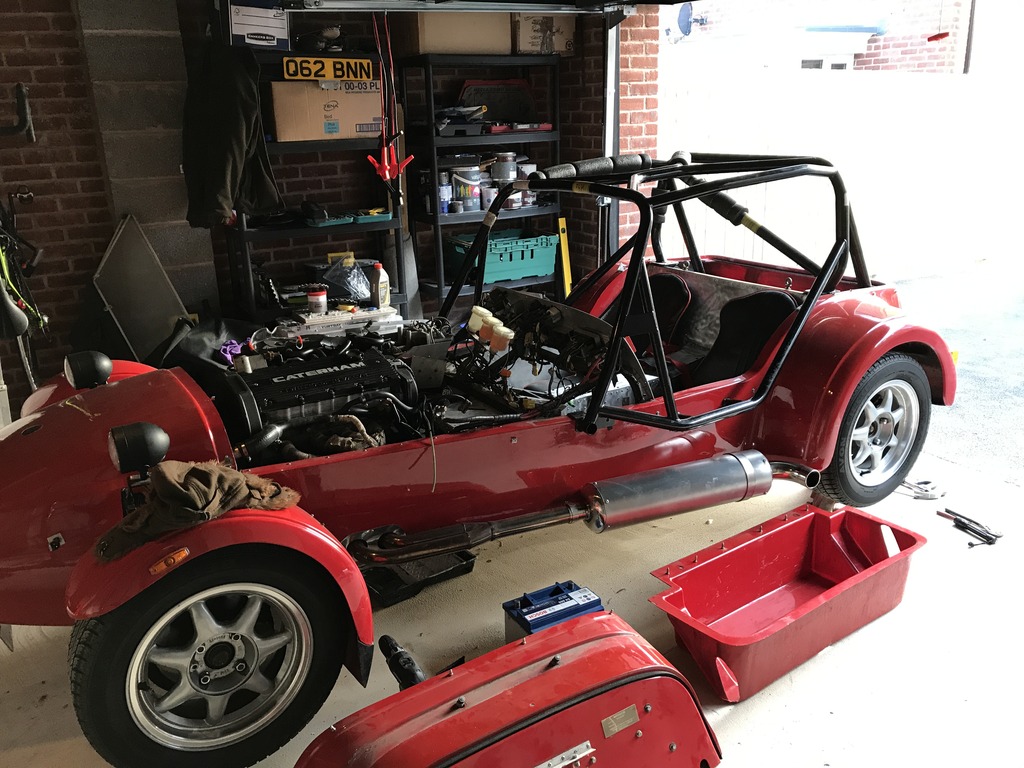

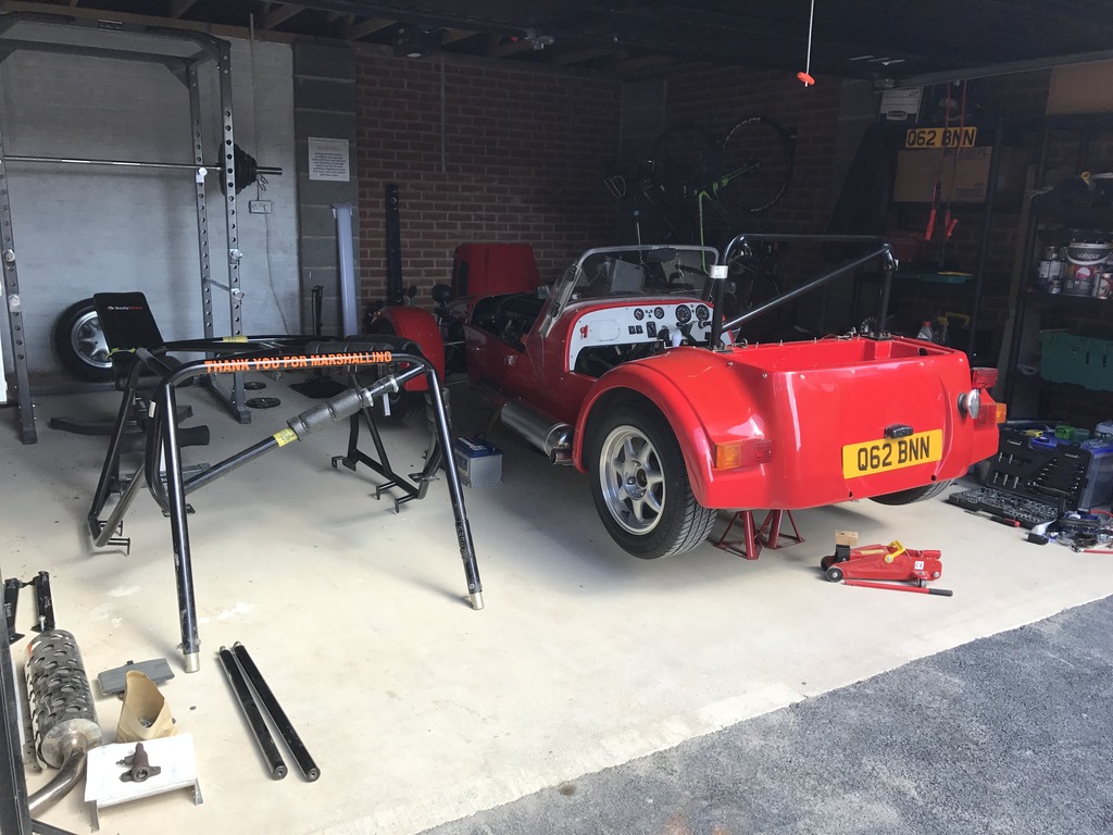

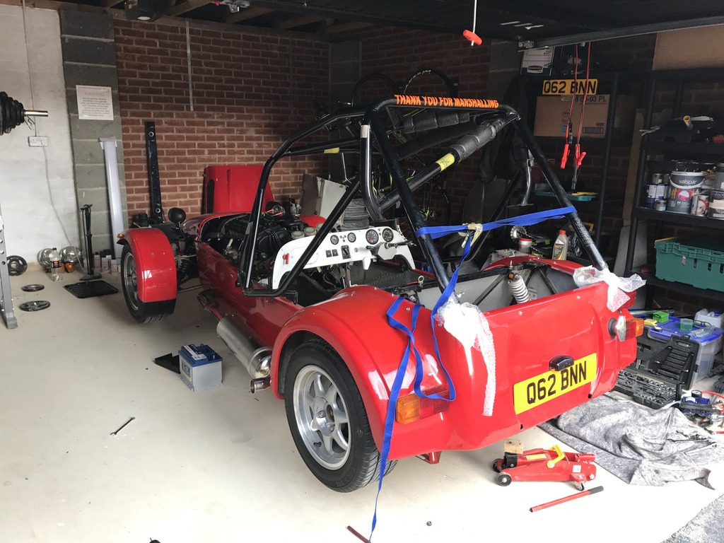

Cage was delivered by its old owner today.... from Scotland! Sod that. Didn't want any money for delivery either.
Set about fitting which is a scuttle off job.
Everyone says its a two man job. Pfft one man and some straps...
On/In and looking awesome!

When it's in can you do me a favour and take off what looks like pipe lagging and fit proper FIA density foam.
You have no idea helmet or not how bad just having pipe lagging is.
Having seen the damage to a skull I'd feel happier .
A length of the right stuff will cost you 20 quid

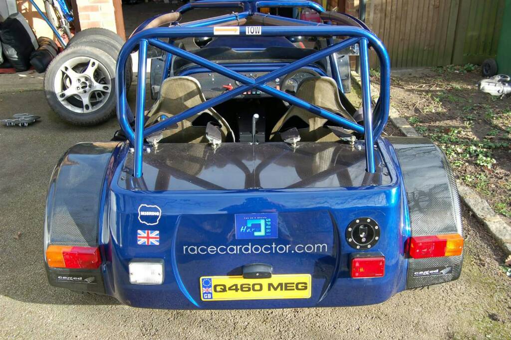

That original .. hoop ? What's the fcuking point. Looks like it will just fold like a soggy newspaper in the event of an upside down.
Caterham ones at least have a pair of bars going backwards off the hoop to suggest some level of a) thought and b) triangulation.
Cage is win tho. Nice one Wait-ey.

The original hoop did have rear bars, I'd already taken them off in that photo. It was an MSA spec rear roll bar.
