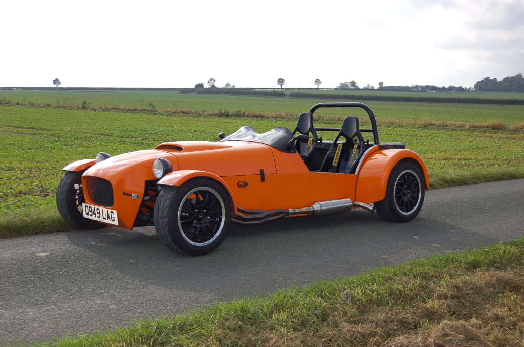

Weekend car - Accidental....
Whose making those ? The doors make a big difference
Downside is having to look like a hero, as you drop from the top getting in
Rather than trying side entry

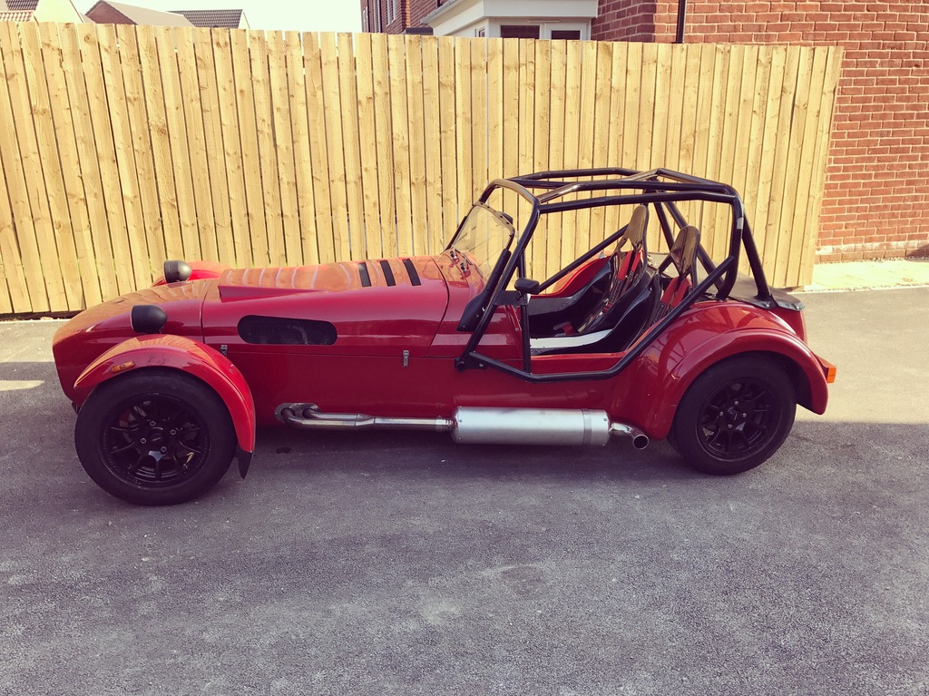

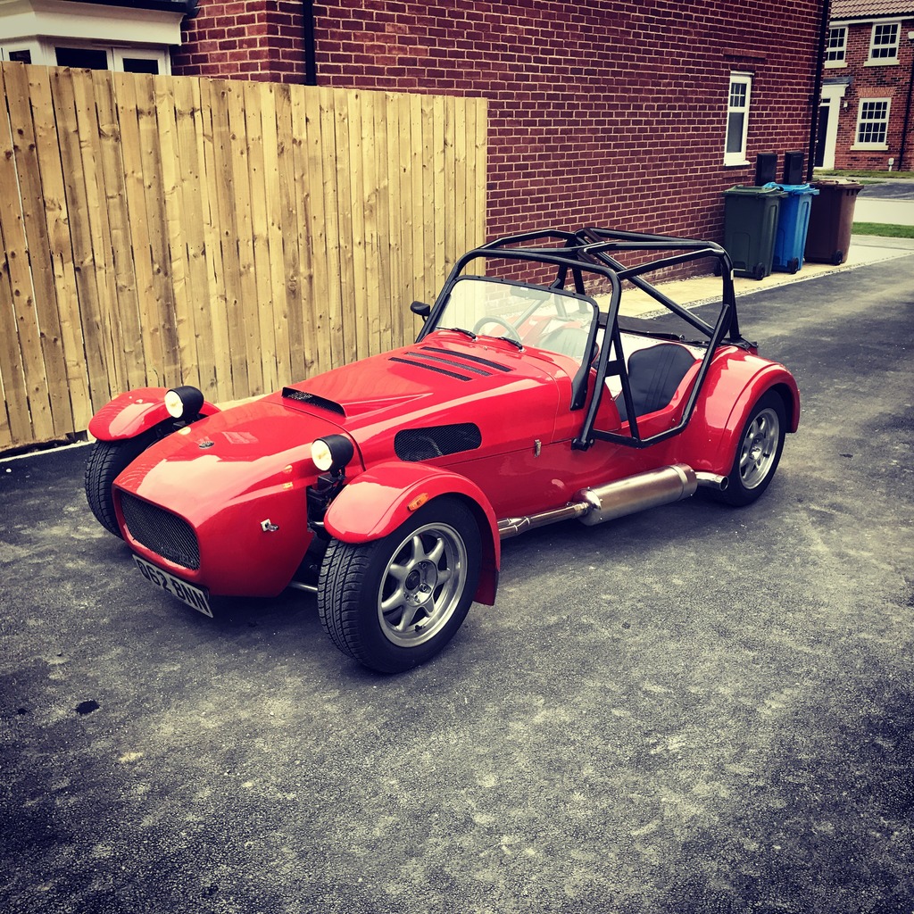

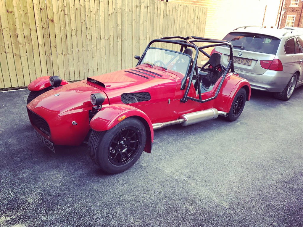

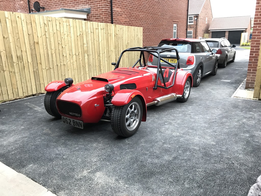

Bolting the cage in is fun. The chassis bends before the cage does. Will deffo need geo after this.

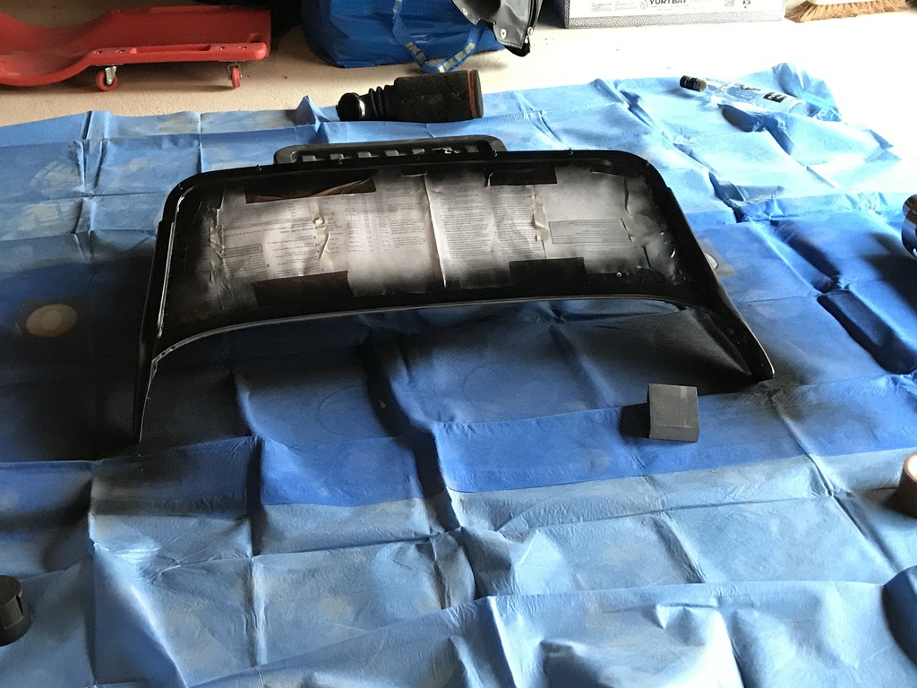

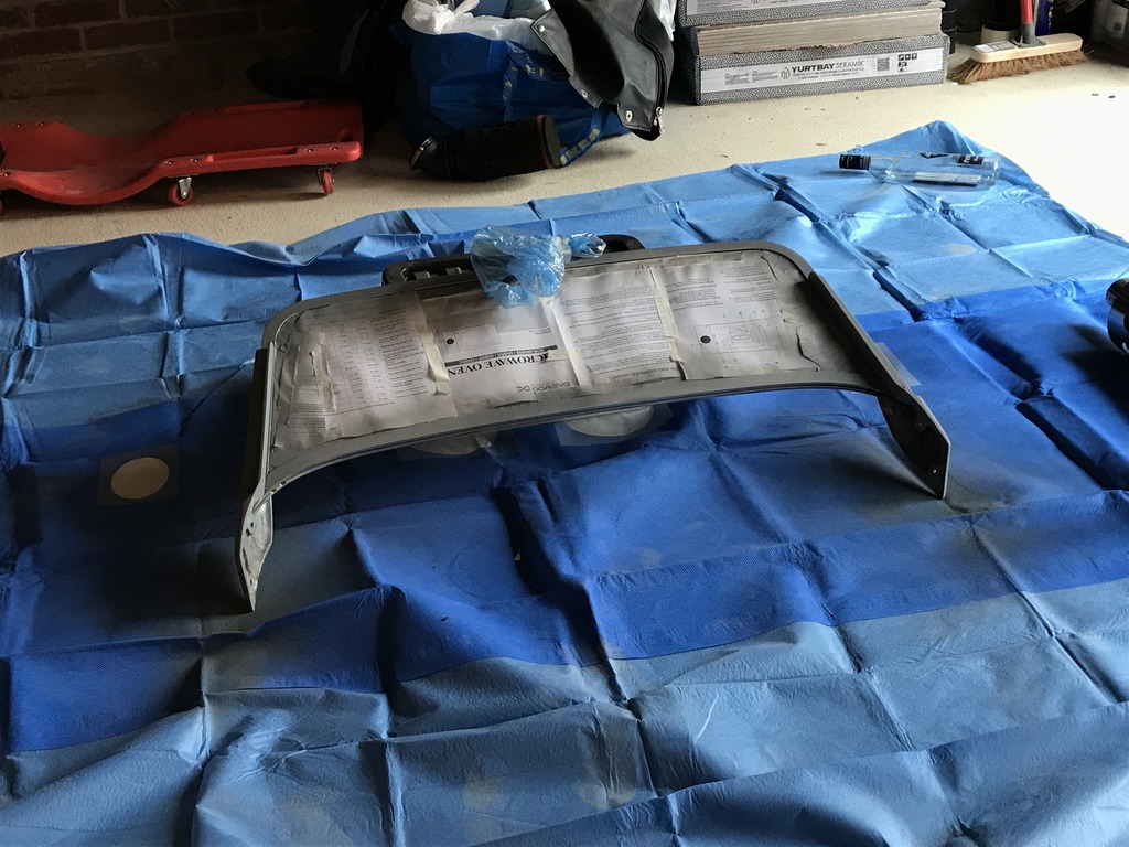

Fully fitted now. Just need to paint my windscreen surround and fit that.
Loving its look now.

What year chassis is it ?
I had lots of extra chassis bracing fitted before I fitted the cage
Sent from my LG-H815 using Tapatalk
'96
This one already had extra cross members in and side bars. It's the front mounting points causing the flex. Really they should mount 100mm further forward then they'd pick up my extra cross member.
I will have a look at putting a hoop over where my knees are and linking the two front mounts.
Mine was braced across there
The biggest issue was the twisting across the front section and the diff carrier
96/97 were some of the best chassis made

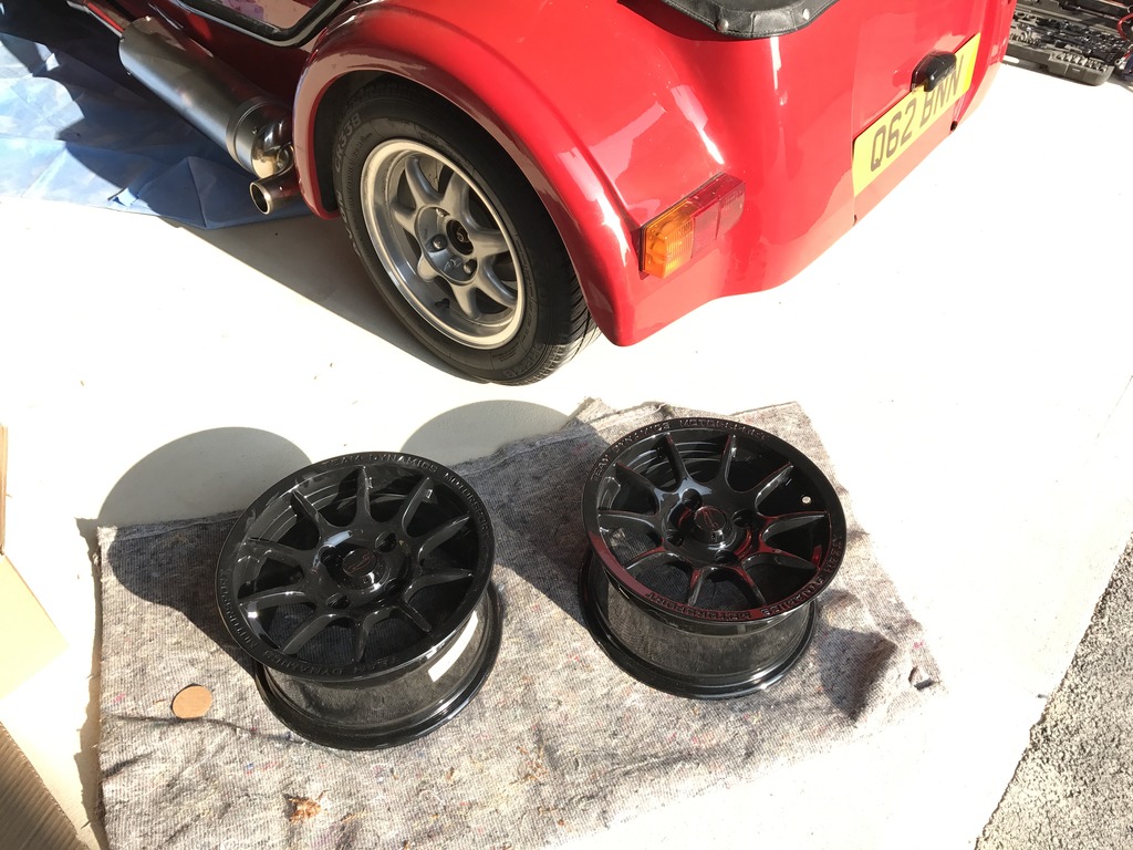

The wheel saga continues.
Ordered Compomotive CXR's = None in stock in the set up I want 8 week wait
Ordered Grey Pro Race 1.2's = None in stock in the set up I want 11 week wait
Ordered Black Pro Race 1.2's = Apparently in stock and should be here tomorrow.....
Not holding my breath. My seats have been 6 weeks so far, and my carbon bits have been 4 weeks so far....
