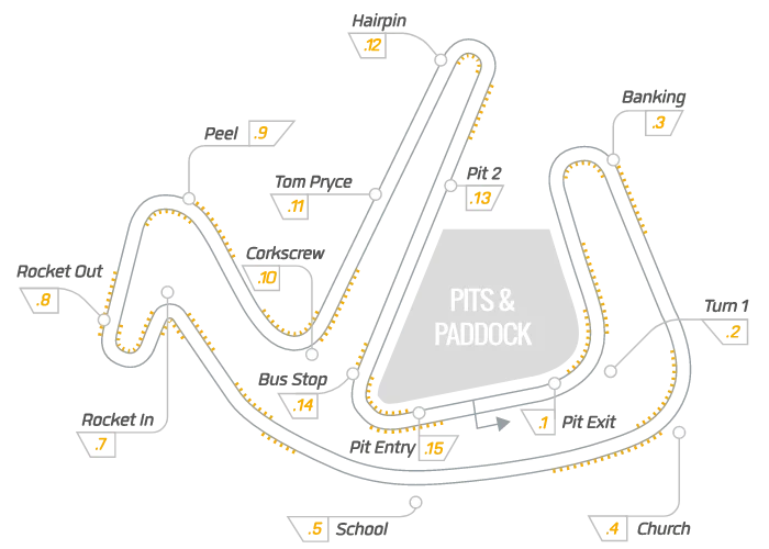

So a couple of weeks ago I did a Javelin track day at Trac Mon in Anglesey.
The day was a bit of a shake down for me anyway, however I had a problem I couldn't sus out.
Now I'm absolutely useless when it comes to explaining myself so please bear with me.
This issue is prominent irrespective of speed, but on the exit of the right handers (Banking, Church, Rocket Out, Peel and the Hairpin) the car would turn in but then suddenly wash out, a bit like it would if it was wet and you just floored it out of the corner. Wheels spin up and naturally the car would "drive" towards the outside of the track, except it was bone dry and it didn't matter if I was on the power or not. Another thing was the steering after each right hander would never actually centre, so the top dead centre marker would be at maybe 5 past or 10 past until you took a left hander. Very prominent after Banking, Rocket Out and the Hairpin.
