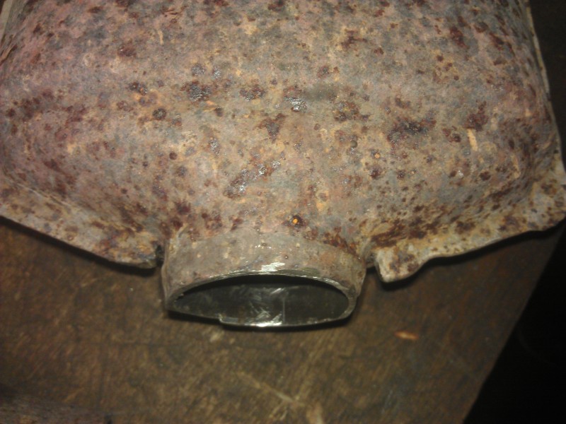

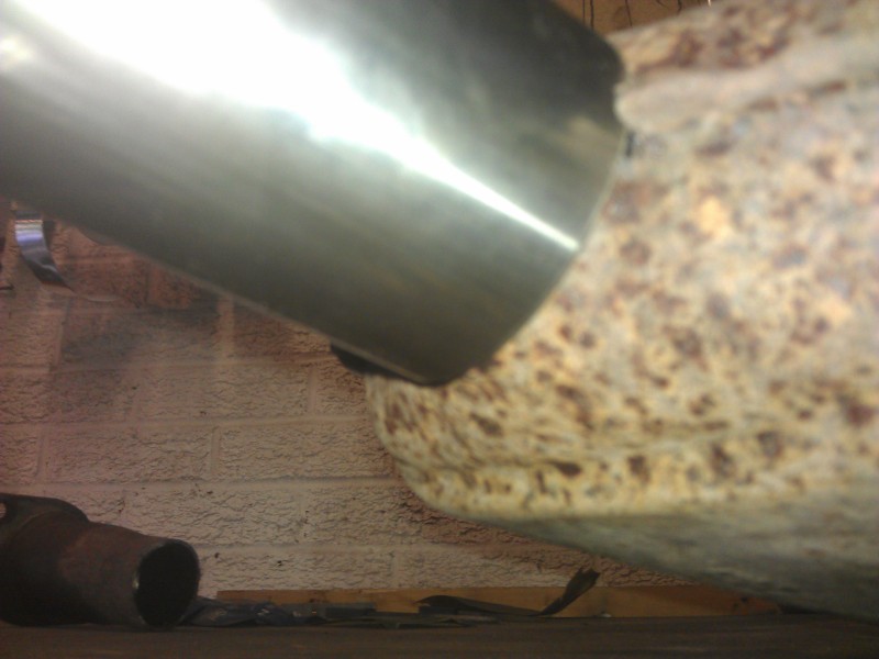

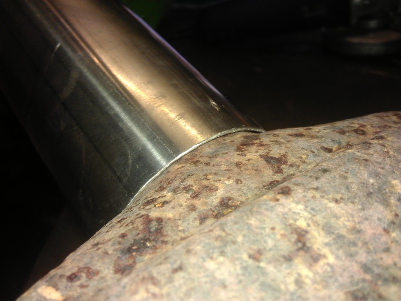

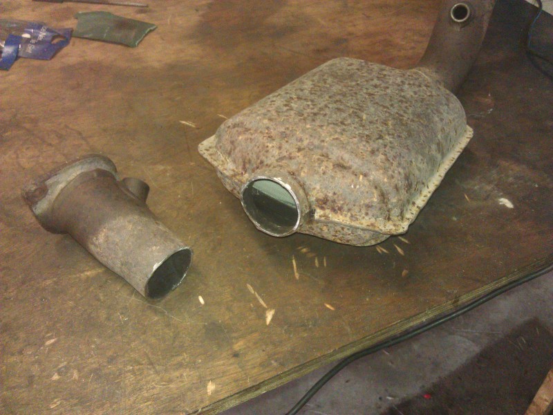

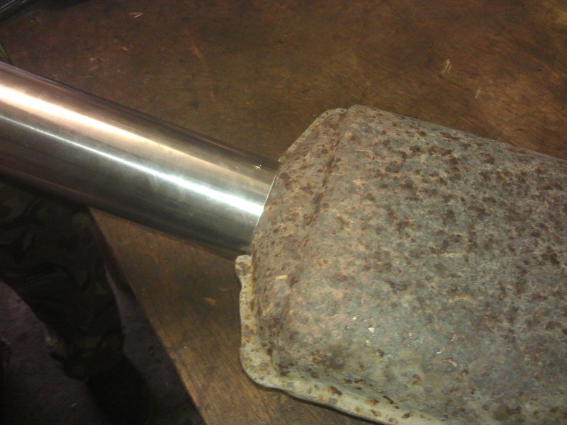

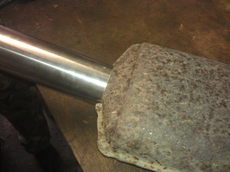

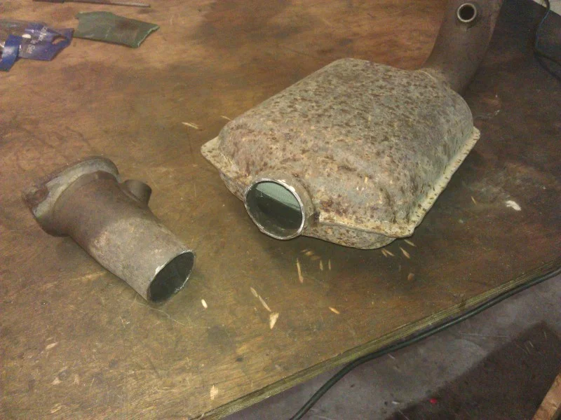

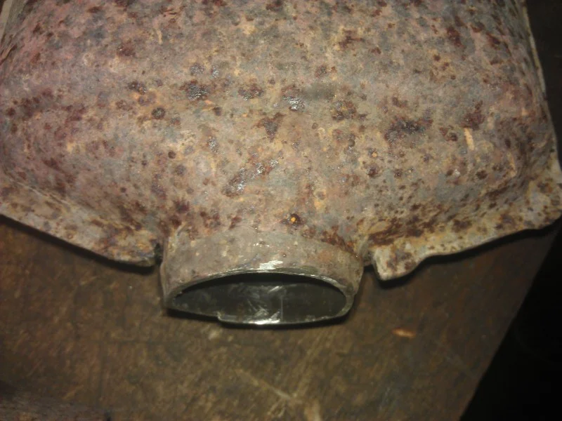

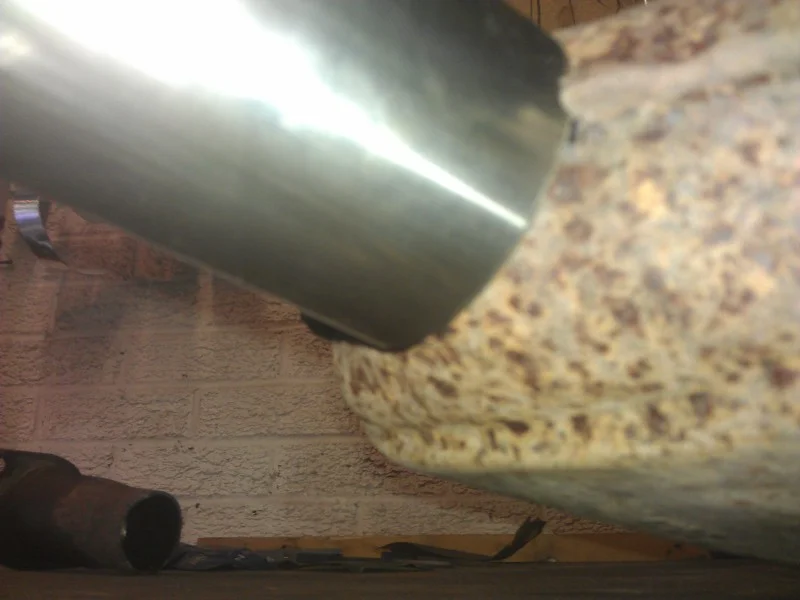

So I managed to get hold of a second hand cat and set about chopping last night. I cut the standard outlet off just before the weld and then put a couple of notches down each side to allow the bigger diameter pipe to sit flush. First impressions are good, looks a nice fit and will seal well. It's off with a friend for welding at the moment, I'll hopefully have it back for the weekend.
Cut off standard outlet
Notched the sides

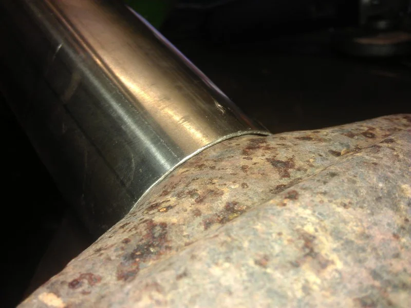

Mocked up the new pipe for fitment

Got the cat back today welded up. My friend had some trouble with the welding with the stainless pipe being thin (1.5mm) and the cat being mild steel, but it's on there now. If you are thinking about doing this I would suggest slightly thicker pipe or a mild steel pipe instead of stainless. Forgot to take any pics sorry.
