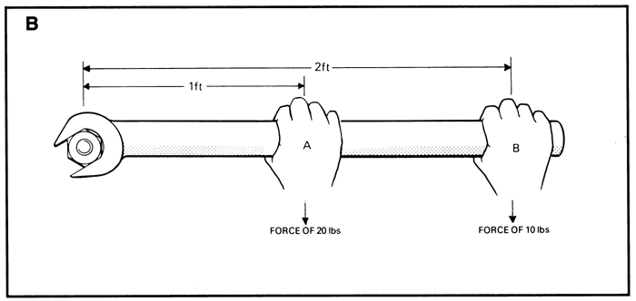

You need a longer wrench.

makesure you copper grease them when popping them back in to help prevent any seizing... breaker bar will work, or get your socket set on it and pop a pole over it to make it longer... if you have one

Aye, long breaker bar and lots of short sharp hits... creates vibrations that'll loosen them.
