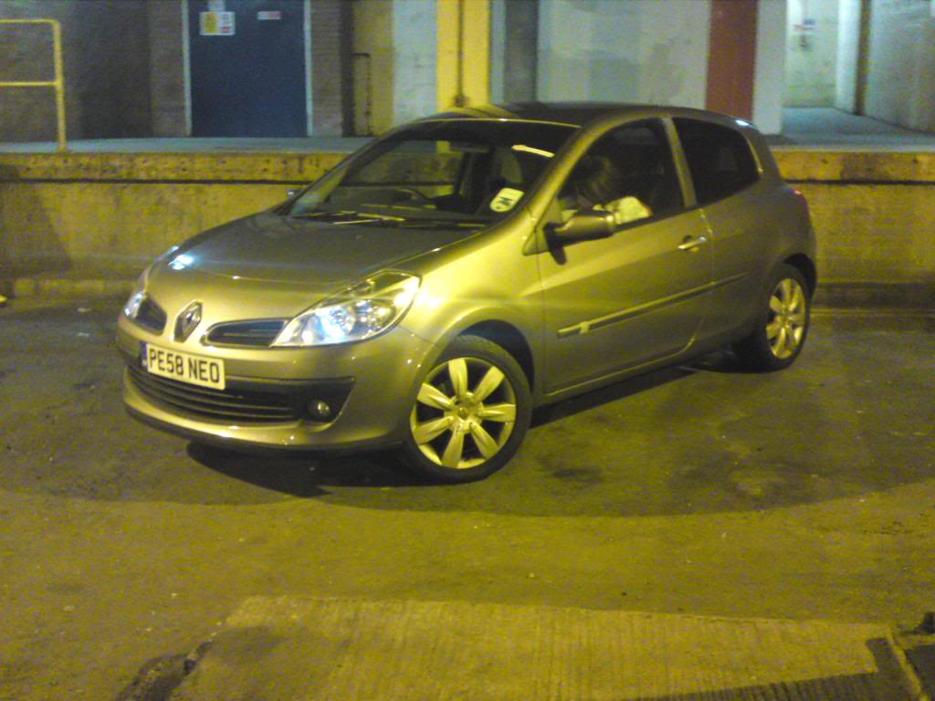

well ive done it (45mm lower)
Car  vauxhall corsa vxr

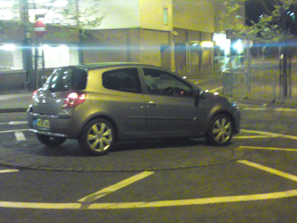

how she looked just a week ago

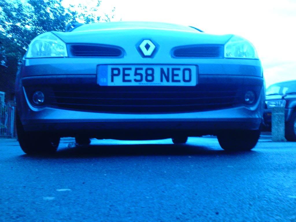

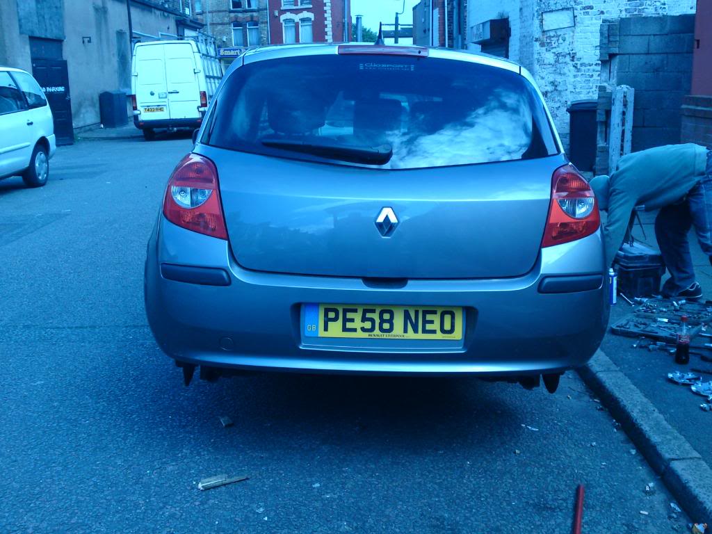

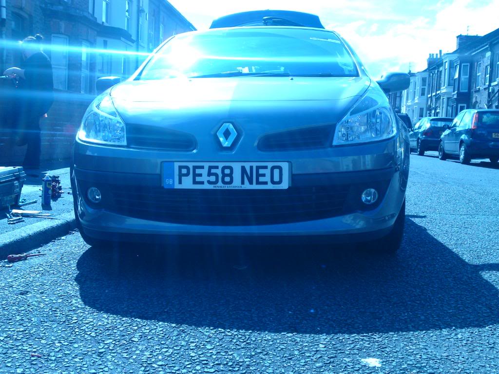

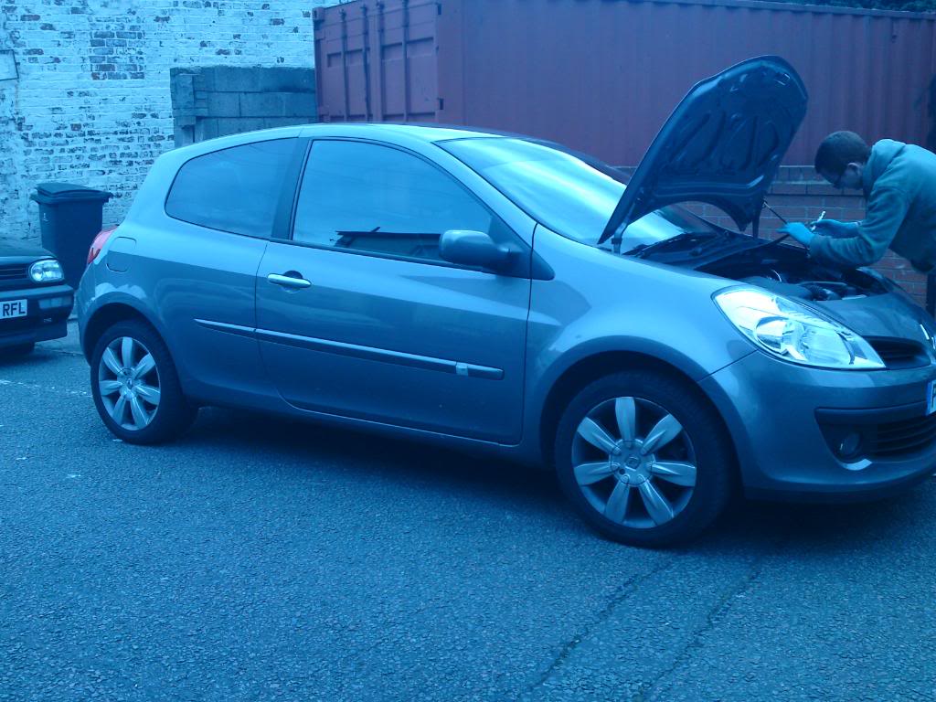

then my h&r 45mm springs arrived, had to go to renault to pick up a few things and was told hmmm have u lowered your car, i said no so they put a standard clio next to mine and there was a noticible diff, after seeing dave 138s clio on same springs i thought i can live with that, then the day arrived it was lashing down and the brightend up so we got to work

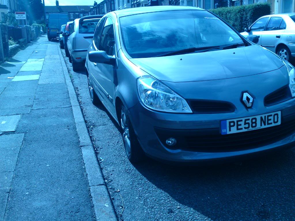

then it looked like this

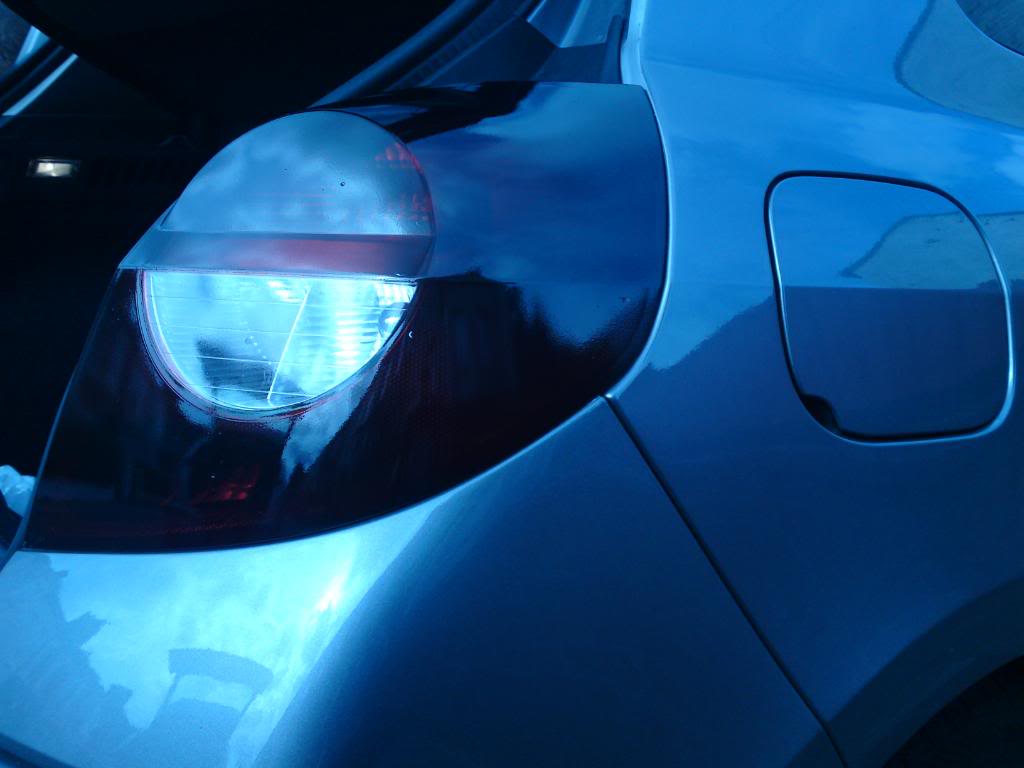

so while i was standing there doing nothing i thought i would have a ggo at this

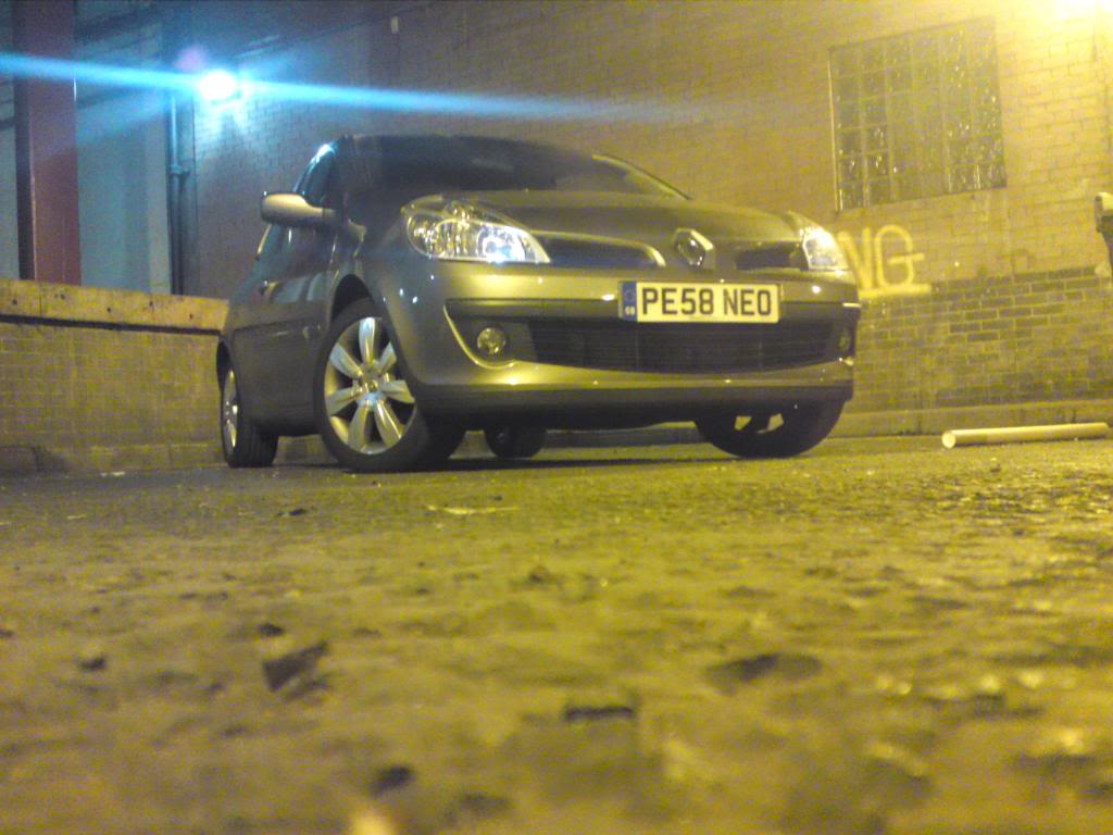

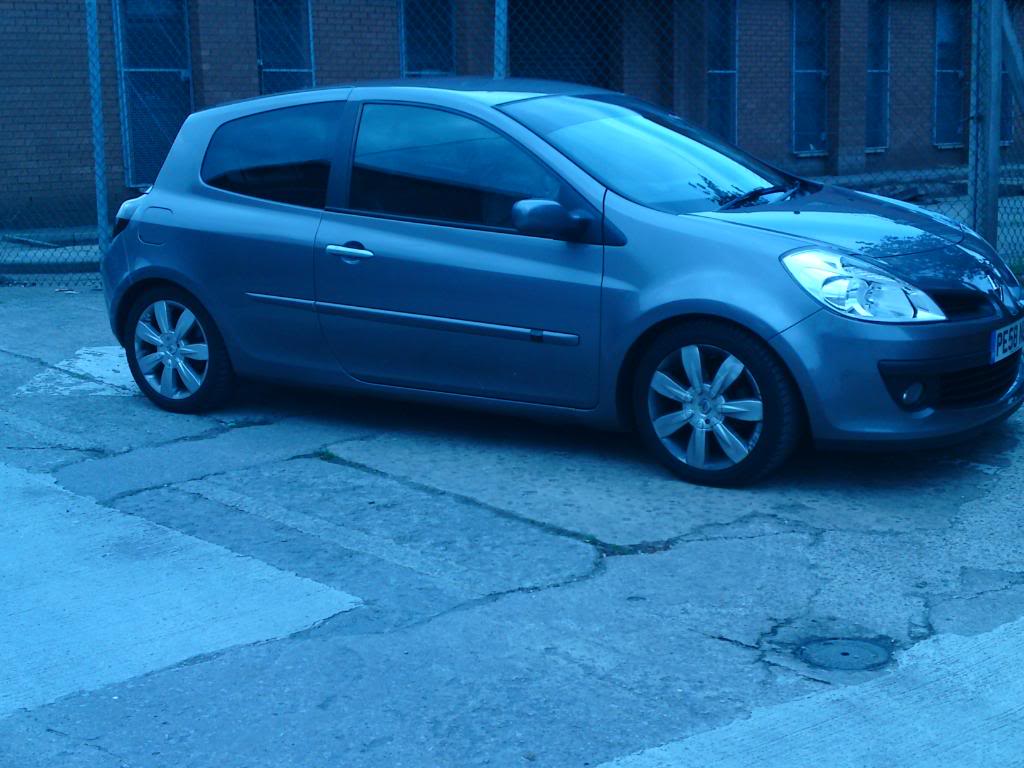

im still getting used to it, pulled up next to anther clio tonight and felt like i was sitting on the floor, gunna go to renault 2moz park next to another clio and get some photos, hope use like and thanks for everyones advise and help on this ;)
Like the lights and a nice drop.. Mk3s shoulda left the factory at least like that!

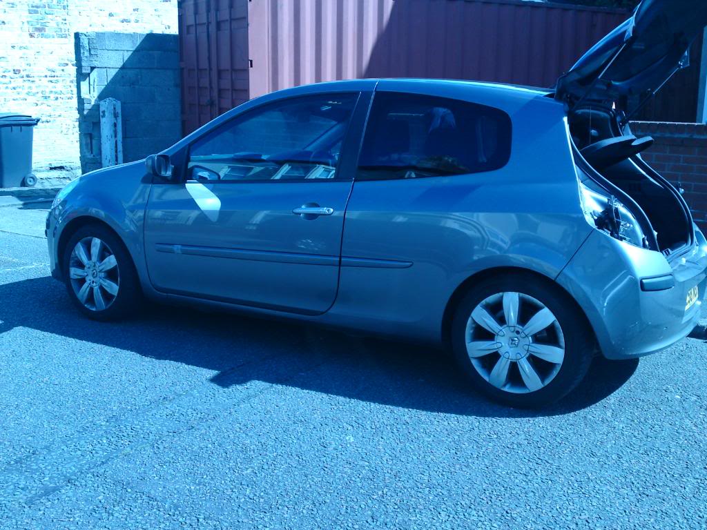

Need to get the rear bump stripes filled/colour coded!
cheers peeps next mod is my custom headlights, rs grills, for now colour code rear bump strips will be getting smooth'd off, front bump strips colour coded, anthracite the wheels and fingers crossed my dump valve will be here when im back off holiday, i wanna put spacers on aswell prob bout 10mm thou

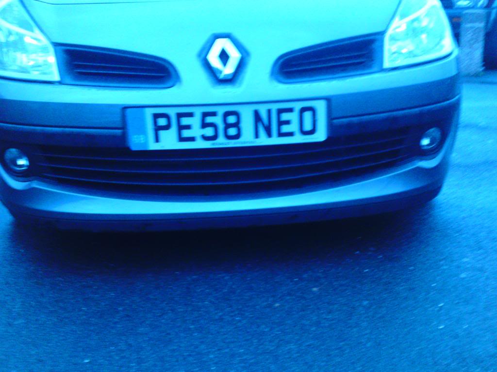

Lovely mate! Deff want to drop mine that low! how'd you do the lights? sport grill next on the list?
masked off the half moon really easy to do, stood around 40cm away from the lights done few light coats with ford panther black so they have a metalic flip in them, left to dry for half hour another few coats again another half hour to dry once happy applied a few coats of laquer leave to dry and the back on the car ( the black plastic around the edge of the light comes off really easy only few clips)
helps if you have somewere warm to put them to dry, in my case put the central heating on lol
its the camera mate i had the resolution set wrong im gutted gunna get some better pics 2moz now ive worked out how to use the camera
