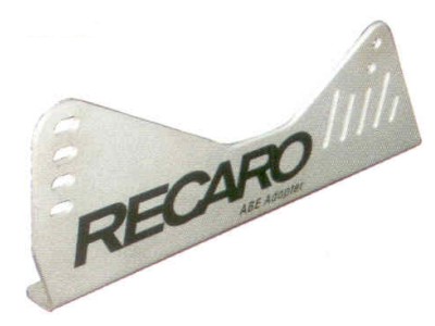

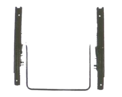

How are you going to mount them ? Sidemounted seats won't fit the car on sliding subframes unless you know something I don't (which is very possible).
  An orange one
the side mounts just bolt to the clio, recaro runners, these are not subframes as such...just sliders
  An orange one
the sidemounts bolt to the seat (obviously) lol
and the seat/sidemount then mounts onto this..
which will fit the existing clio holes as its a specific slider, and give sliding movement on the seat, there is also slight angle adjustment through the various mouting points on the sidemounts where you bolt the seat on.. see the pic..
the clio seat mounting holes are at different heights, you normally need a sub frame, runners and side mounts,
Here is a pic of my cobra sub frame which shows the height difference, other 2 holes are at the level it drops down to...

hmm...I will check this with capital seating before they send them out to me,
I may have cought him wrong or just been dumb lol, but he says will include everything i need :)
  An orange one
Ok here is a thought...the recaro runners maybe go onto the OEM clio frames??
the sidemounts then join onto the recaro runners??

my recaro runners used parts of the renault runners like you said, nice and neat ;)
  An orange one
im still waiting on these :(:(
still dont have a definititve solution of actually getting them in the car either
yozzasport said they will fabricate some subframes up for me, to suit my height etc...but the other option is to ditch the sliders completely and just bolt the subframes to the sidemounts..
