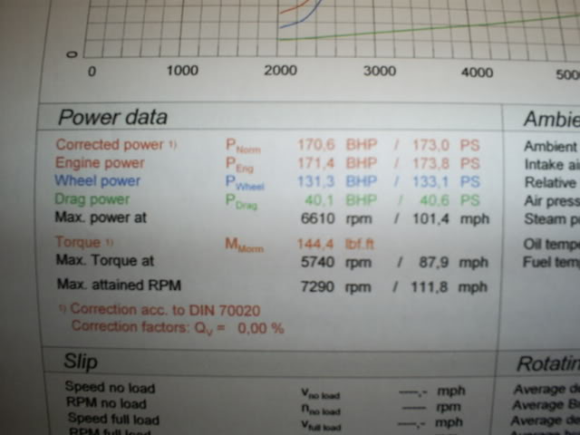

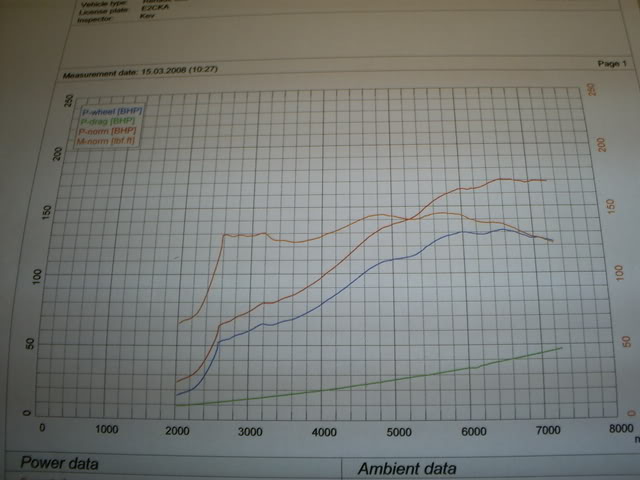

Well guys your not going to believe this but................ got my clio cup rolling roaded again at falkland performance
ran a dismal 129bhp before :( so thats when this thread started, after alot of discusssion i had the back box changed as it was clearly a restriction and the car decatted, checks were done on the engine and it all turned out A ok
so to my delight i ran 170.6 bhp today:)
who would have thought a dodgy exhaust system could affect a car this much:eek:
anyways chuffed to bits now , cheers for all the intrest in this topic:)
few pics of the much improved results
what a differance there is between the 2 graphs
and the figures
