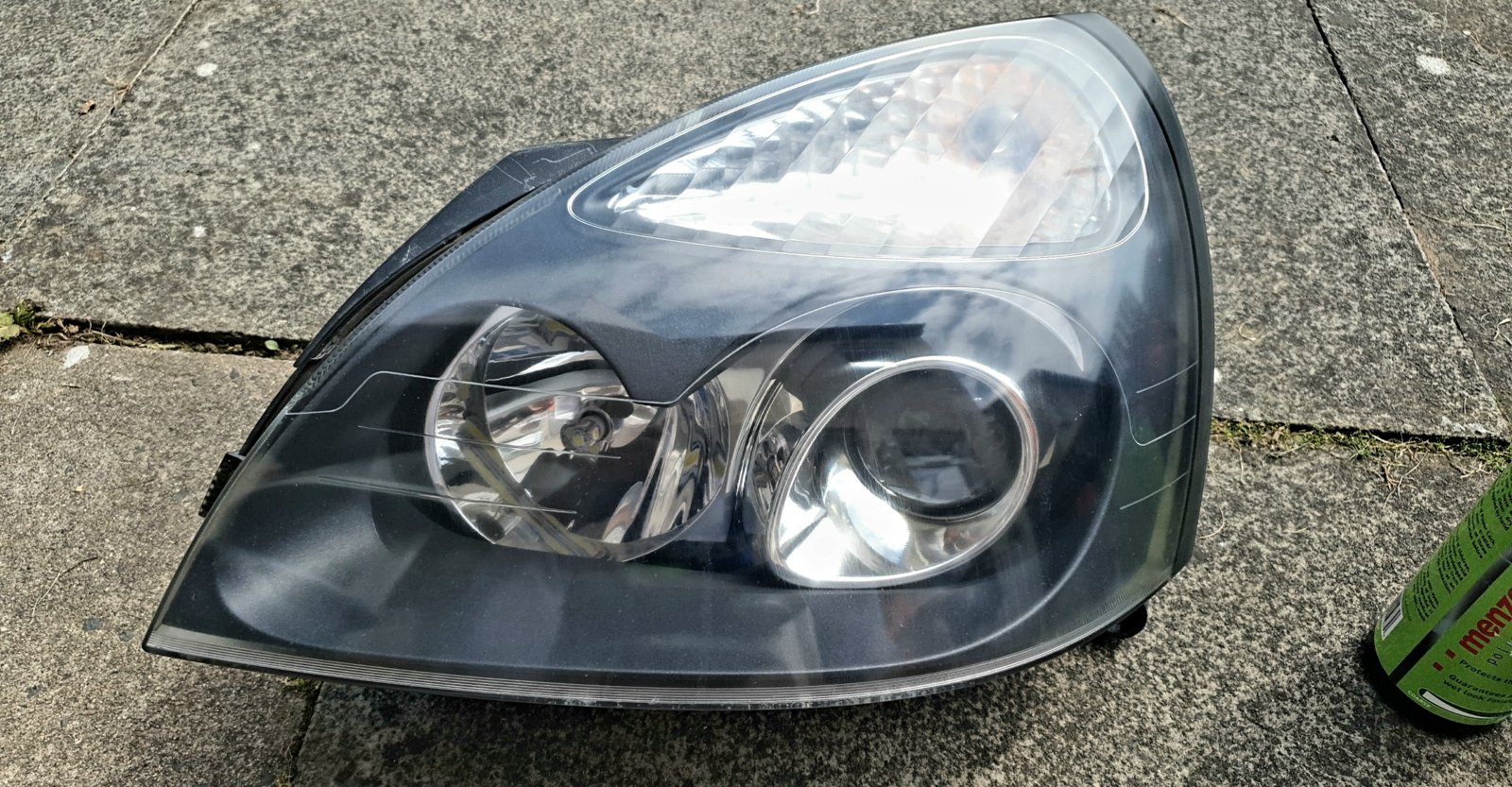

Spent a couple of hours doing the headlights, from 400 grit up 1500 then a compound on the DA and hand polish, unfortunately i forgot to take a before pic.
Anyway here's the result , good as new
Did you apply a sealant/UV protection? I believe the headlights came with a UV protection coating from the factory (as all poly carbonate headlights do) and unless protected will very quickly revert to the hazy condition they were in before

Dead easy, front bumper off (guide on here somewhere), remove 3× 10mm bolts holding the headlight in, one above and two at either lower corner. Then just two plugs to remove
Good stuff, I've done the headlights on my wife's car recently, now need to do them on the clio as well. Clear headlights really makes most cars look a lot younger.
