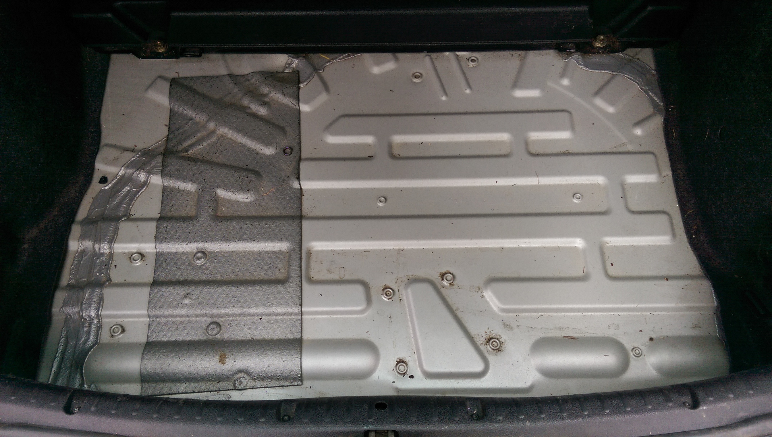

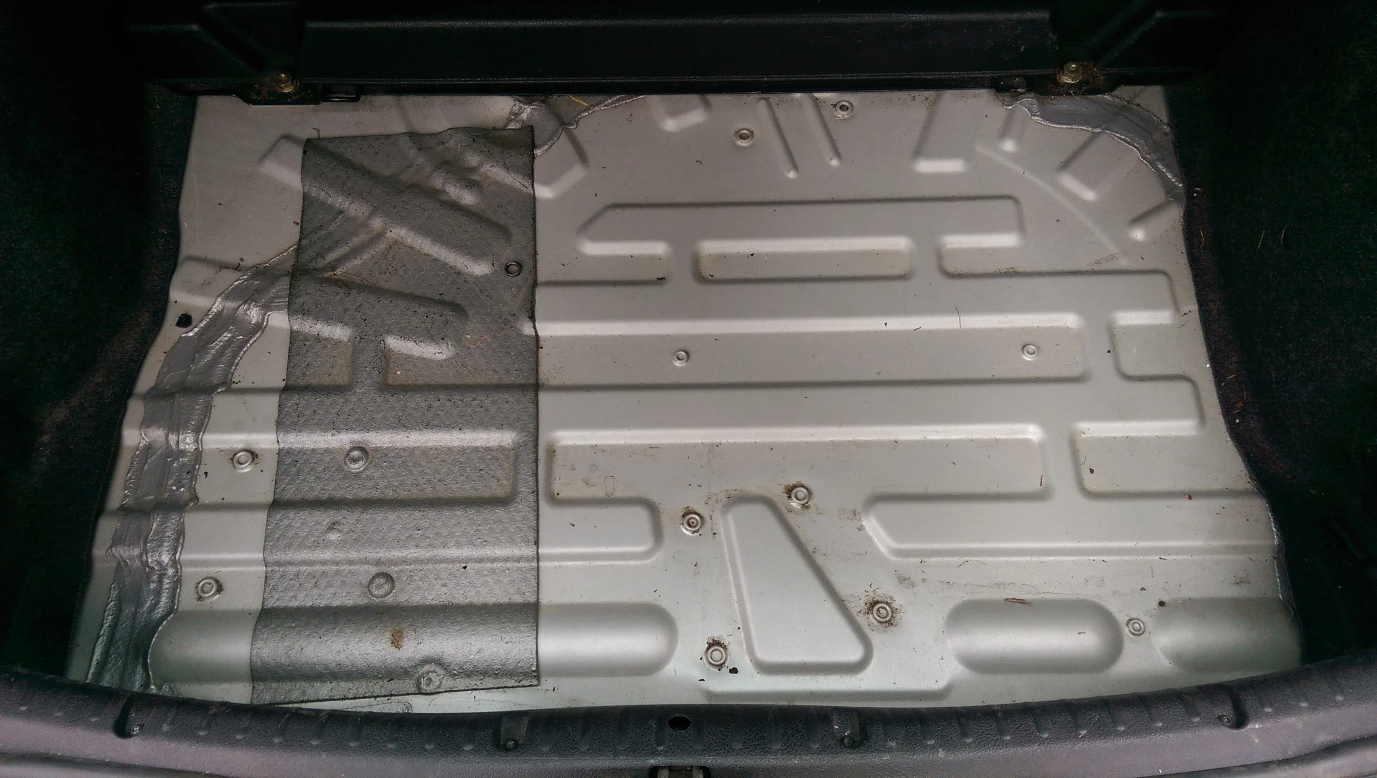

I'm not sure this applies to the 18. I have attached a picture of the boot floor and I can see no black grommits.
