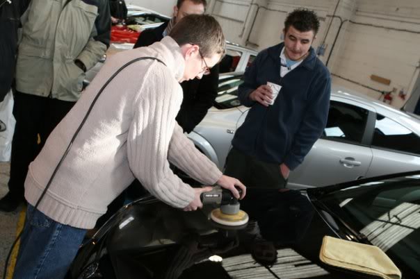

This is also a point I forgot, do you have a machine polisher?
a what.....? lol no I don't mate. can this not be achieved by hand polishing or waste of time?
i.e.:
Correcting wet sanding by hand would be bloody hard, And i wouldn't attempt it, I went blind into wet sanding, Only used very soft paper, i.e. 2500 and 3000.
Had some very good results but had a rotary polisher and all the right polish.
Definatly do more reading to get an idea of how to use the equipment and practice on scrap panels if you can.
You can.
